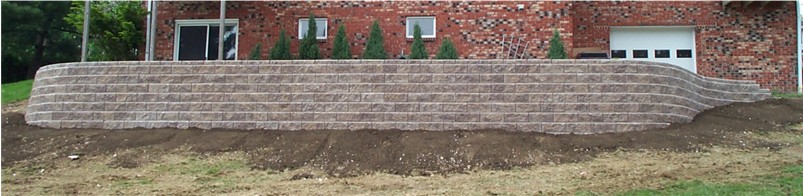

I know of at least 3 commercial properties in my area that have used the Alan Block for retaining walls. Western PA is very hilly and there are many applications for retaining walls.
There is a Kohl's department store not far from me that has a 60 foot high wall about 400-500 foot long. I believe they used the Versa-Lock product. About six months ago a large section of the wall collapsed. Since you plan to sell the property for commercial use I think you should have an engineer design the wall and specify the material to use. My wife works for a surveying and engineering company and they frequently are asked to testify in court cases where retaining walls have collapsed on commercial property. Usually the court rules that the wall was installed improperly and the construction company has to eat the cost of re-installing the wall.
