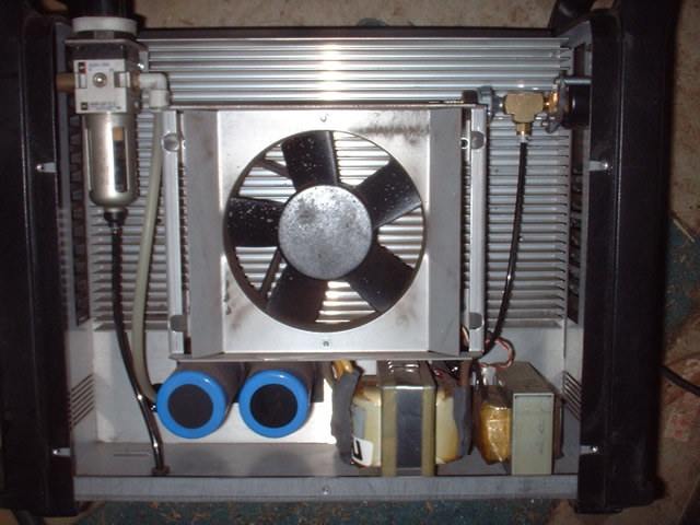

Here's the other side of the Hypertherm, showing the large heat sink, cooling fan. On the upper left is the air inlet with regulator and filter. On the upper right is the pressure sensor and pressure gauge connections. At the bottom are a couple of power capacitors, and a couple transformers.

By the way, the board mounted transformer on the right side of the board in the "outputs" view may look a little burned, but that is actually just some varnish on the wrapping. Hard to tell from the picture, but it looks and smells fine.

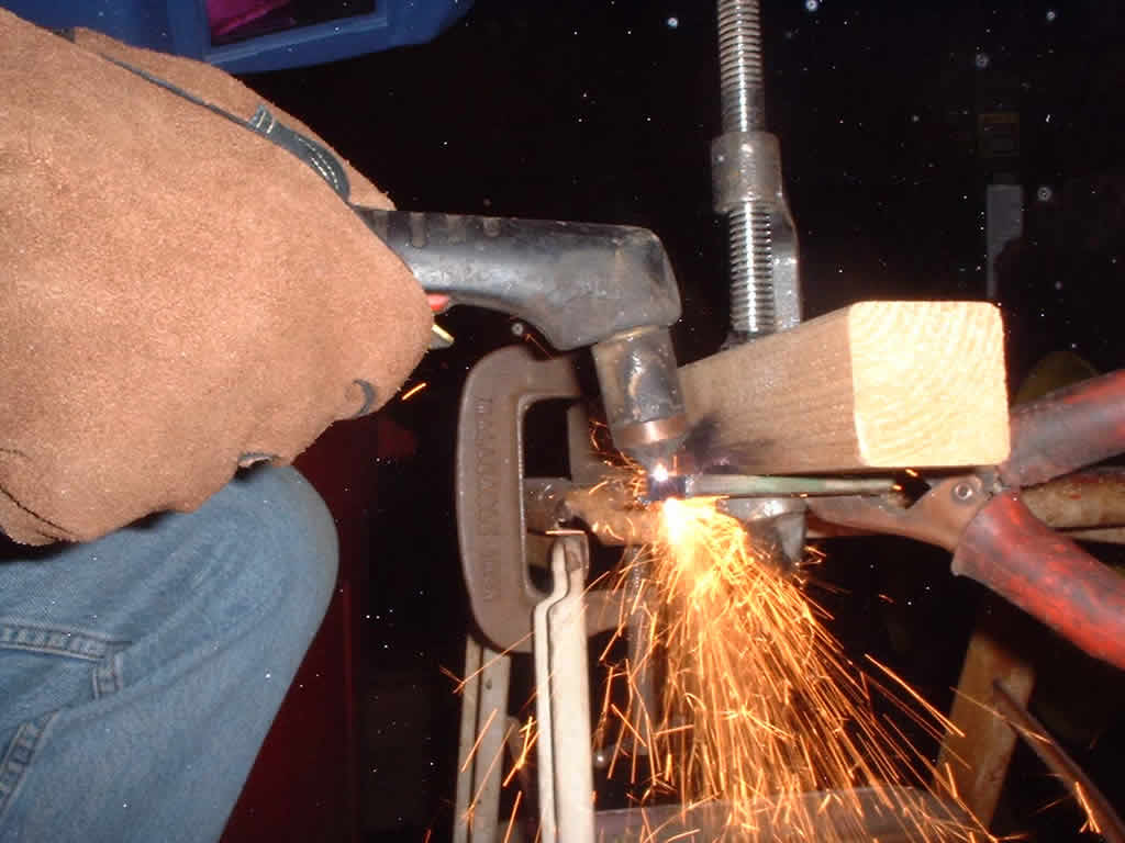

Success! (more details shortly)
Picture with the self timer of my second cut!
Running 20amps cutting 1/4" plate.
