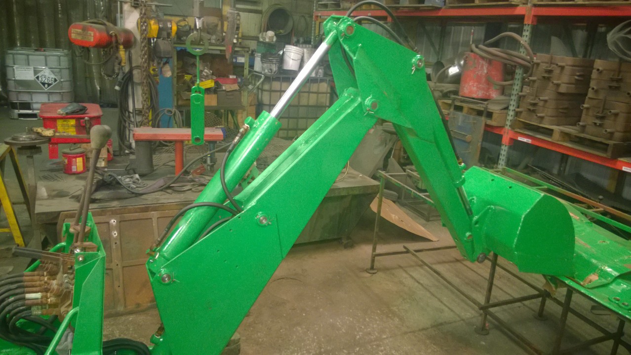

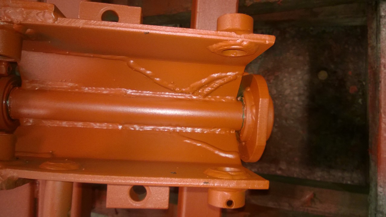

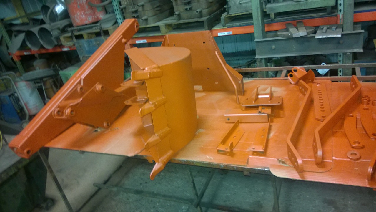

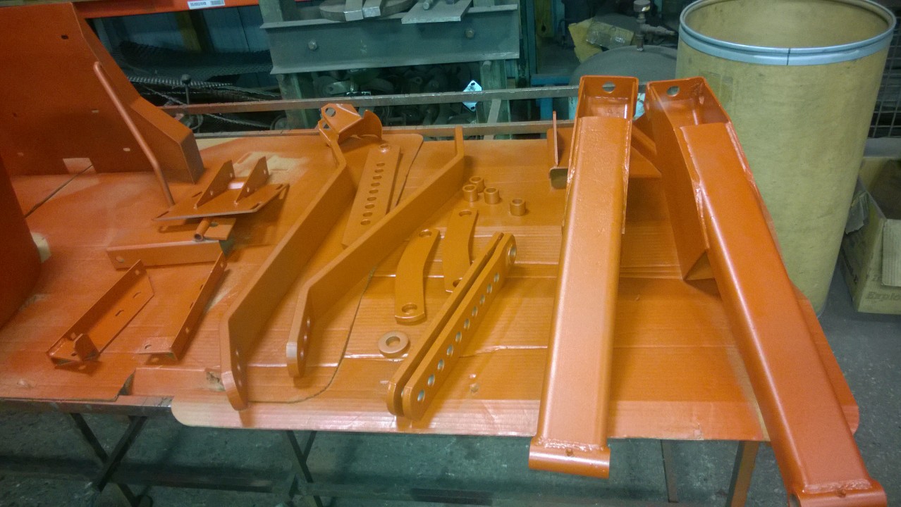

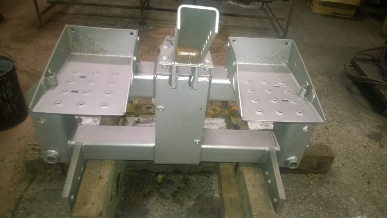

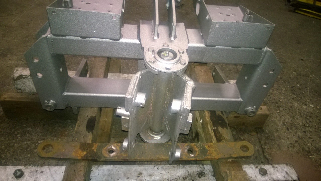

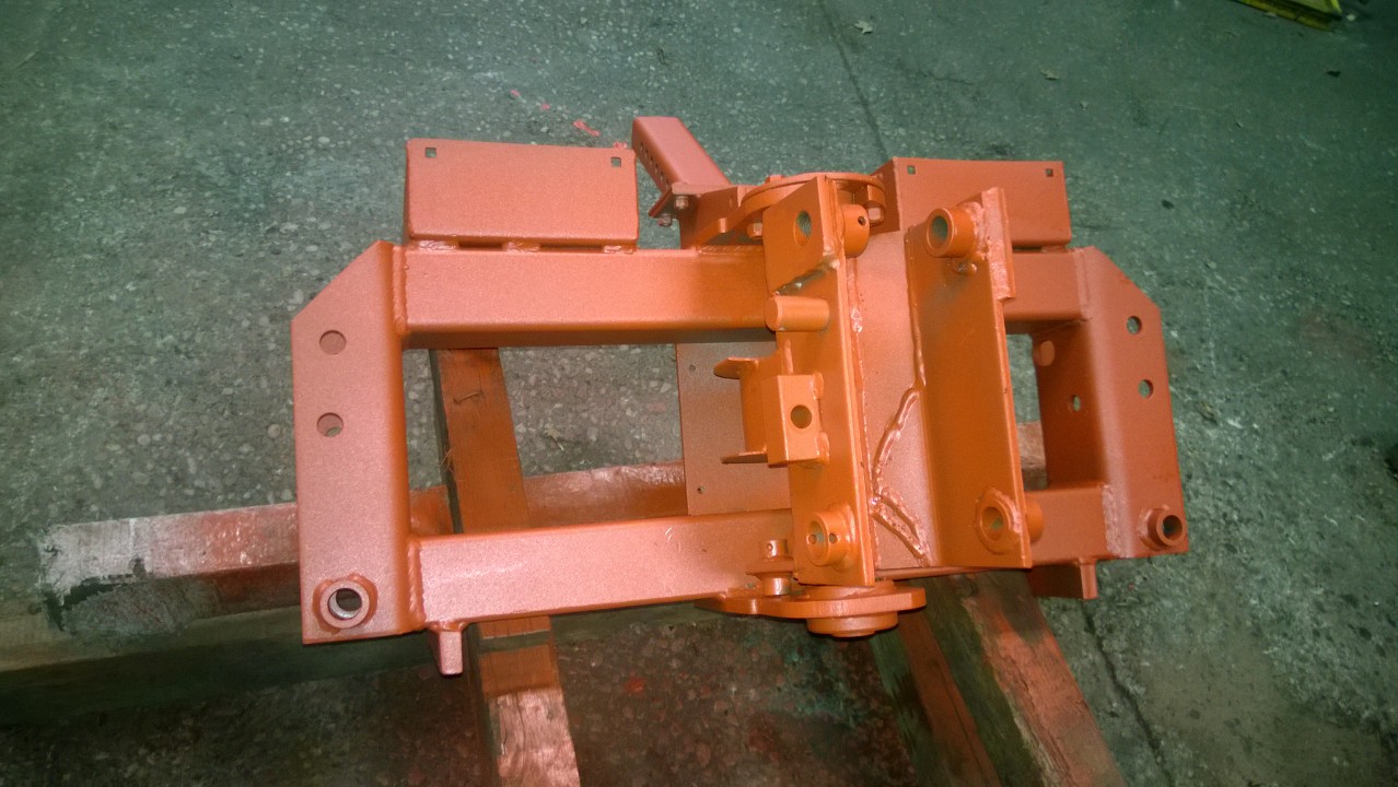

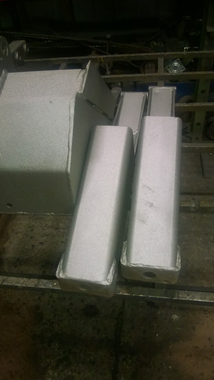

picked up a used BH750 from a local dealer last month. Before I started using it I though I'd pull it apart, blast it check it for cracks, repaint and assemble. It was operating when I received it, but it did look as though it had sat around awhile. Here are some pictures after blasting. WP_20141206_001.jpgWP_20141206_002.jpgWP_20141206_003.jpgWP_20141206_004.jpgWP_20141206_005.jpg

Looks good! Now hurry and prime it before it rusts.

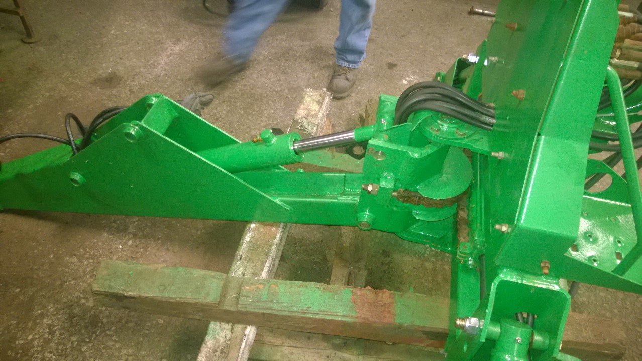

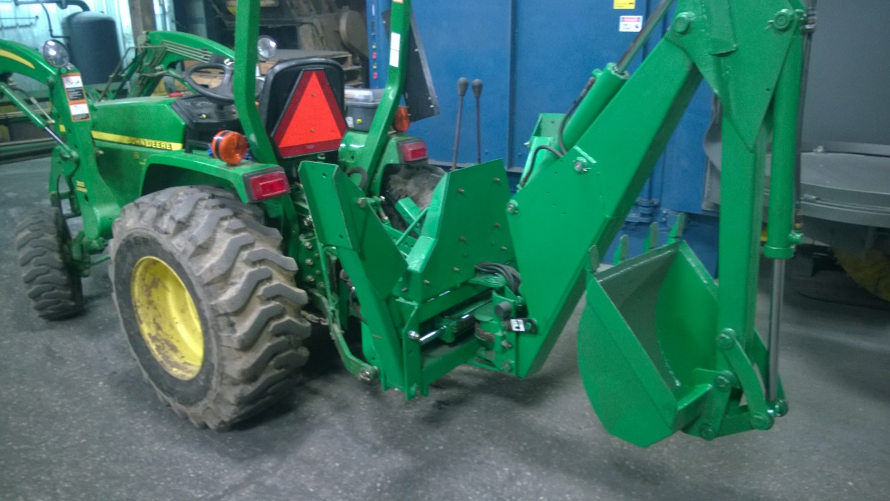

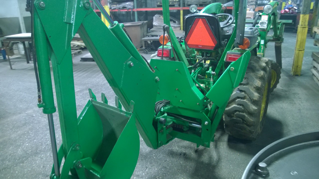

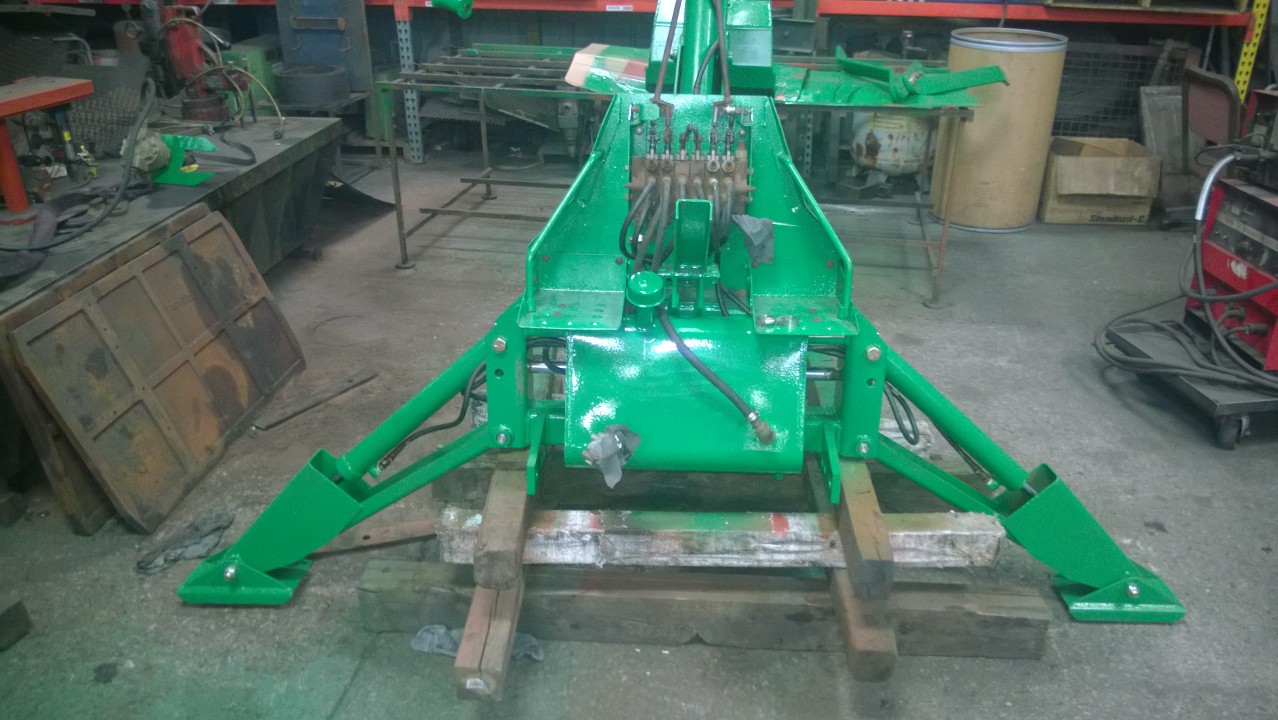

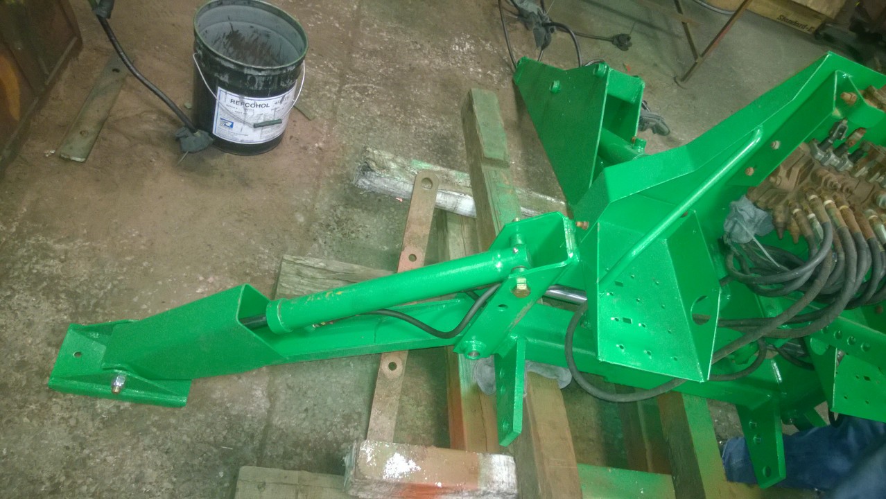

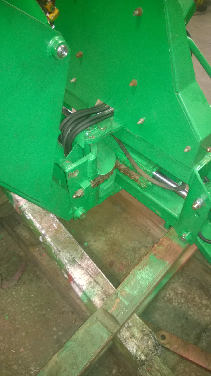

Primed it with Sherwin Williams shop coat lacquer primer then a couple coats of an oil based green. Machined all new pivot pins and put on a couple of new bumpers. Woods was really helpful by sending a pdf of the owners manual. Helped with the reassembly immensely. Put it on the tractor yesterday and got it all adjusted. WP_20141209_005.jpgWP_20150413_006.jpgWP_20150107_004.jpgWP_20150107_003.jpgWP_20150107_002.jpgWP_20150105_003.jpgWP_20150105_002.jpgWP_20141209_008.jpgWP_20141209_007.jpgWP_20141209_006.jpgWP_20150413_007.jpg
ran it a bit today, it will take some practice.

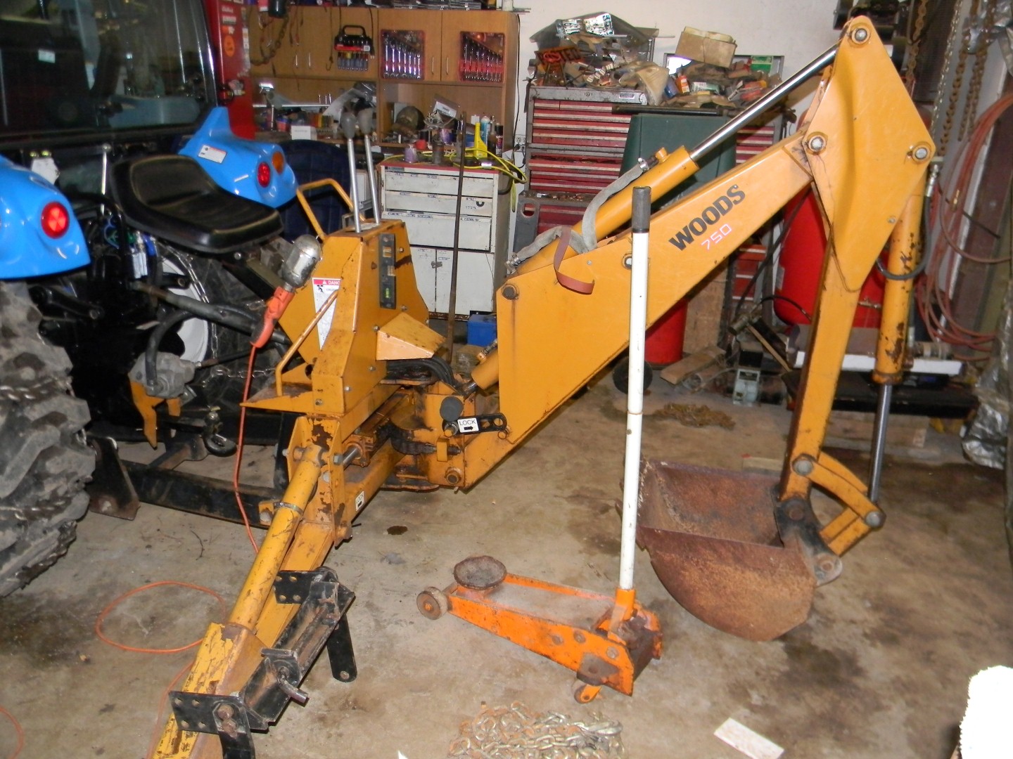

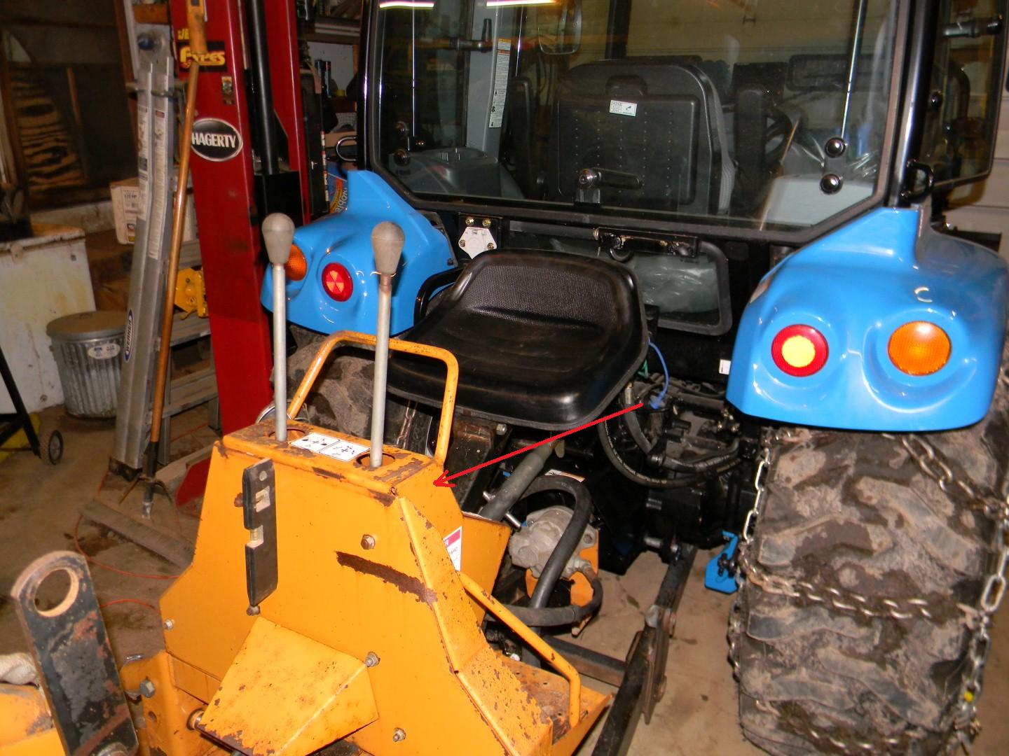

I didn't notice the joystick cover in any of your pics. (See arrow in my 3rd pic)
Was it missing when you bought yours?

Yes the control cover is missing. I didn't know that there were rubber pads on the stabilizer feet as there wasn't any evidence of anything being there upon purchase. I probably won't put anything on them for now.

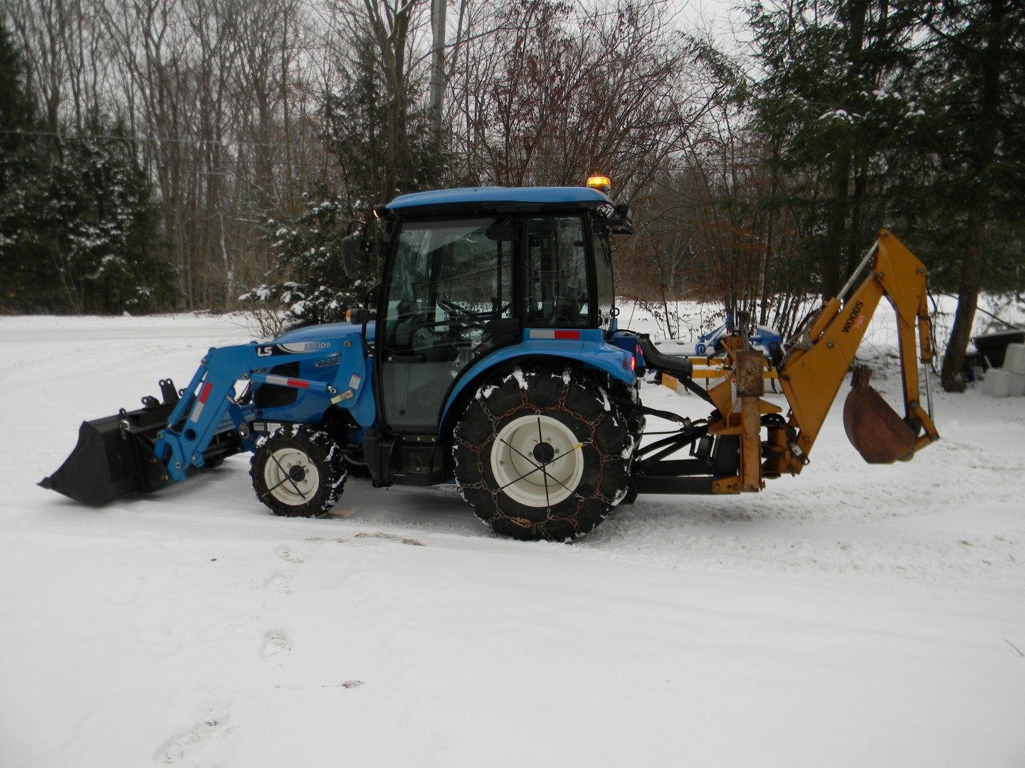

I've decided to sell this back hoe and get a little larger one designed to fit my Mahindra. Located 49067 for anyone that wants to look at it.
