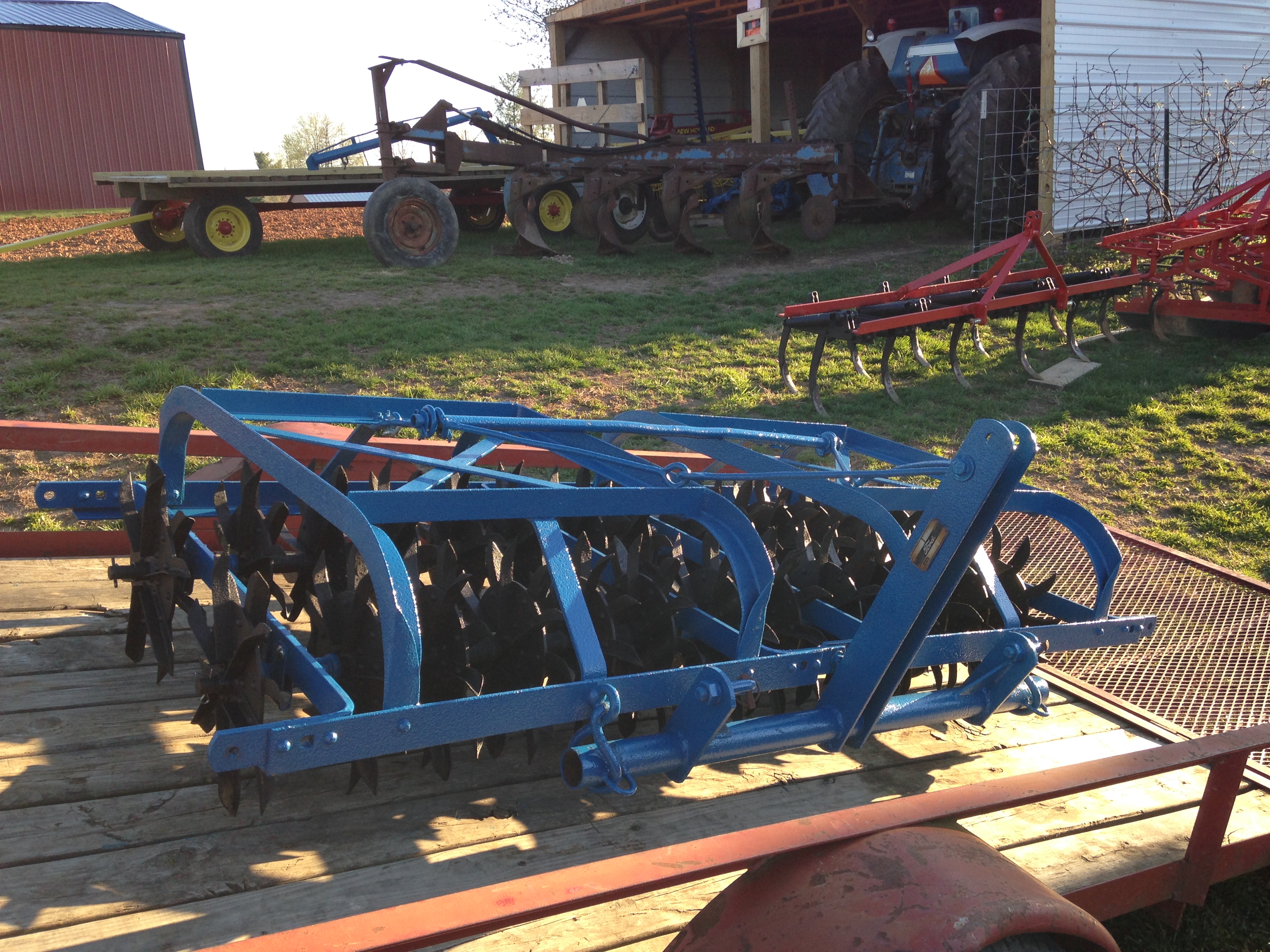

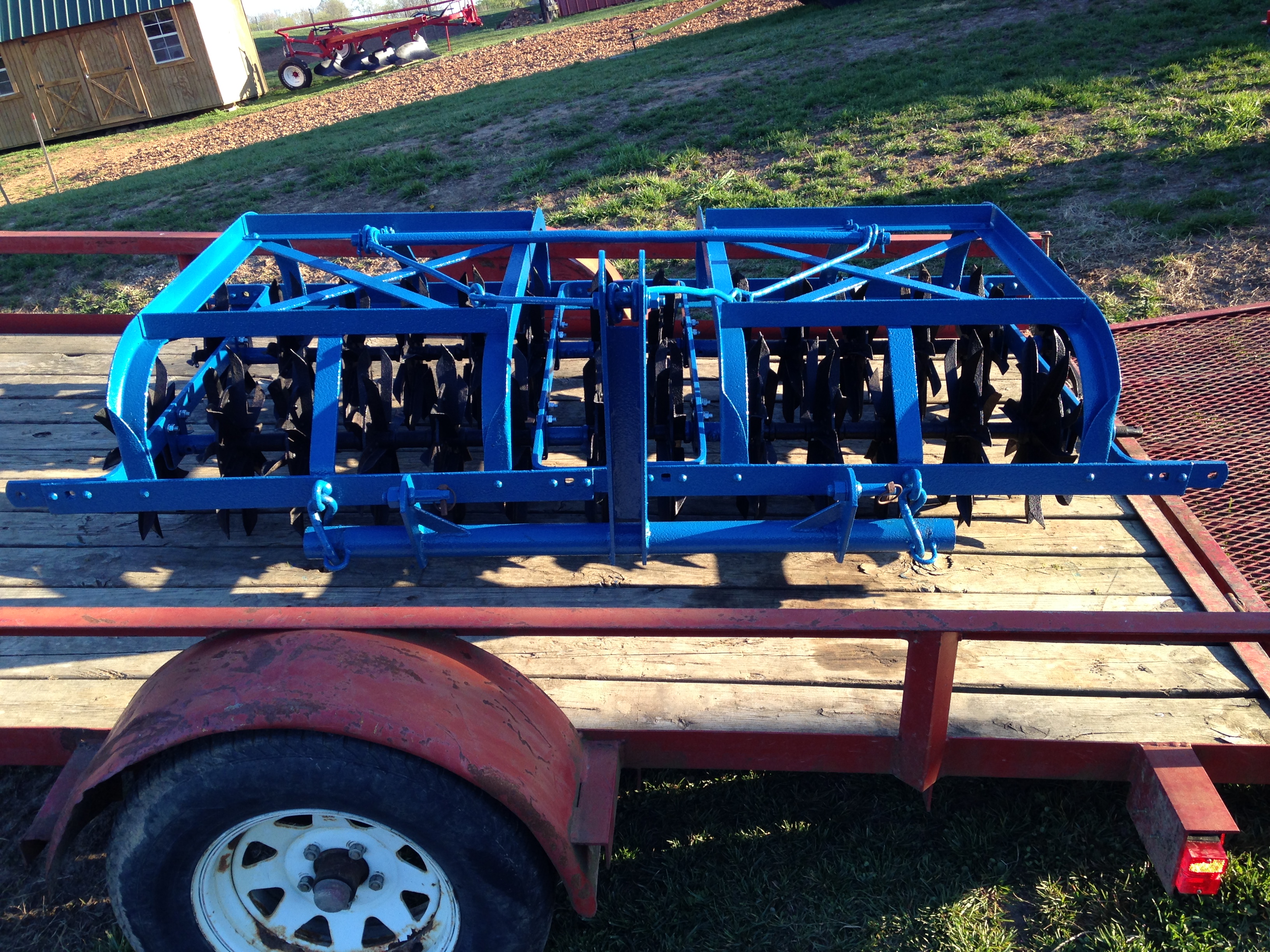

I found a few items at a local farm equipment salvage yard but, there was a few items for sale on eBay last i checked. Estate auctions seem to be the best place to find part planter's. For the disc I know Agni-supply has the axle's and blades for the but, haven't found much else for the Disc other then part's ones for sale on Craigslist.

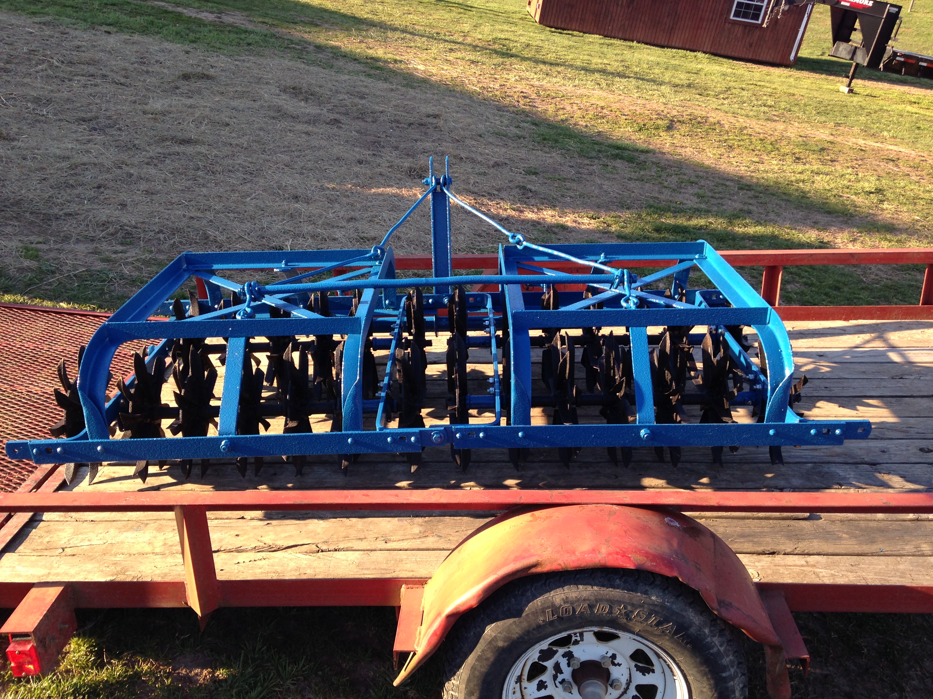

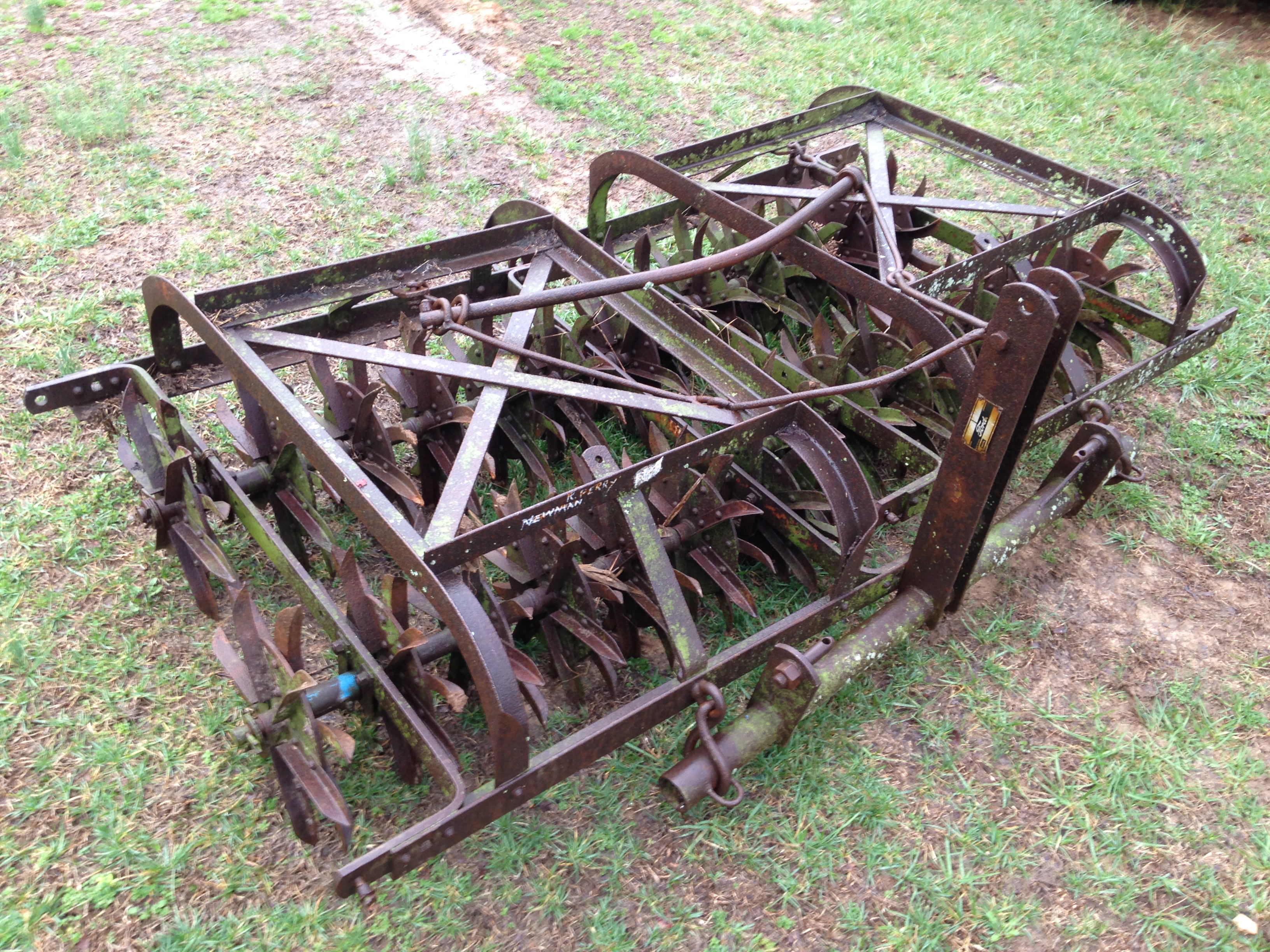

Also i finished my Ford 407-1 Rotary Hoe today still gotta buy one wheel, turn other hitch pin around and buy decals but, other then that it was a lot more work then i anticipated. Got all but one bearing loose i feared breaking the cast housing so i just left it and made sure the axel itself turned freely.
Before:
After:

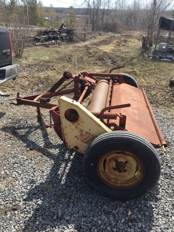

I picked up a New Holland 404 hay crusher today off of Craigslist. It's in real good shape for a piece of equipment more than likely pre 70's. So once the weather breaks, I will get busy. You guys have inspired me.

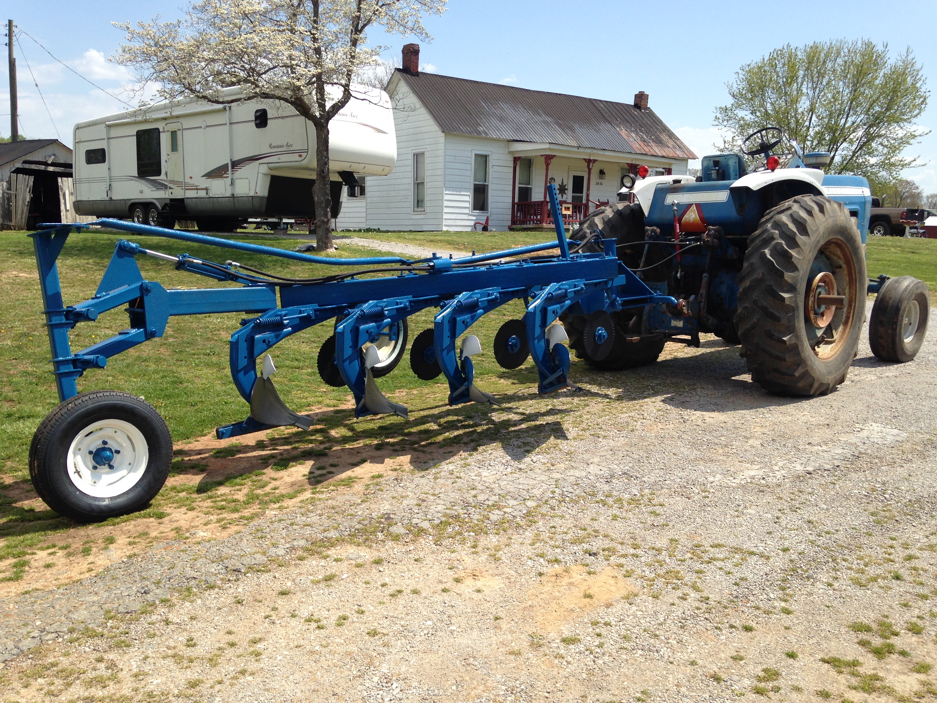

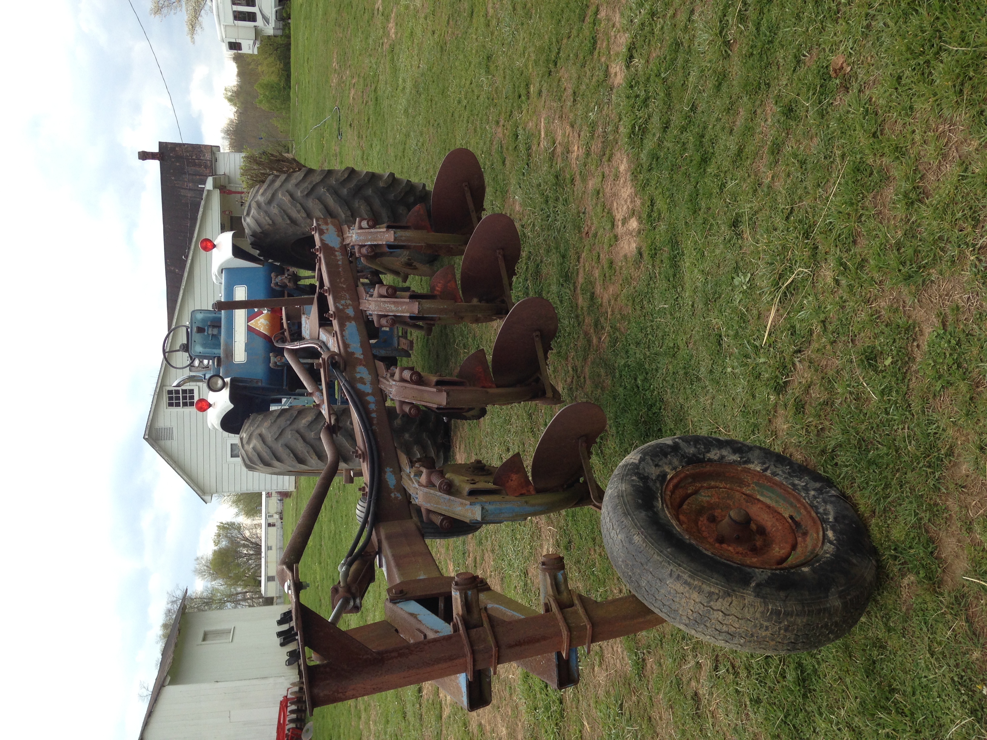

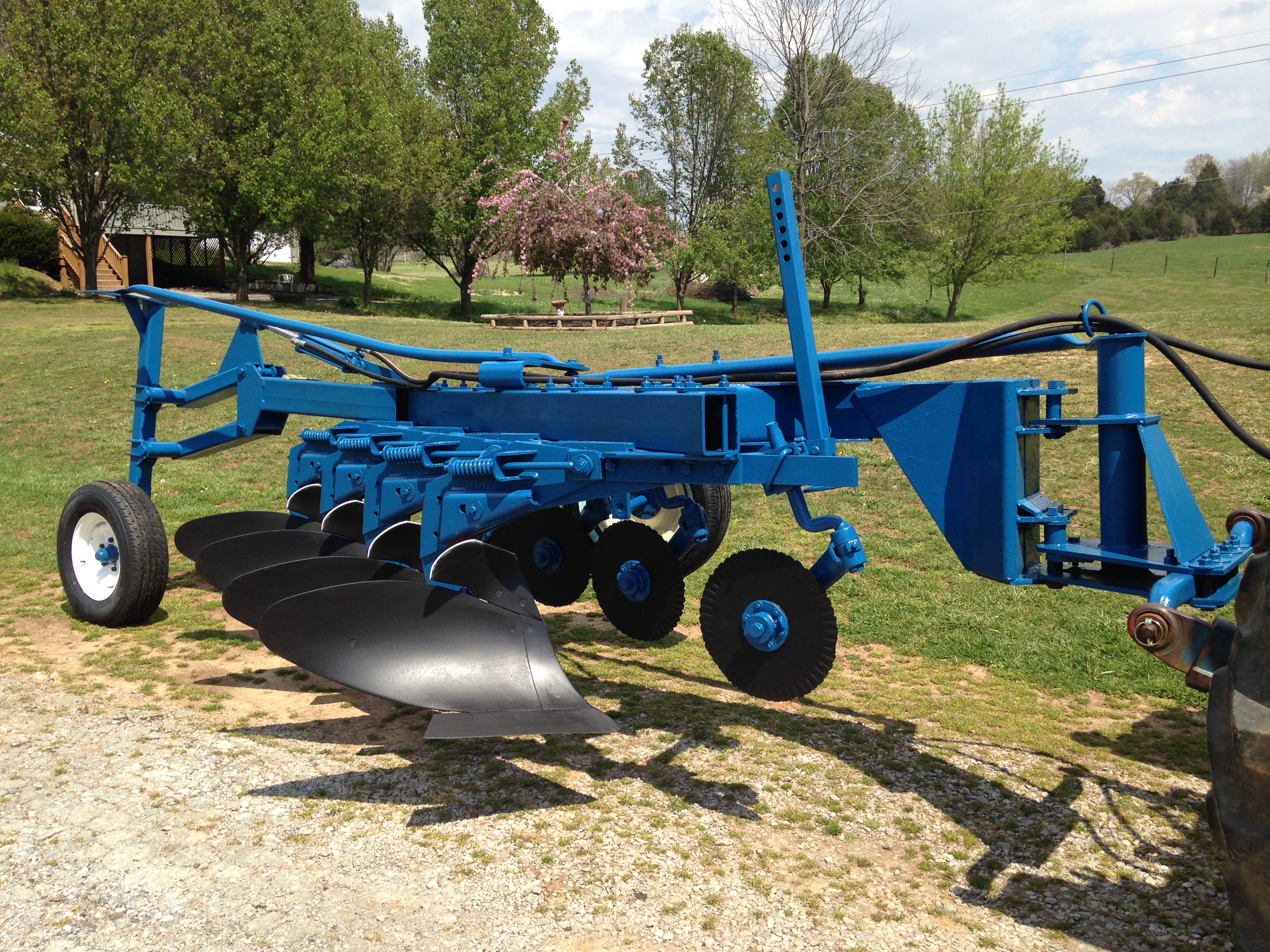

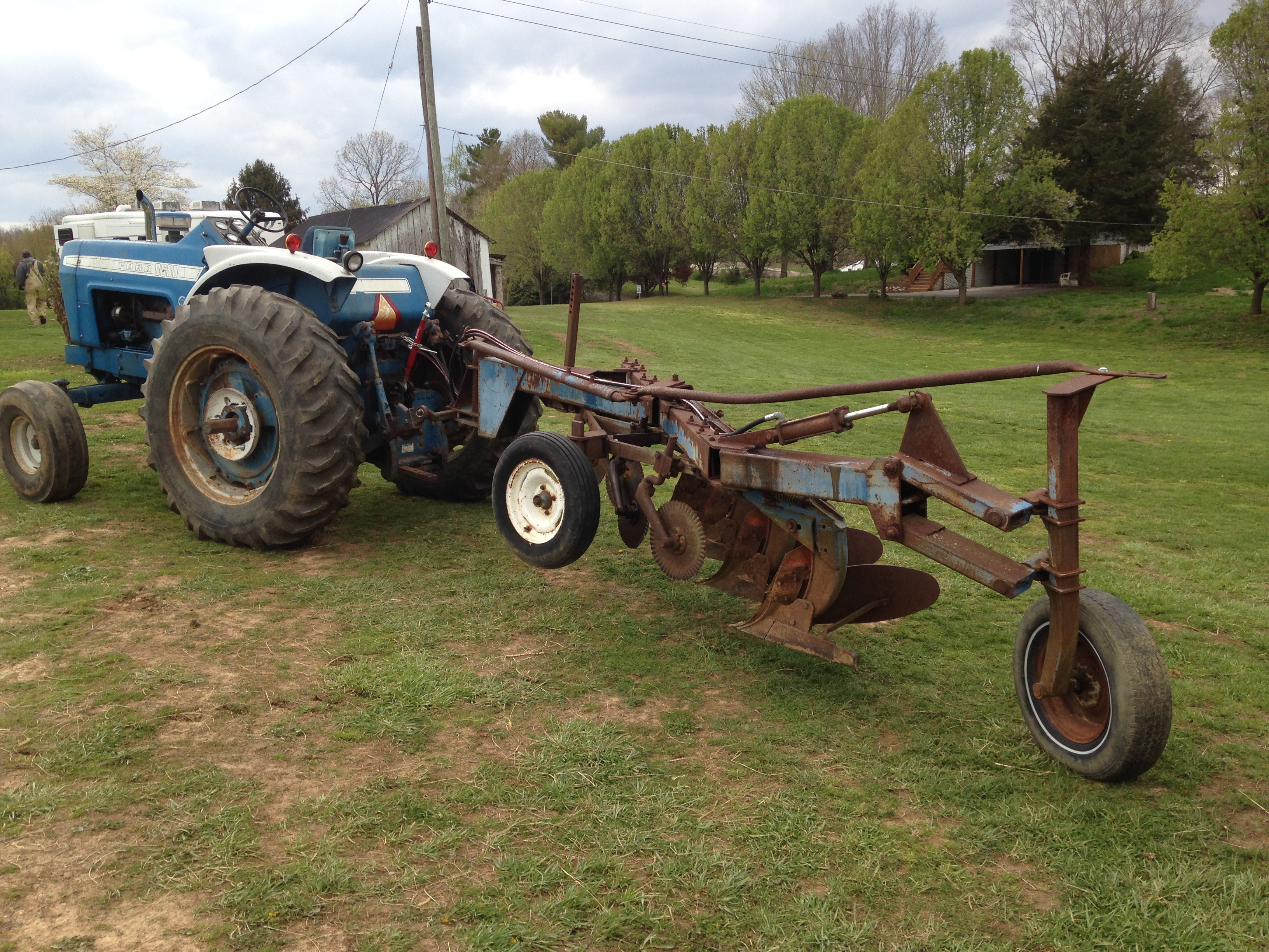

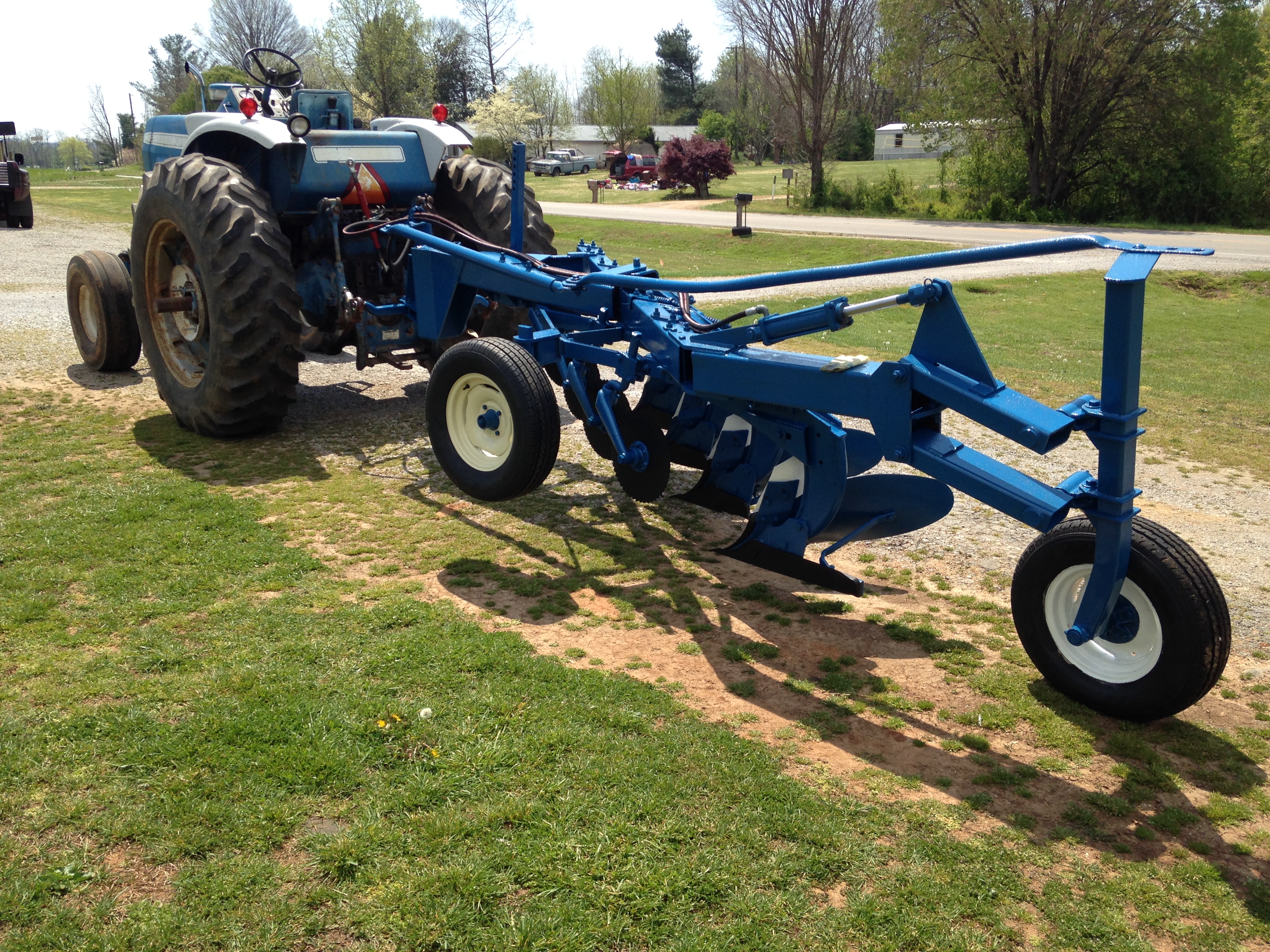

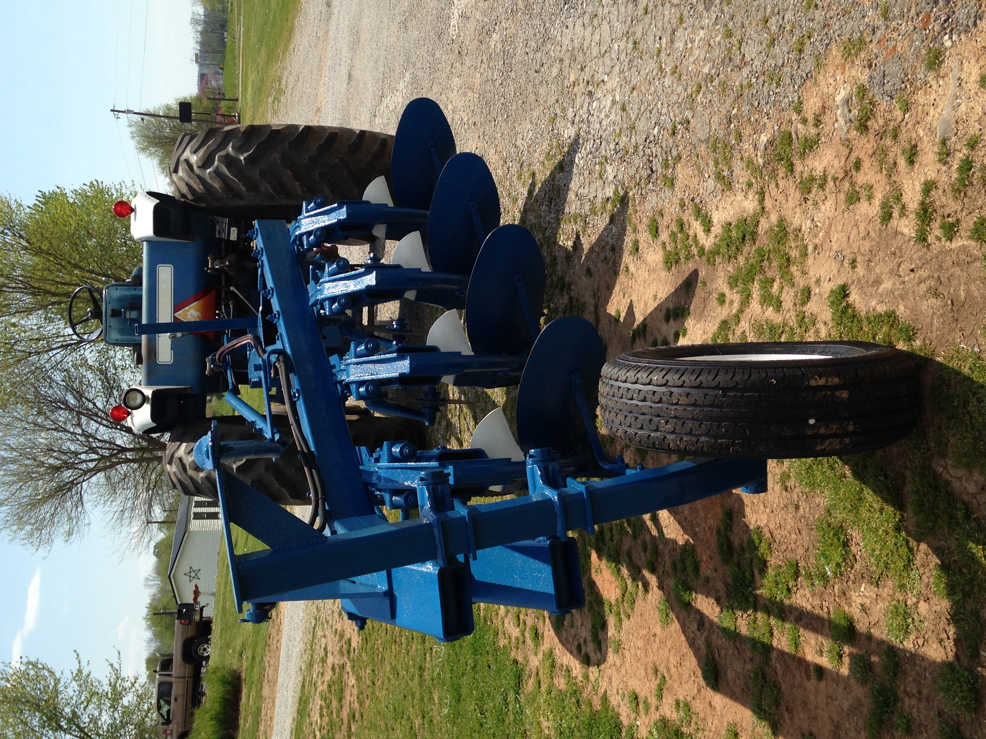

Thanks to some great weather i got my Ford 142 16" 4 btm plow nearly finished. I bought new hydraulic hoses, New rims, new tires, and got it all painted. Now just gotta go grab some Decal's on payday lol
Before:
After:
   / Restoring old Implements back To there former glory #39
Greenrivercummins--Looks good. I have never seen that version of Ford plow. What a tail wheel!
