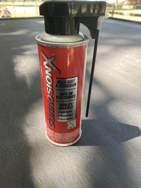

   / Restoring antique plow - need to remove rusted nuts/bolts - how much heat? #58
   / Restoring antique plow - need to remove rusted nuts/bolts - how much heat? #59
As my good buddy that past use to say this is some good S**t! It really is some of the best stuff I ever have used. I always have a can handy.
If this does not work, hammer and chisel.
I have used Corrosion X, as well as all the others.
Kano Kroil is truly the BEST!
Transmission fluid mixed 50/50 with acetone is almost equal to Kroil.
