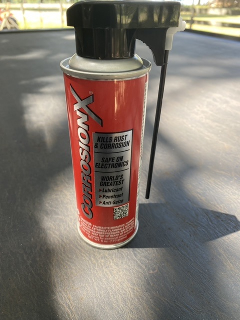

As my good buddy that past use to say this is some good S**t! It really is some of the best stuff I ever have used. I always have a can handy.
If this does not work, hammer and chisel.
