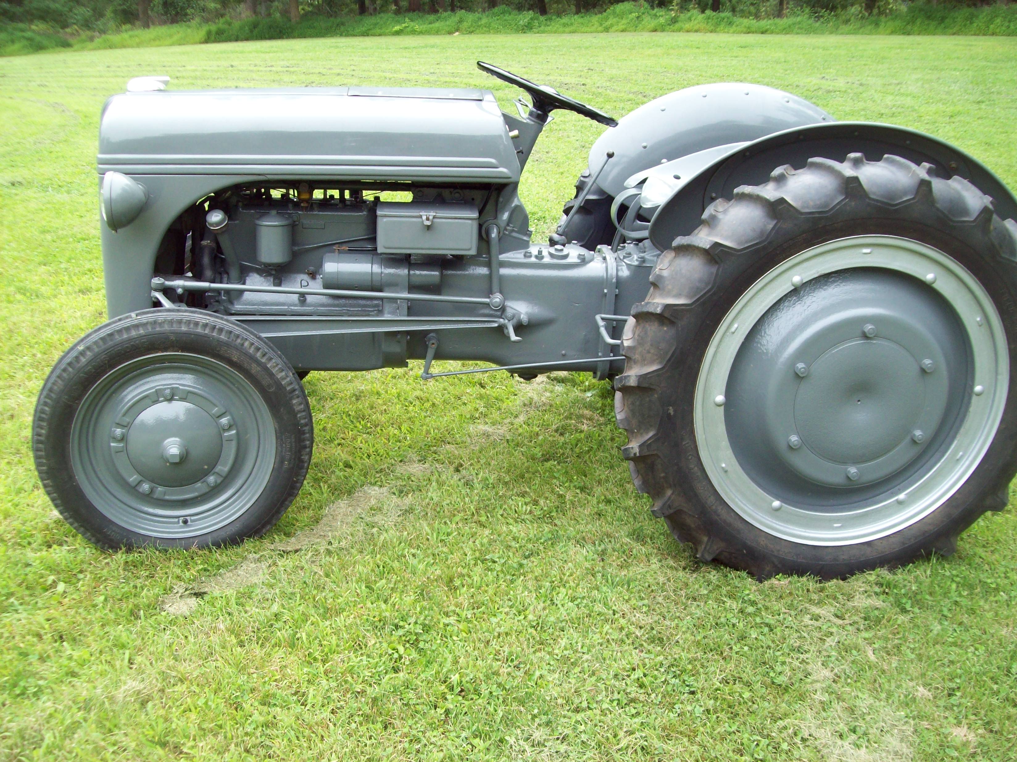

Many people think they have a '39 but most have a later model. there was a lot of changes made that first year. Best to check the serial number on the flat shot just behind the oil filter near the head. Post some photos if you can. Here is one of my '39's for comparison.
