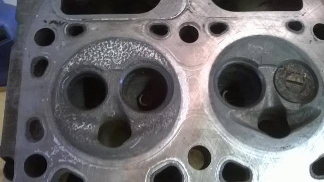

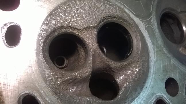

Hi all, some days ago i've start restore my yanmar 2210d, but when i opened the engine the cylinder head was in bad condition, see pictures, i don't no what happen. Have you ideas? thanks
   / Restore ym 2210 problem #2
Looks to me like the corroded cylinder has run with coolant leaking for an extended period of time. Needs to go to the machine shop and see if it can be repaired.

   / Restore ym 2210 problem #4
I agree with Winston..you have run this tractor for some time with a blown head gasket / cracked head .
   / Restore ym 2210 problem #5
May have a cracked block. The ports I can see and the Head itself looks fairly good. No Doubt have it checked. Hope it's only the head.

   / Restore ym 2210 problem #7
What exactly are you referring to? Looks normal to me. Lap in the valves and you are good to go.

   / Restore ym 2210 problem #9
It is going to take a lot of lapping for the left hand valve shown in picture two.
   / Restore ym 2210 problem #10
I would be more worried and concerned about were the water is coming from. The Valve Seats look in fairly good condition. I've seen a lot worse. Esp. working at a Machine shop in my late teens and early 20's.
