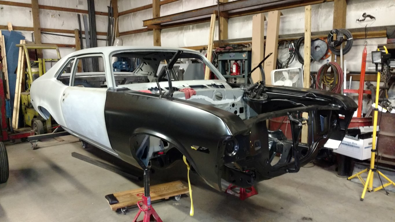

Got the cherry picker extracted from the back of the shop this afternoon. Pulled the 434 out too and took the MSD TBFI unit off and bolted on the lifting plate. Picked the engine up and took it loose from the engine stand, was balanced just about right. (y)
Unboxed the new TKX600 Tremec 5 speed transmission and set it on one of my tool carts with some 2X4 blocks to keep upright and rolled over to the engine. Raised the engine up and got the trans lined up and pushed into the bellhousing. I didn't install a clutch, no reason to at this point, as I'm only doing this to check for trans clearance in the tunnel. Bolted them together and put a ratchet strap on the rear of the trans up to the chain holding the engine and got it leveled out so it would set down on the subframe in the right attitude.
Rolled the subframe under the engine and trans and lowered it down onto the front engine mounts and stuck the bolts in, had to rest the rear of the trans on a chunk of 2X4 as I haven't been able to find the trans mount yet. Once I do, I can roll it under the body to check out clearances. I have to take the shifter and cover off first though.
I can also mark the underside of the tunnel for the hole for the shifter while it's in position.
Only problem I ran into is that the engine mounts seem to have welds that interfere with the mount setting down all the way on the frame mounts I'll take them off and take a look to see what's going on.
The legs and casters I put on the subframe work great to roll it around.

Took the shifter off the transmission, covered the hole with a rag and carefully rolled the subframe under the body. Got it into position and put the 3/4" alignment bolts into their holes, slid underneath on a creeper and checked for clearance. Looks like plenty of clearance, even after the subframe will go up about 1/4" when bolted in place, as there is at least 1/2" to 3/4" clearance all around the transmission.
I had to relocate the plug wires and EFI cable that I had routed behind the right cylinder head, as they were pinched against the firewall. Also checked the fit of the heater air duct, and it's close, but will be okay. It also looks like the firewall in that area is pushed out a little, maybe 1/2" or so, so I'll address that once I get the engine out of the way.
I still need to mark the location of the hole for the shifter, and as a plus, the plate with the shifter lever in it can be reversed so the shifter is forward about 4" or so if necessary. I'll see where it comes out, and how it looks. I may get the seats back from the upholstery shop soon and I'll install the driver seat to test the location before I cut a hole.
