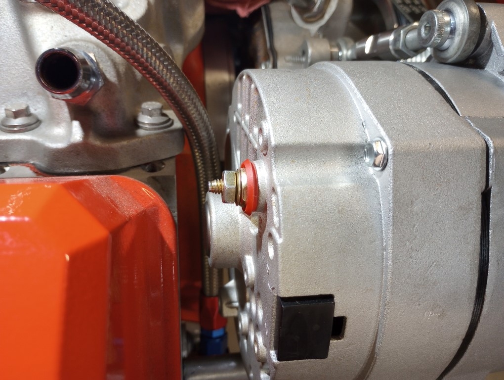

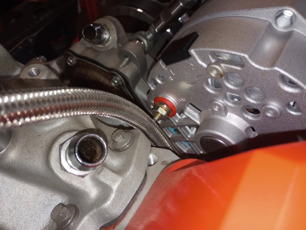

When I had mocked up the engine and started it up last fall, I had noticed that the alternator wasn't charging, so I pulled it off and looked it over, couldn't see a problem. So I took it to the shop I use for starter and alternator repair to have him look at it. He set it up on the test stand and confirmed it was not putting out anything, so he put it on the bench and pulled it apart. It is a 10SI Delco single wire unit I had bought from Powermaster way back when, and when he got it apart, he said he'd seen these single wire conversions before, and most of the time they don;t work well or not at all, like this one. So he changed the internal regulator and a diode trio and put it back together. Now, on the test stand it was putting out 14.5 volts and over 80 amps! He only charged me $38 total, and I was on my way. I put it back on the engine and thought it was good to go. Until I noticed today that he had clocked the rear cover 90° off, and the output stud was hitting the fuel line. :( So I pulled it back off the engine took it apart and rotated the rear cover to the correct position and reinstalled it.

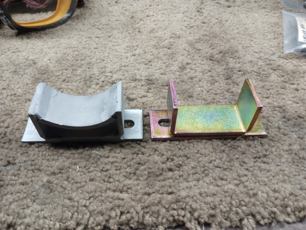

I have an Adco sway bar to install, so I unpacked it and spent 15 minutes freeing the sway bar from the bubble wrap that it was packed in, that had fused to the bar over the last 10 or so years. Read the instructions and looked pretty straightforward to install. Where the bar is bolted to the axle tube, they use a flat plate and a squared off C shaped piece that seats on the axle. I thought that was pretty hokey, so I bent a couple of pieces of 1/4" X 1 1/2" bar stock to seat properly against the axle tube, and welded them into the supplied piece. I bead blasted the pieces, painted them and once dry, assembled it to the axle. The directions clearly show the bar and the pivot mounted directly under the axle, but in that position the end link brackets that are supposed to bolt to the frame member in the wheel well are not even close to the frame. To get them positioned so the arms on the bar are level, as I'm sure they should be, the axle mounts are pulled forward at a 45° angle. I don't think that will work, because when the car body rolls one way or the other, that is going to want to twist the mount up or down due to the considerable force it takes to twist the sway bar, instad of exerting force directly under the axle tube. I sent a message to Adco to see what they think. This is supposed to be the correct sway bar for a Nova, but I don't think it's a good way to install it.

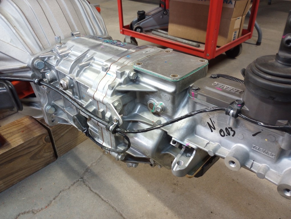

I got the engine and trans positioned over the subframe and eased it down into place, it still fit! I installed the motor mount to frame bolts and the transmission to crossmember bolts and tightened them up. It ain't going anywhere now!

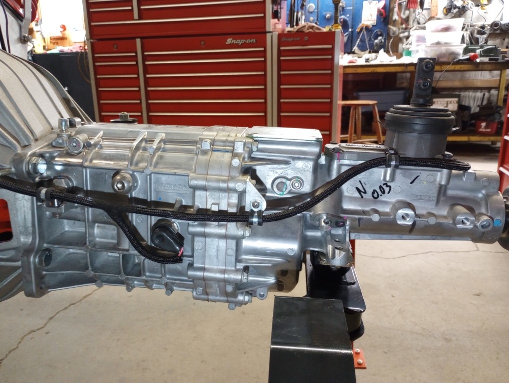

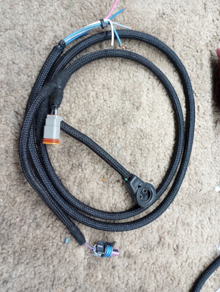

While taking a little Diet Coke break, I was setting looking at the wiring harness I had made for the transmission. It has a speed sensor, neutral switch and backup light switch that hook up to the electrical system and cruise control. I had kind of slapped it together one day and it looked like it. Not good. My OCD was itching to rip it off and make a better one, so that's what I did. Instead of using the six conductor cable, I used six differently colored left over wires from the body harness installation, installed a new Deutch connector for the neutral switch connector and spliced the other wires onto the speed sensor and backup light switch leads. Then I ran it inside a piece of braided loom conduit and taped up the joints. I hooked it up to the transmission and reinstalled all the loom clamps and now it looks 200% better. One thing I forgot, however, were the wires from the button on the shift lever that run to the LineLoc solenoid and 12 volt power. I think I can get two more wires inside the loom with no problem, so that's a task for tomorrow.

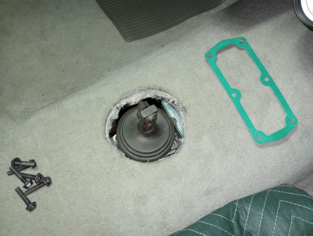

With the engine and trans in the subframe, I took the front of the car off the rotisserie and put a couple of jack stands under the front corners so I could roll the subframe under the car into position and mark where the shifter hole will go in the floor. After some careful measuring, I decided that the shifter needed to go in the forward position or it would be too far back to be in a good position. It works out to be just about in the same fore-aft position as the Muncie shifter was in. I drilled a pilot hole from the bottom and stuck a straight pick up through the carpet so I knew where to cut the hole. I trimmed out a ~5 inch opening in the carpet and pad and went to get my 4 inch hole saw. Looked everywhere, couldn't find it. I'm sure I'll stumble across it one of these days. Went to Lowes and got a 4 1/2" hole saw, brought it back and started to drill with my big DeWalt 1/2" drill and promptly snapped off the pilot bit. Stole one out of another arbor and was much more careful this time, and got it all the way through.
Rolled the subframe back into position and with the shifter in the forward position thankfully it was well centered in the hole.

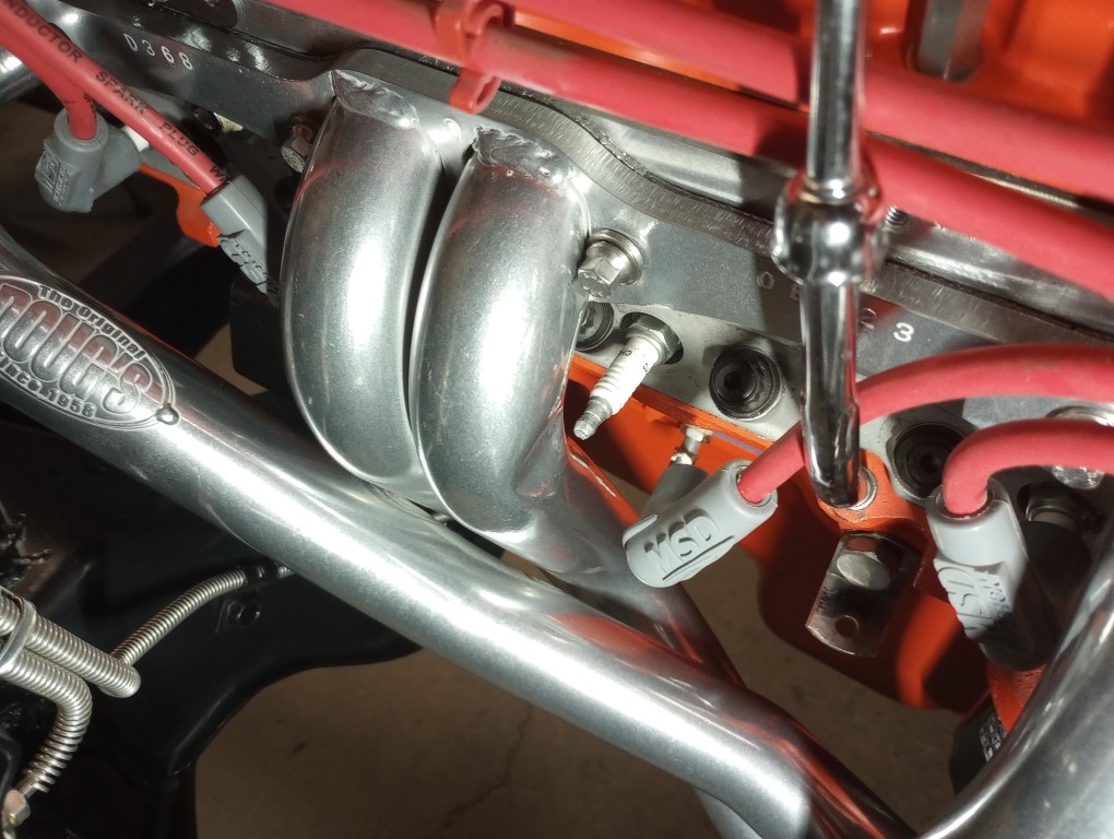

Next I hung the new Doug's right side header on the engine and snugged up some of the bolts only to find the #6 cylinder tube was tight up against the idler arm pivot. Well crap, that's not going to work! The fuel line was pretty close to the tubes too, so I massaged it quite a bit and managed to get it as far from the header tube as possible. I may put some sort of insulation on that part of the line just to help keep it cool.
I figured I'd better check the left side too, and everything cleared on that side, except for the #5 tube is so close to the spark plug I can't even get the plug wire on it. Well crap again. Called the Doug's Headers tech support, and the tech said to sent some pictures and they'd get back in touch. That was Wednesday and I haven't heard a peep so far. I even resent the pictures and an explanation of the problems. We'll see what happens.

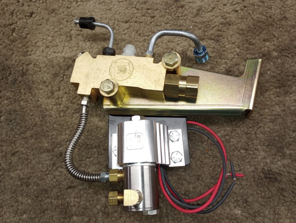

I decided to get a bracket made to mount the Line/Loc solenoid valve on the bracket with the proportioning valve. Found a piece of 11 gauge steel, marked out all the needed holes, drilled them and cut the piece to size, rounding off corners and smoothing edges. I test fit everything and it looked good, so I prepped it and painted it satin black. This afternoon, I assembled it and undertook to make a short line from the proportioning valve to the solenoid. I had a brake line left from a set I bought for the car, but didn't fit it anywhere, so I cut it to the proper length, installed the nuts and protective coil and flared the ends with my new brake line flaring tool. One end came out fine, but the other end split through the flare, so I started over and got good flares on both ends this time. Managed to get that damn stiff little line bent to the right shape and tightened down after well over an hour of work, but it looks good.

I’ve never had headers, when I was into classic cars I just left the stock manifolds on, but I always heard they can be a pain. Big hammer time?
   / Restarting My '70 Nova Project #390
I recall many fights with headers on friends' cars back in the 70s. Seemed something always hit something somewhere. šŸ™ƒ
