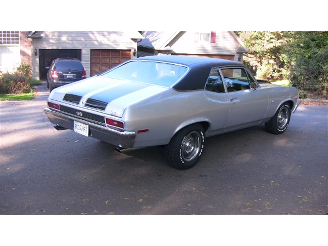

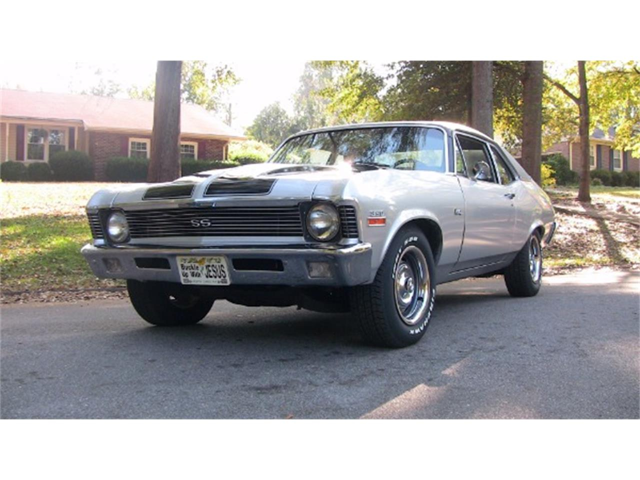

Forgot to mention, I'm considering adding racing stripes to the hood and trunk. I like the looks of them, especially black stripes on the silver body.

That would look great, especially with the top.

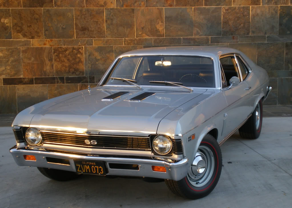

The grille on the Nova in the picture is not painted correctly, an SS grille has chrome bars only at the top and at the bottom, not all chrome like it has, Same with the headlight doors, and that makes a big difference in the looks.

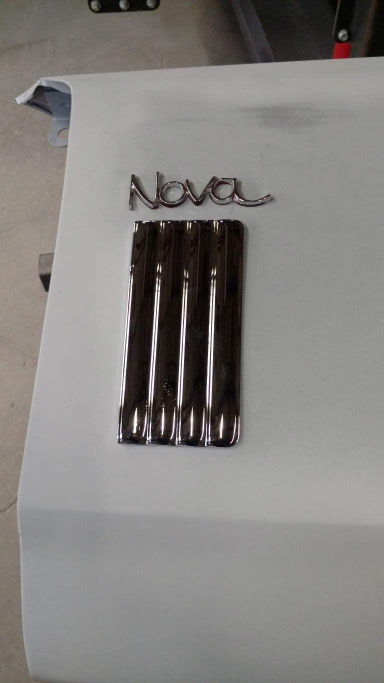

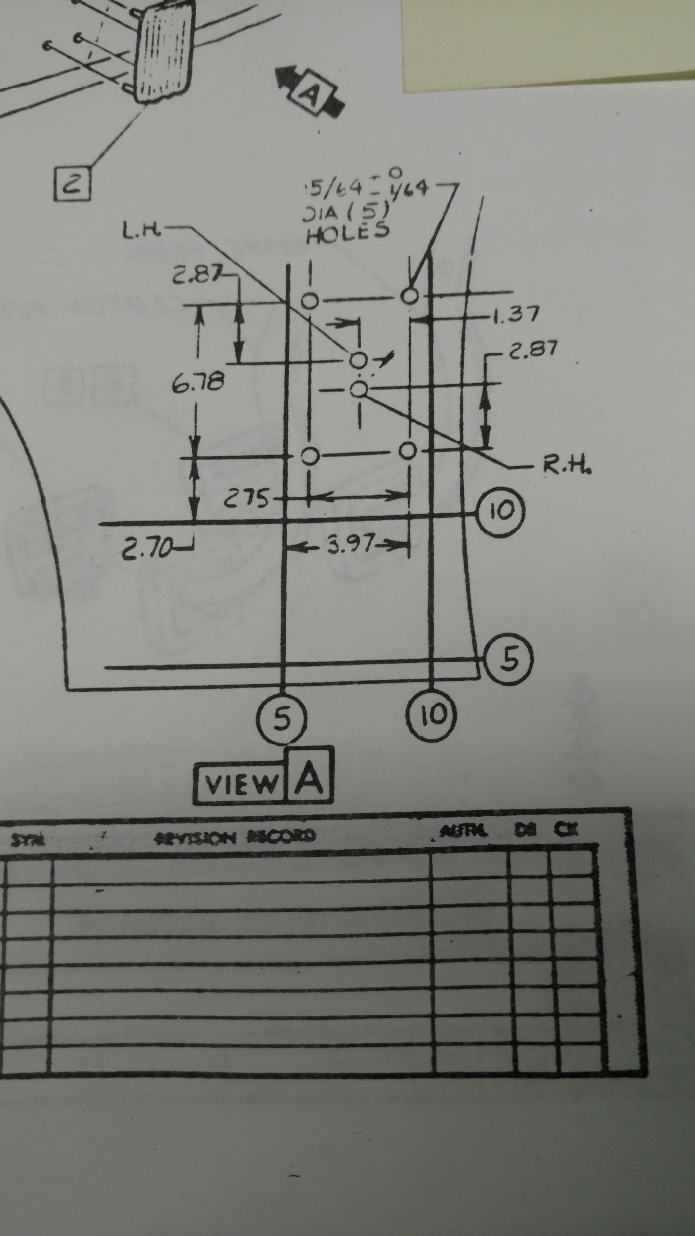

Still waiting on the Owner of the paint shop to come and look over the Nova project to see if there is any more that needs to be done. So , figured it was a good time to (Yikes!) drill some holes in the front fender for the simulated louvers and Nova scripts.
Having not had the foresight to make a pattern off the original fenders, I found the information, well sort of, in the assembly manual. It gives the layout pattern referenced to a couple of datum lines, but not what the datum lines are referenced to. So i studied a lot of pictures of Novas and made an educated guess. I made a pattern out of craft paper, taped it to the fenders, marked the hole locations and drilled the holes. No going back now!
They look okay, but it would really have helped for the fenders to be on the car, just to make sure.

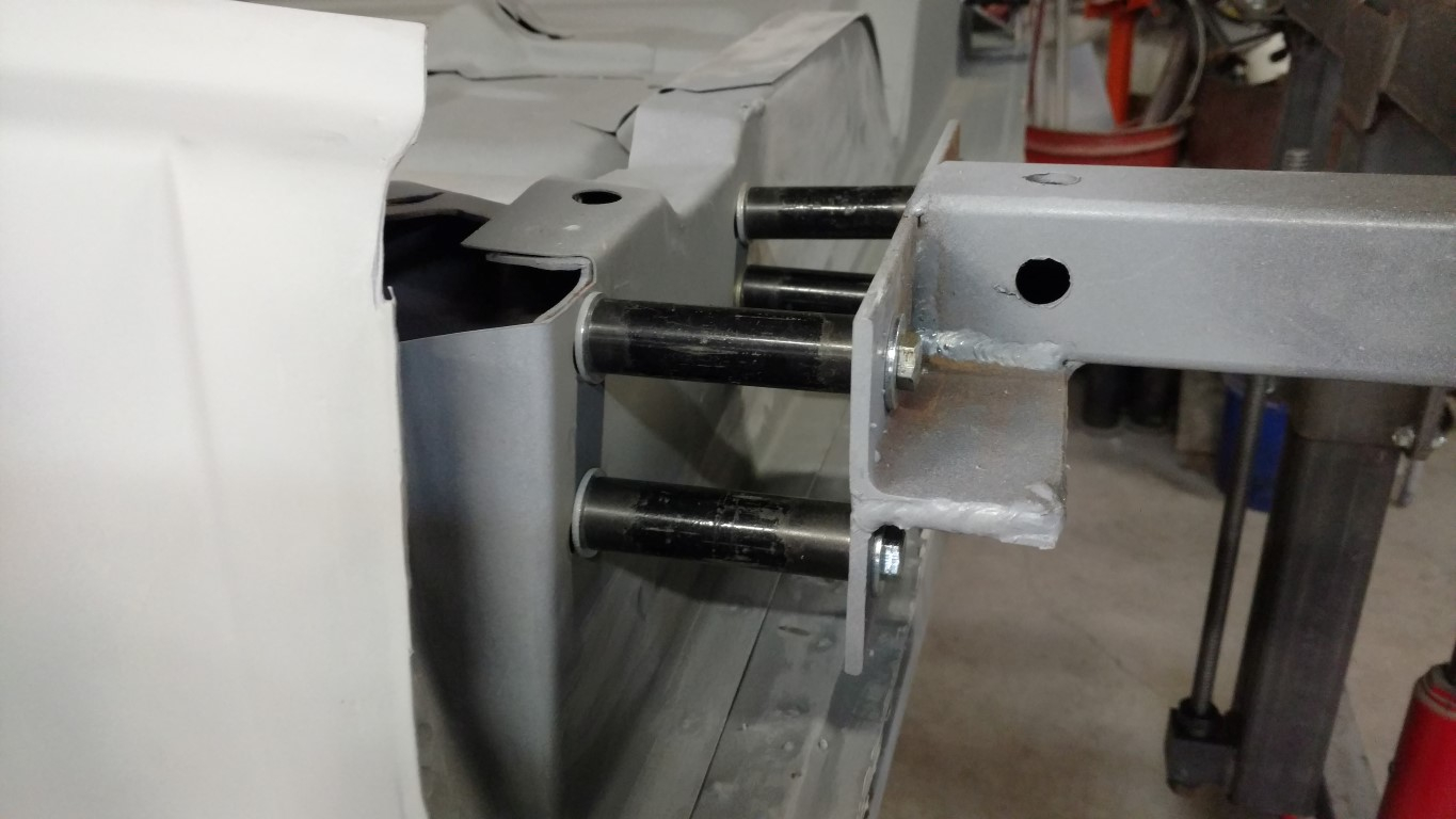

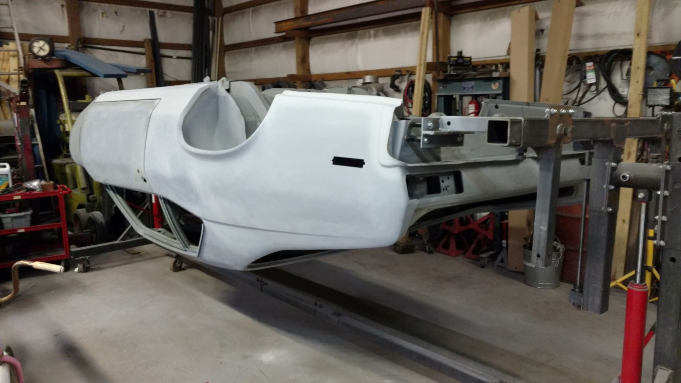

I made up some spacers and installed them between the rotisserie mounts and the rear bumper mounts, so the painter can get in there with paint. Otherwise there would have been a big area on each side not painted. I also raised the body up about six inches so it can be rotated a full 360° without hitting the crossbar. I may weld a couple of chunks of 1/4" X 2" flat stock to the pivot so I can lock it in place with a couple of bolts for transport to the paint shop.
