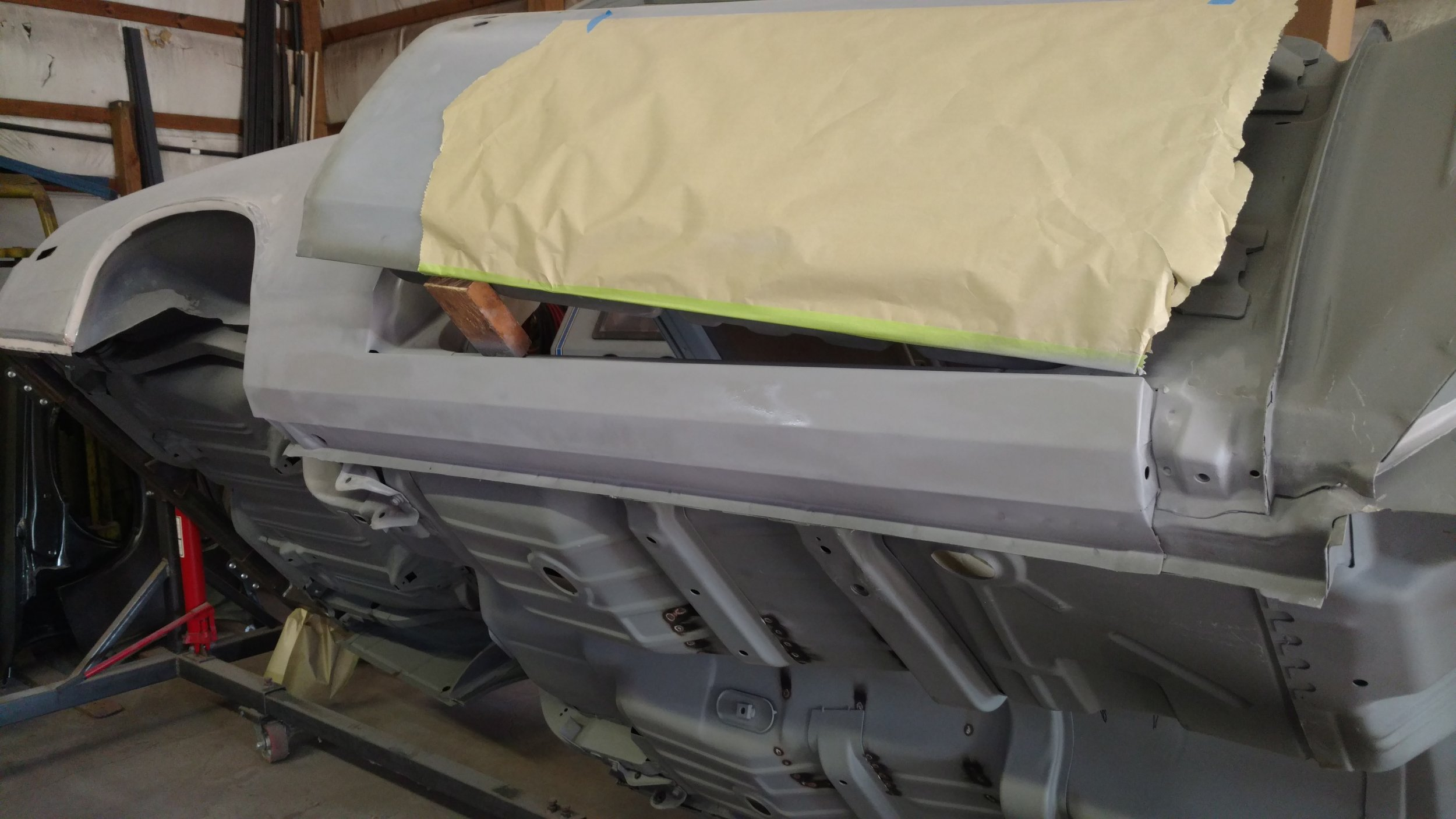

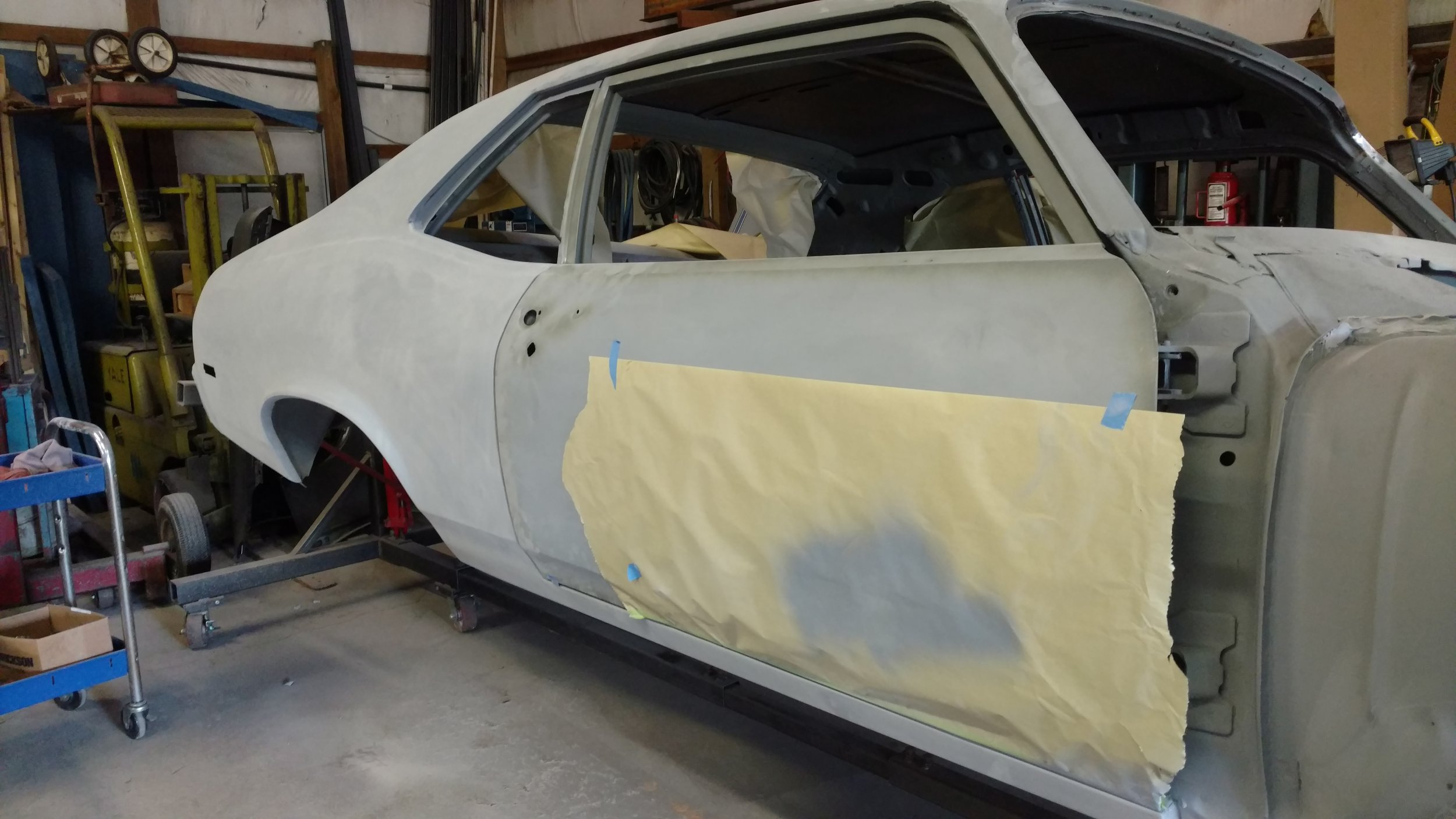

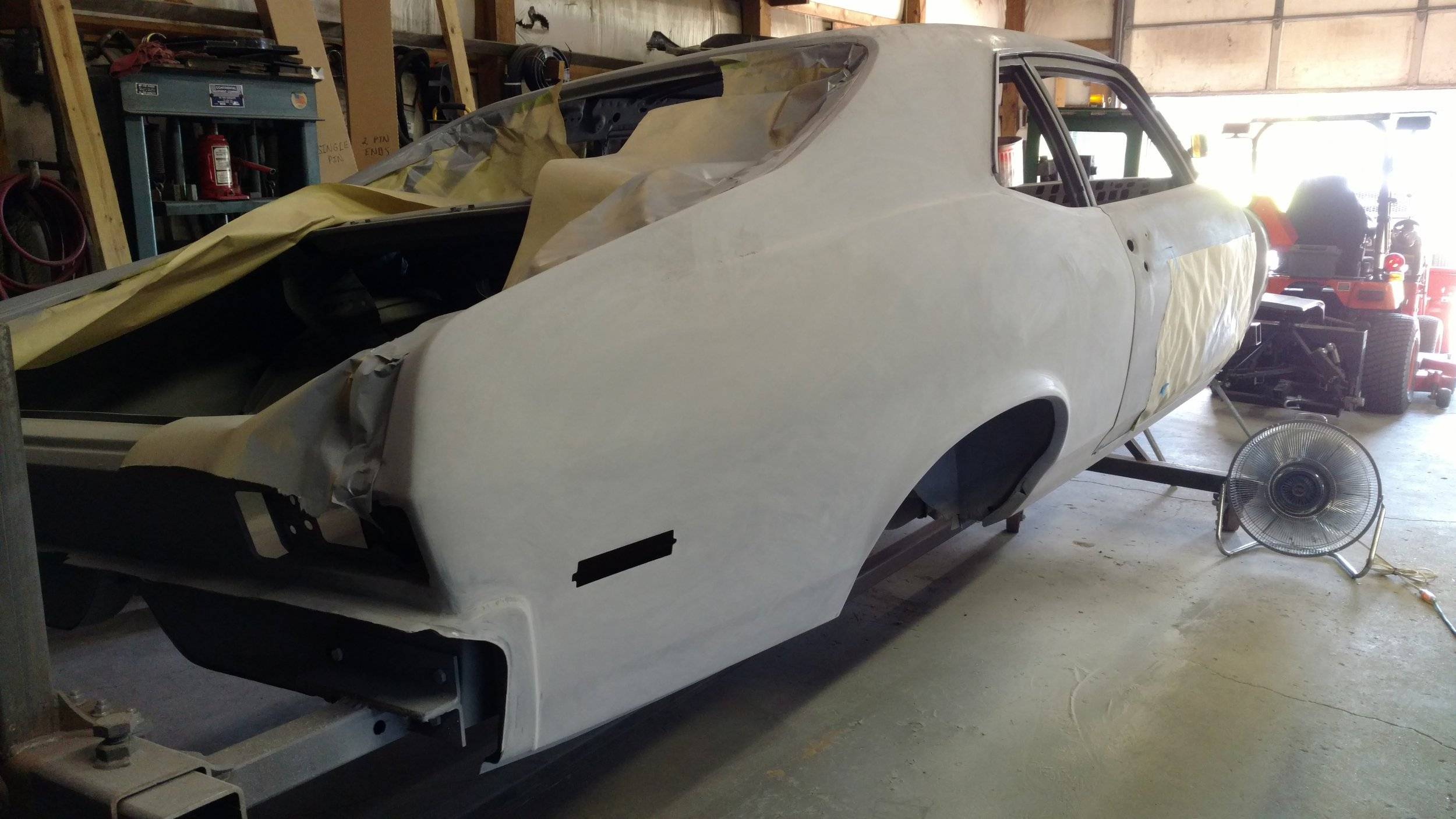

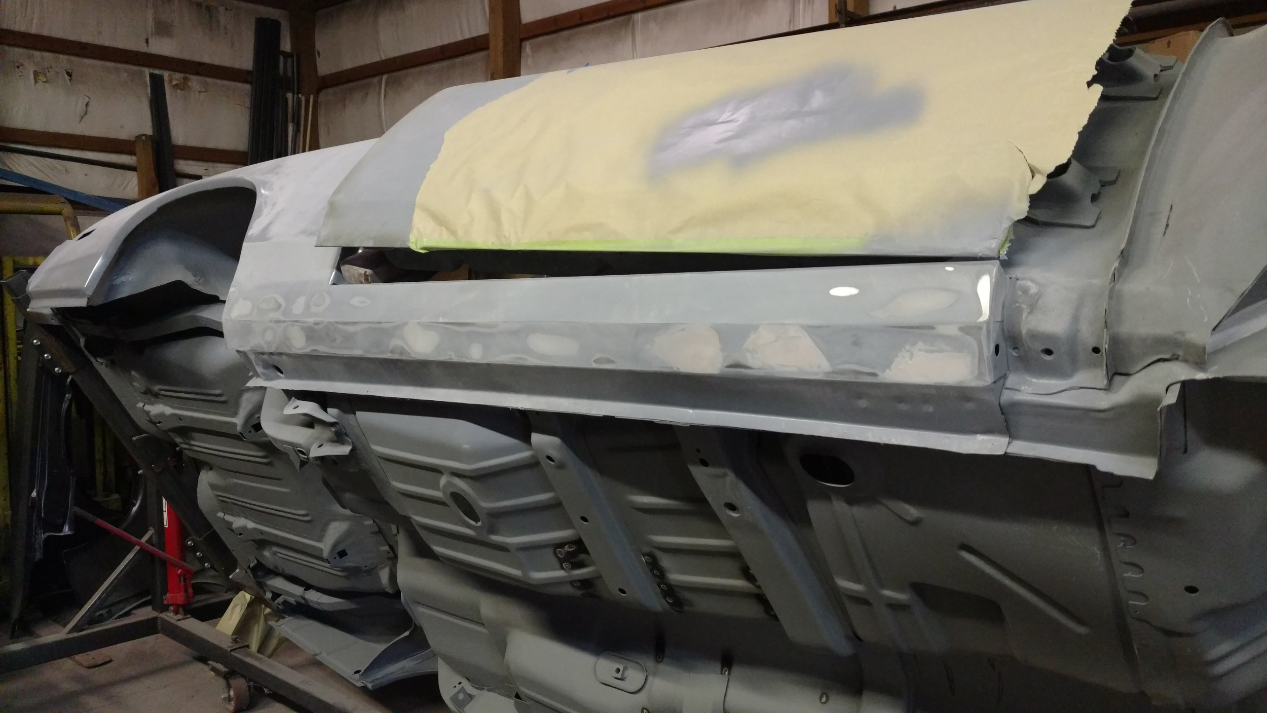

I spent about 12 hours this week filling, sanding, priming, guide coating, more sanding, more filling, well, you get the routine. But, The right quarter and rocker panel are done. The quarter had a few little areas that needed a little filling and blocking, but the rocker panel was a bear. It looked pretty straight, but when guide coated and block sanded it needed a lot of work. Amazingly, the of all the metal that was replaced, the rockers were in good shape, no rust internally (I scoped them) or on the outside, but they certainly weren't very flat. To make it worse, I welded shut all the holes used for the two lower trim pieces and ground them down, leaving areas that needed some attention.
Today swapped the rotisserie end for end so I had better light to work on the driver's side of the body, and started filling all the low areas on the rocker and a few on the rear quarter. Then I blocked and hand sanded the hood for the last time, and other than a few slightly high spots, it looks really good.
Brian stopped by and inspected my work, said it looked really good or an amateur. He said I could always get a job at a body shop, as I;m do better work that some of them do. I think I'll stay retired, that's more work than I like.
Very nice! It always makes you feel good when a pro tells you you're work is good. ;)
