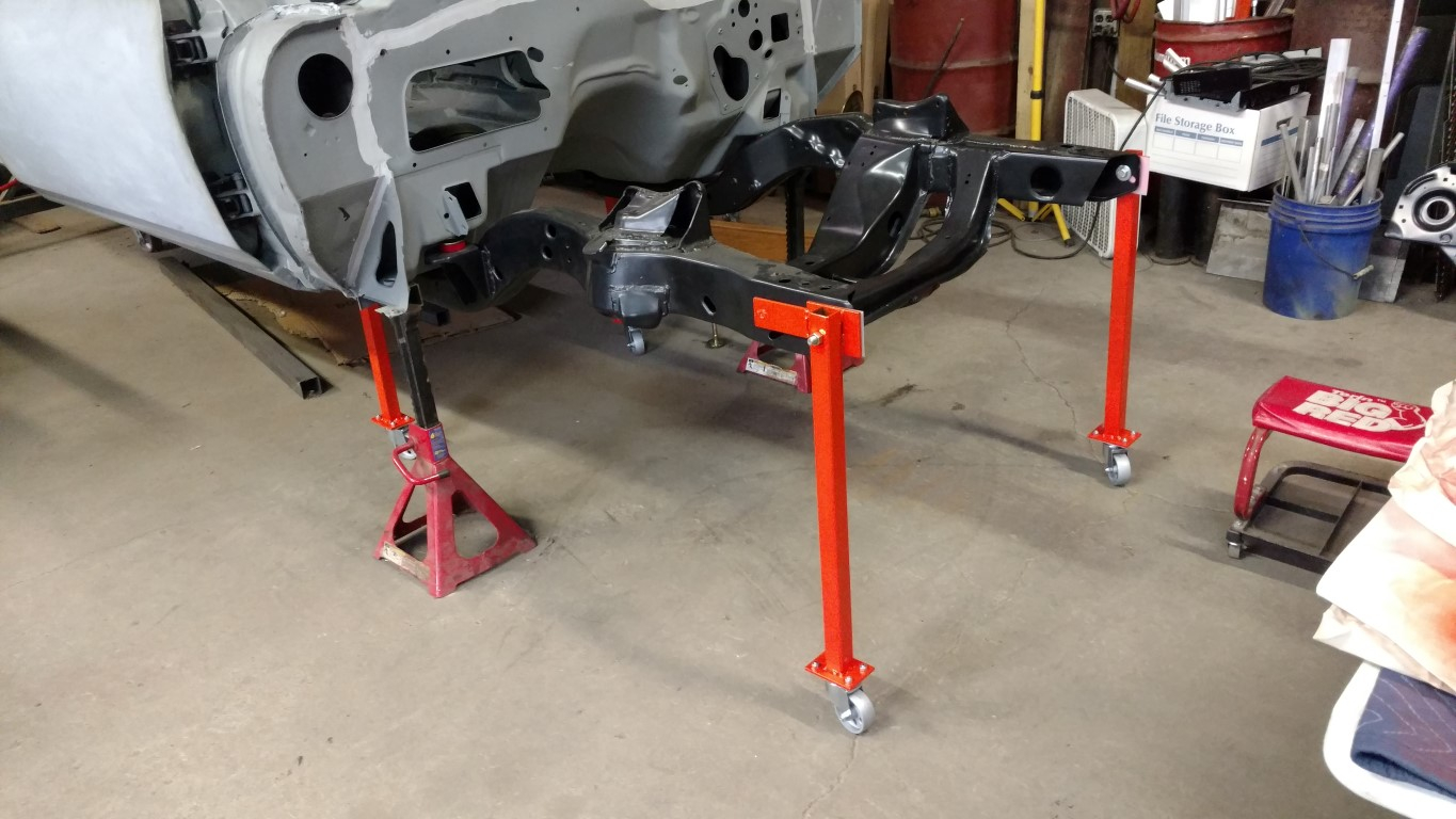

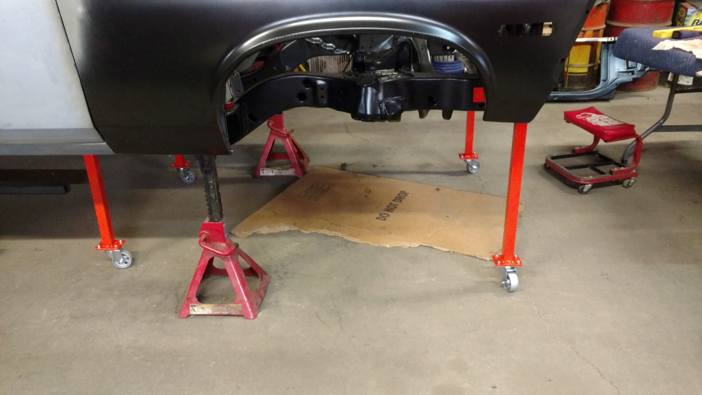

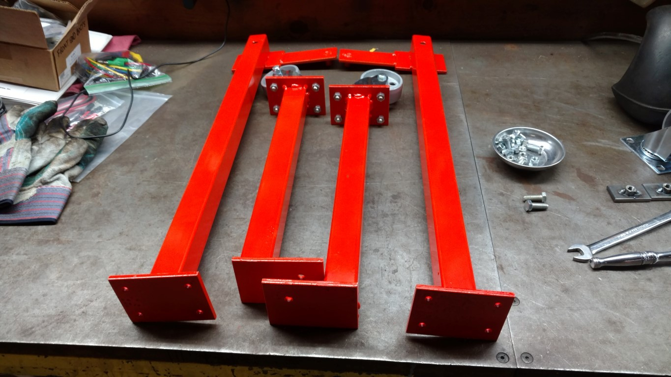

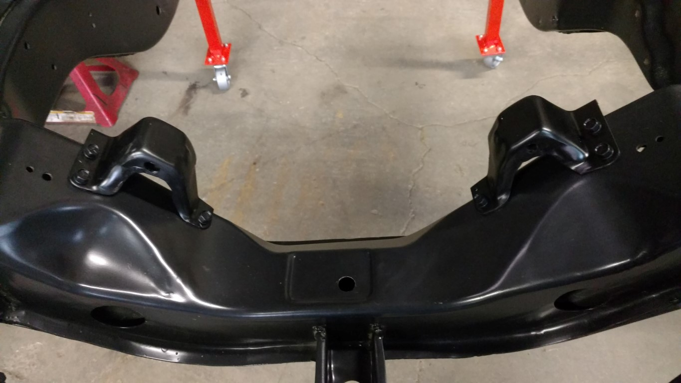

Since I'm still waiting on fenders for the Nova, I decided to pull the subframe off and install the engine and transmission so I can check to see if the TKO600 transmission will fit the tunnel without interference.
I've read a couple dozen forum posts on the subject, and the third generation Nova installations are about evenly split between fitting okay and having to modify the tunnel for clearance. So I figured I'd get it figured out now rather than later.

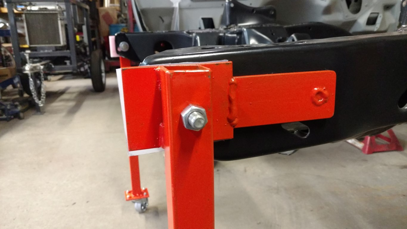

I picked up some 3" metal casters at Rural King, and used some 3" X 1/4" bar stock and 1 1/2" square 11 ga. tubing I keep on hand to fabricate four legs that bolt to the subframe so I can roll it around where I need it. Once I get the engine and trans dropped in it, I can just roll it into position under the body and bolt it back up to the body mounts to check the clearance. I made the legs about 1/4" - 3/8" shorter than the subframe is off the floor, so it will give me a little room to play with if it's really close.
Now I just have to move a few things so I can get my cherry picker unburied from the back of the shop and get out where I can use it.
Of course, I realize doing this means the fenders will show up right in the middle of this project. Well, I guess I can always dream...

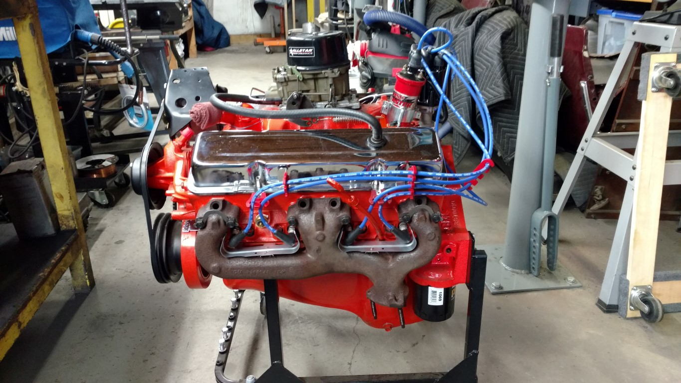

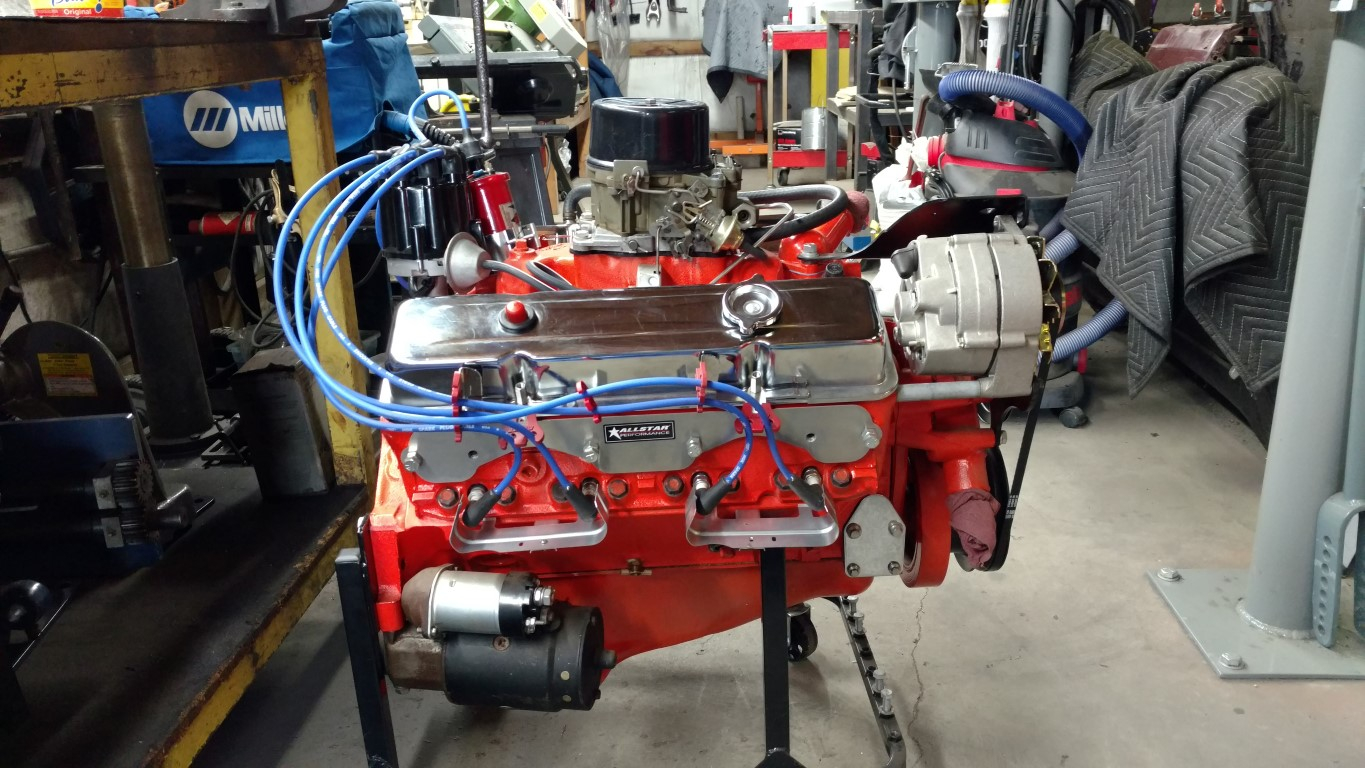

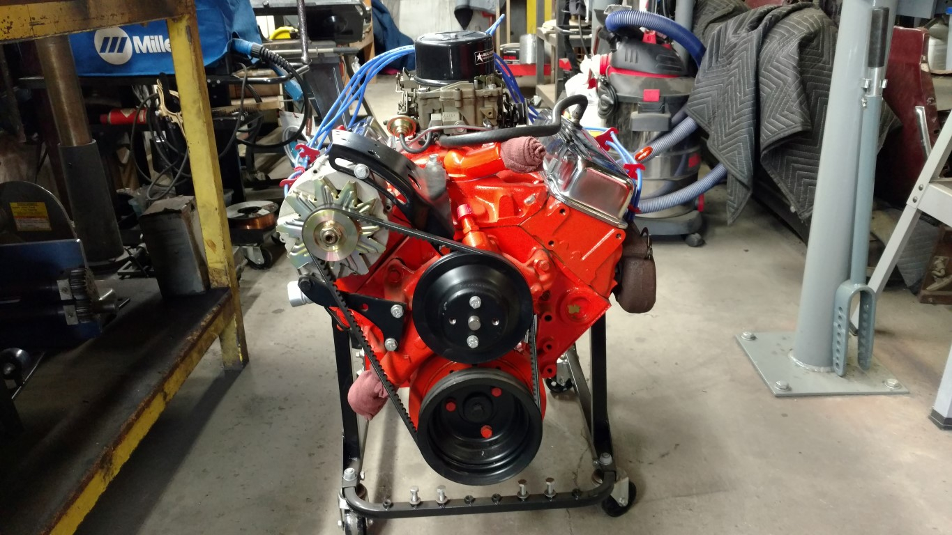

Worked on the original 350 engine out of the Nova this afternoon. I' trying to get it put back to the original condition as nearly as I can, since it is a numbers matching engine.
Put on the plug wire shields and bolted up the left exhaust manifold with no problems. The right manifold though, is a problem, the front two bolts and the center two bolts line up and go in just fine, but the two rear bolts won't. It's as if the back part of the manifold shrank about 1/8", the bolts will not line up and start in the holes. I don't remember any problems when I took them off, of course that was 6 or 7 years ago, but I've never seen this before. I pulled it back off and checked all six of the holes for rust or any other build up, but they are all fine, a 1/2" drill goes through the end holes no problem, and a 7/16" through the two center holes. Not that is should make any difference, but this is not the original manifold, as all stock small block heads have the same bolt pattern. The block off plates I had on the exhaust ports fit just fine, so it has to be the manifold.
Going to have to cogitate on it for a while and decide what to do about it. I may just get a new set of correct part number manifolds and be done with it.
Edit: Went down to the shop this afternoon and did some more looking at the manifold problem. I cleaned out all the bolt holes in the manifold with a file, really didn't need to, they were pretty clean.
I got out my 8" digital calipers and measured the distance between the outside center holes and the closest hole on the ends. The end giving me the problem is right at .060" (~1/16") shorter between the holes than the other end. That may not sound like much, but its enough that the bolts will not start straight in the holes in the head. There's not much meat between the hole and the exhaust port, so slotting it out to get it to fit would just cause it to crack at some point, so I'm not going to do that.
So, I'm just going to order a new manifold for it.
