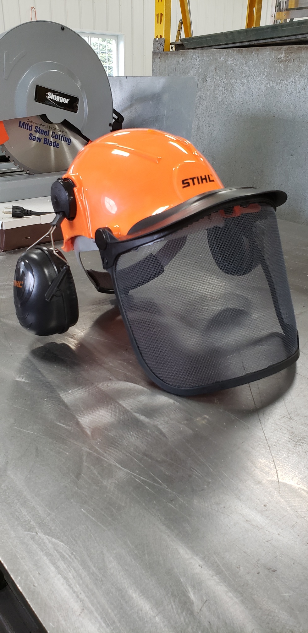

I usually insert some ear plugs and start chipping. But this last time I put on my new Stihl helmet/face shield and some leather gloves. I couldn't believe how much more enjoyable that task became. I have it sitting on the chipper just waiting for the next time. I wished I would have bought it years ago.

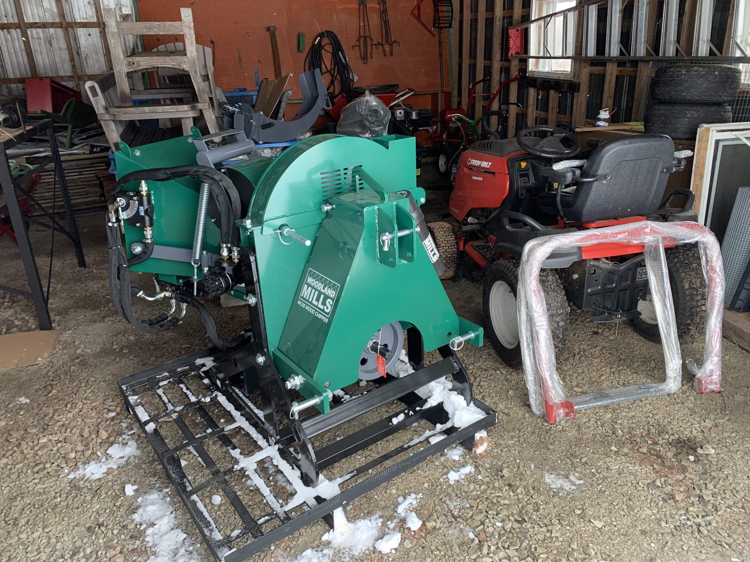

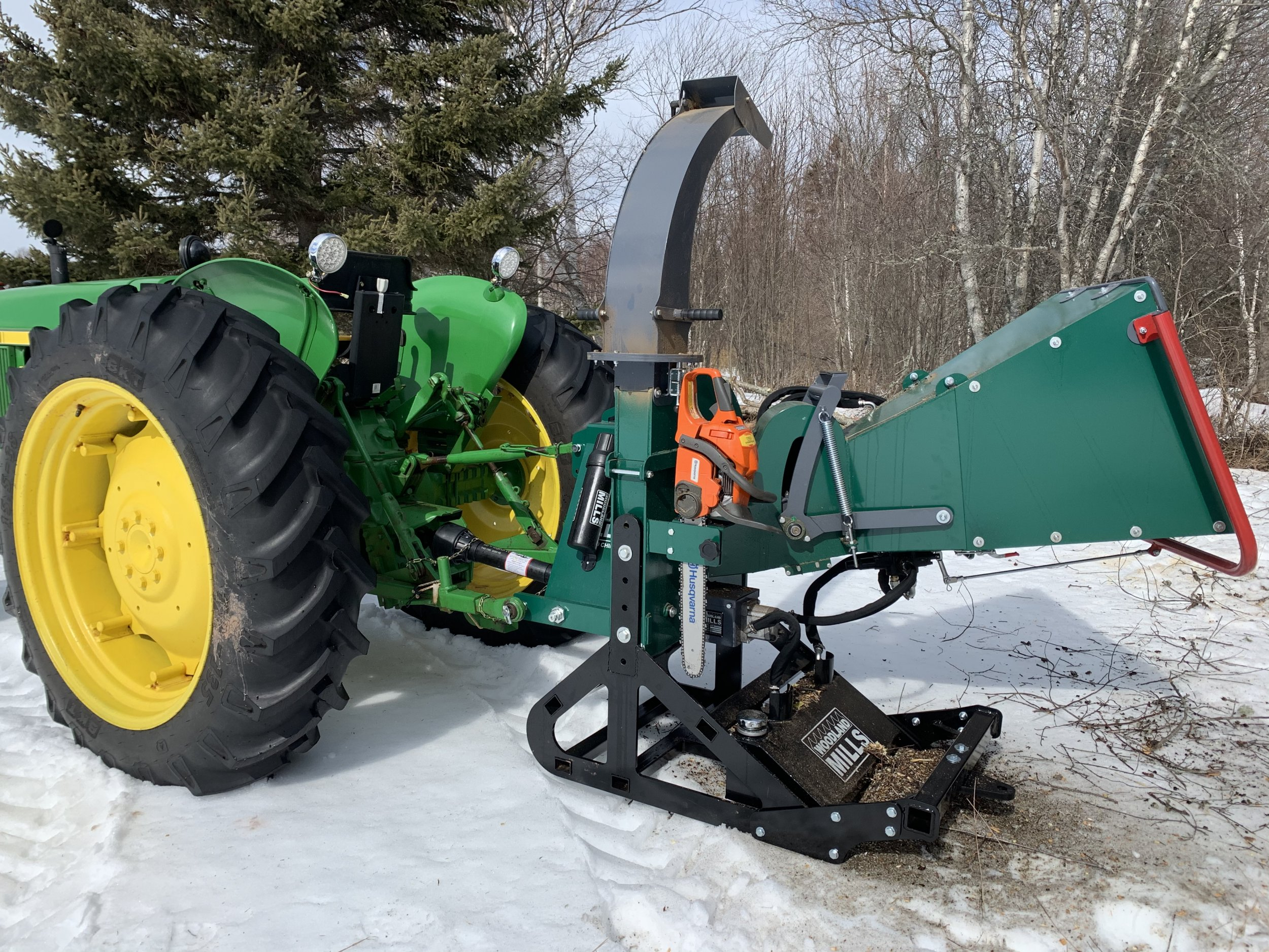

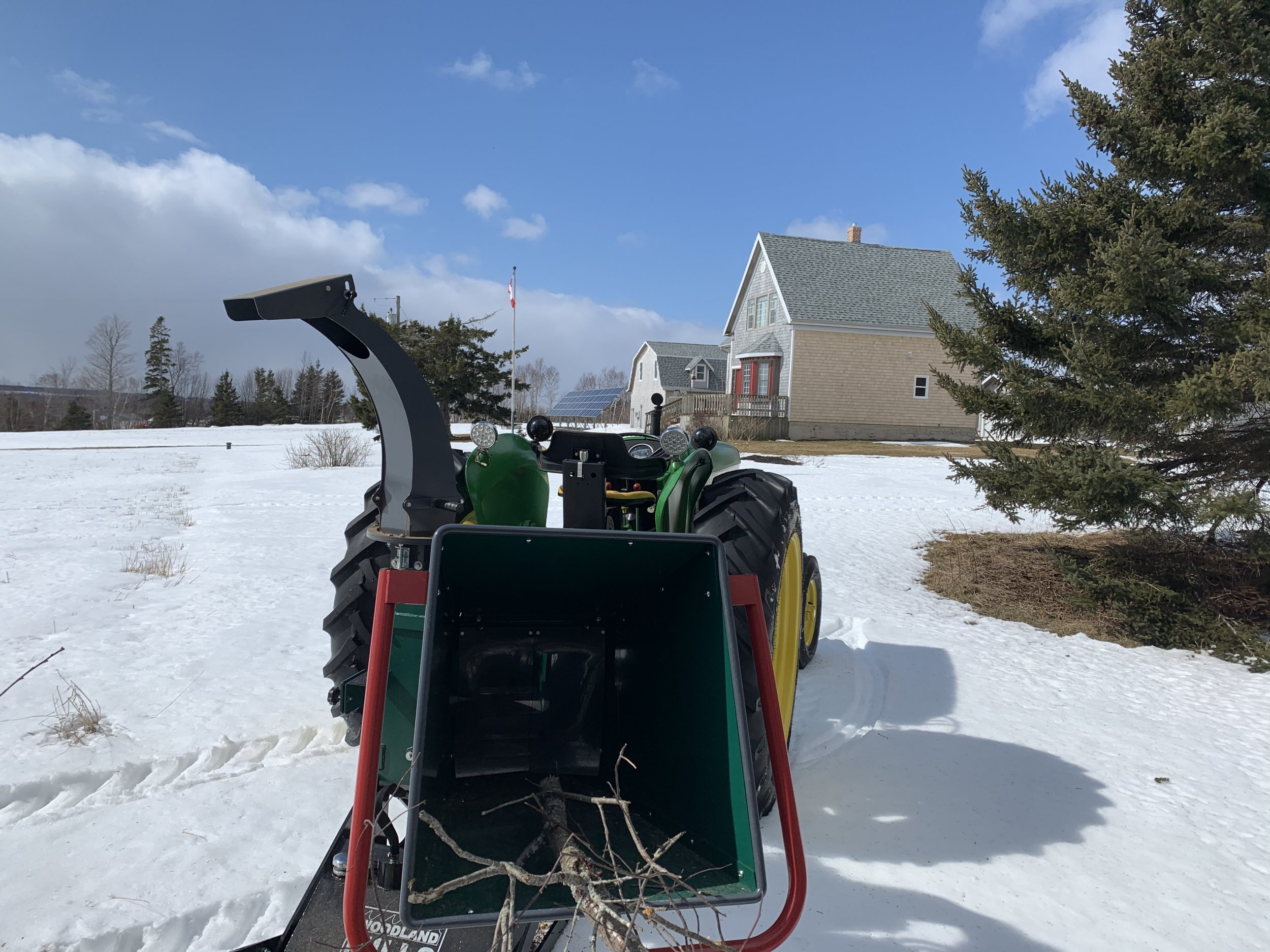

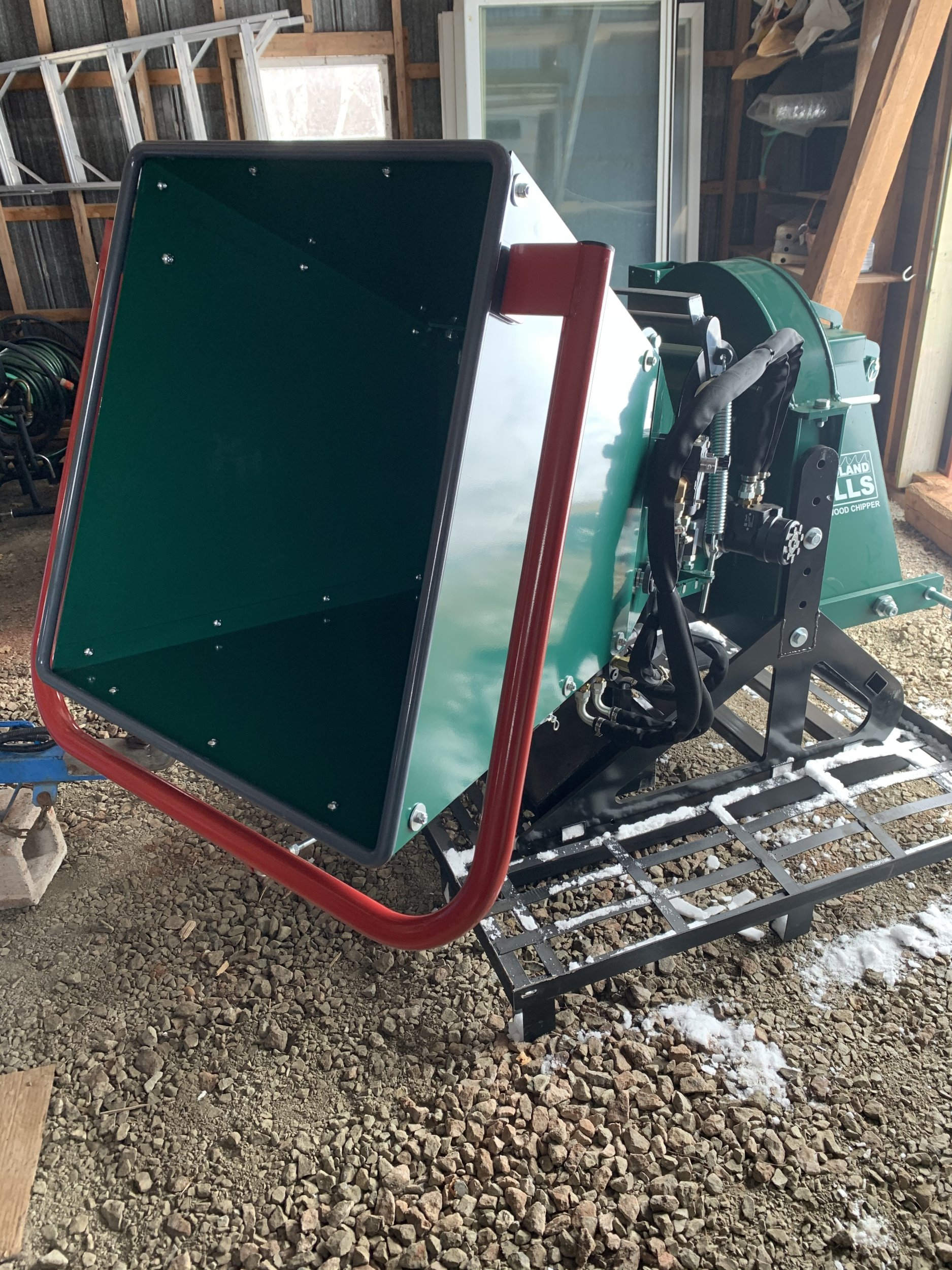

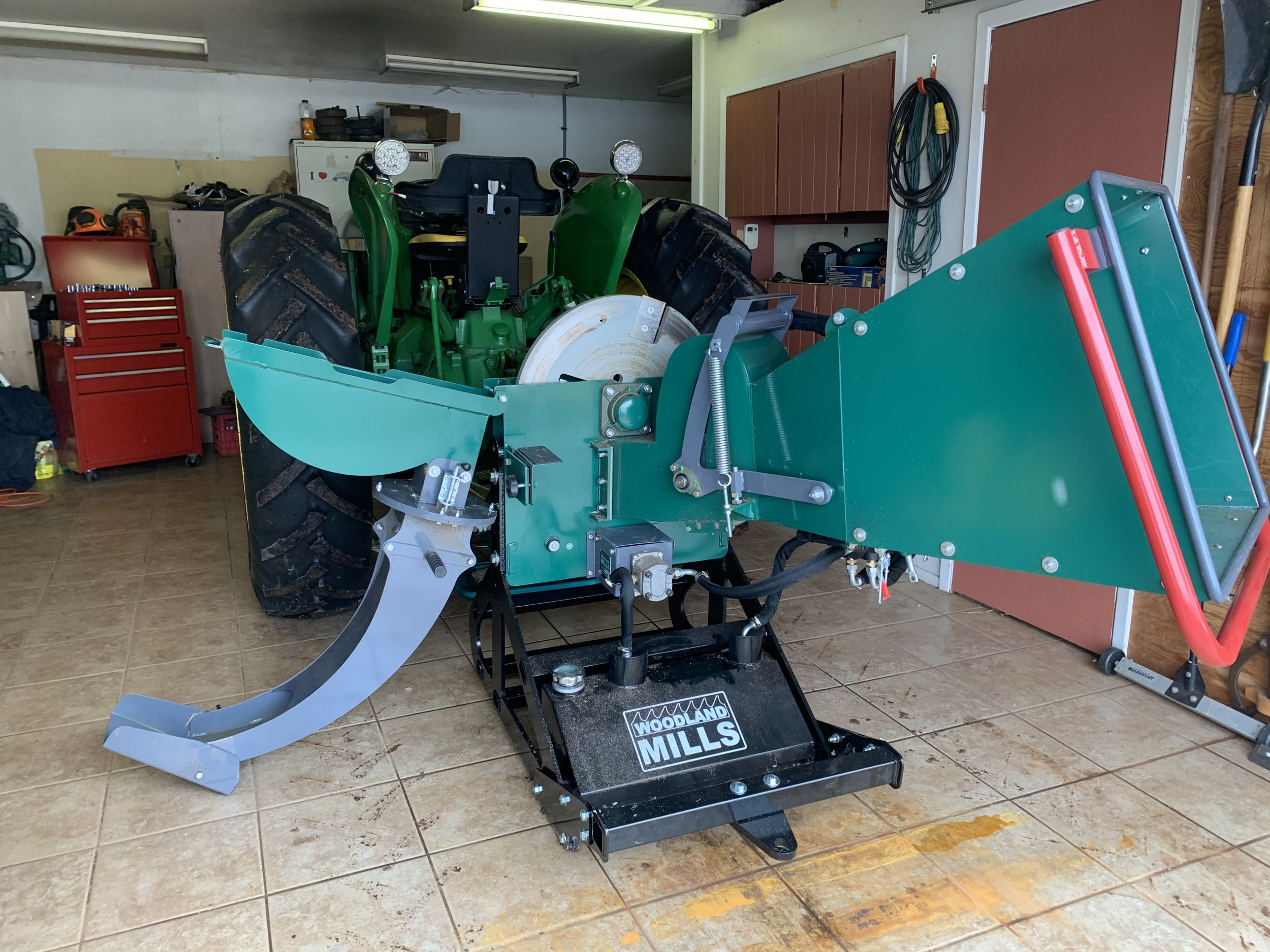

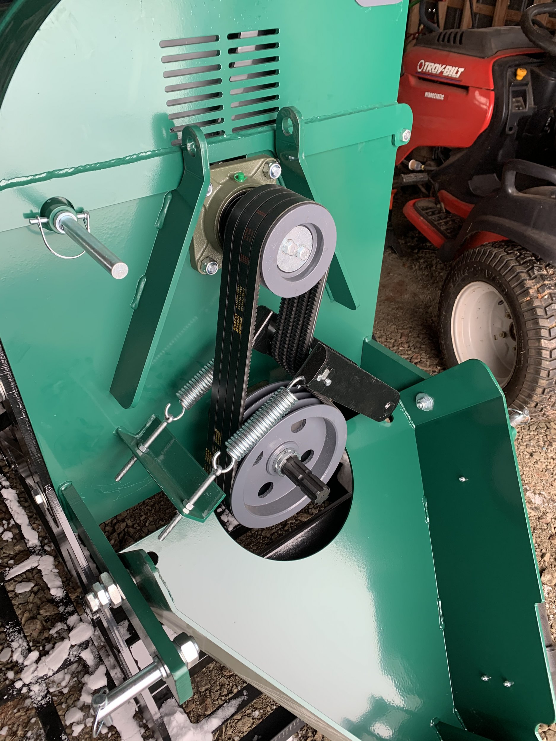

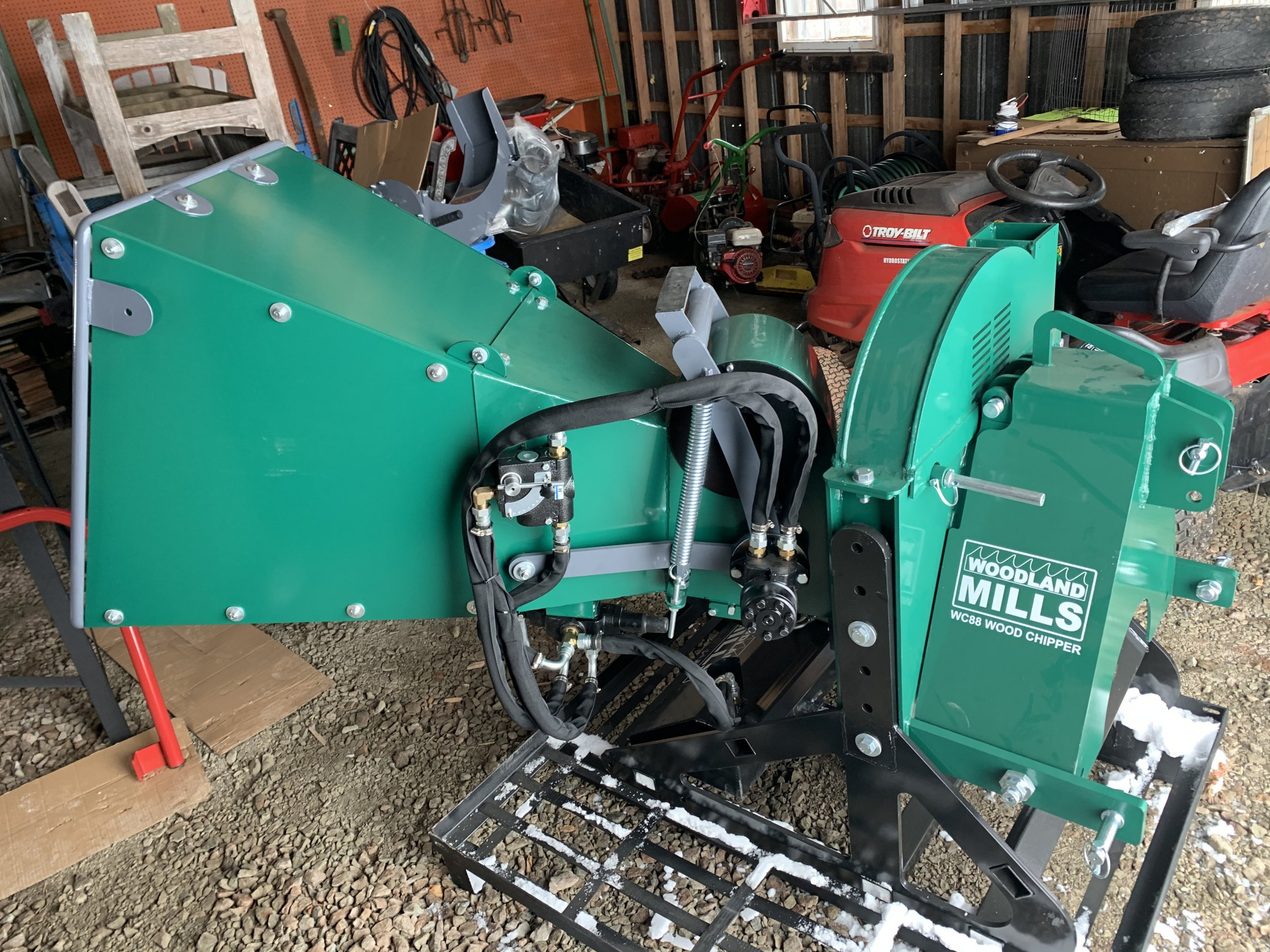

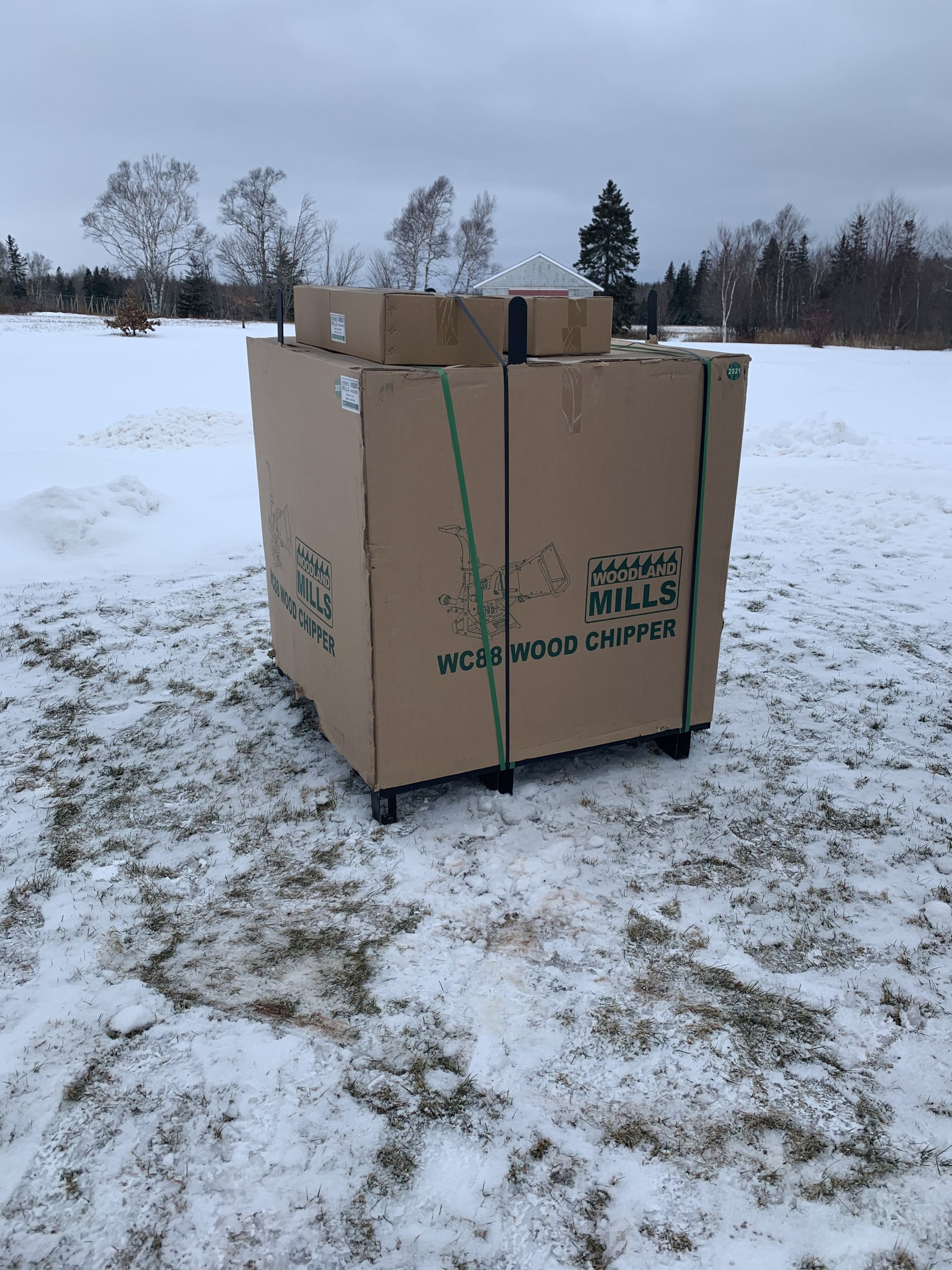

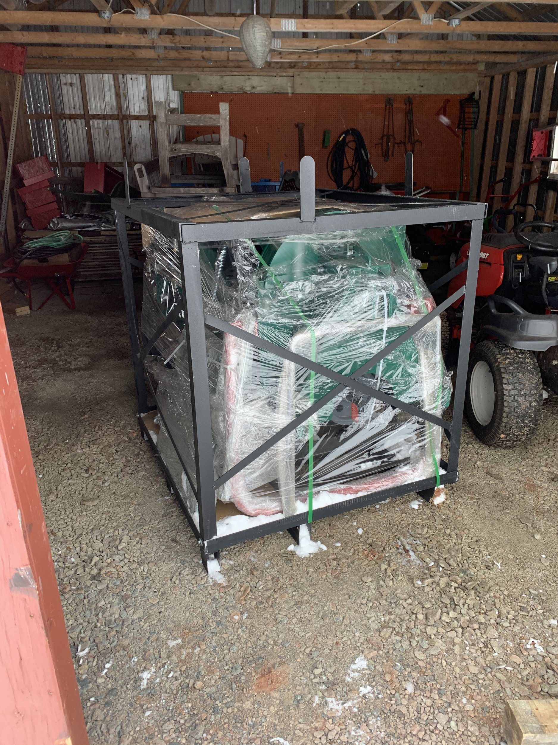

I wouldn’t let the Chinese manufacture of the Woodland Mills products scare you off a great product. I have a WC88 that I run off a 60 hp PTO but I got the larger 8” chipper just to handle the twisted bits better as anything over 4” becomes firewood. The assembly of the Woodland Mills chippers is simple, and operation is very simple. The hydraulic indeed is key as it provides control and the ability to reverse feed if required. The ability to slow the feed rate allows you to chip a larger stick than you could with gravity feed thus maximizing your capacity when needed. I ordered my chipper and 10 days later it was dropped in the yard. If you buy a Wallenstein in Canada you will pay a lot more money for no more capability. I looked at all the options in eastern Canada and the Woodland Mills made the most sense for me. I bought a set of spare blades and belts at the same time to minimize shipping, have not needed either yet. The ability to remove one bolt and hinge open the top and chute reduces the height so that I can bring the chipper into the standard height garage door easily which is a handy feature in my situation.
