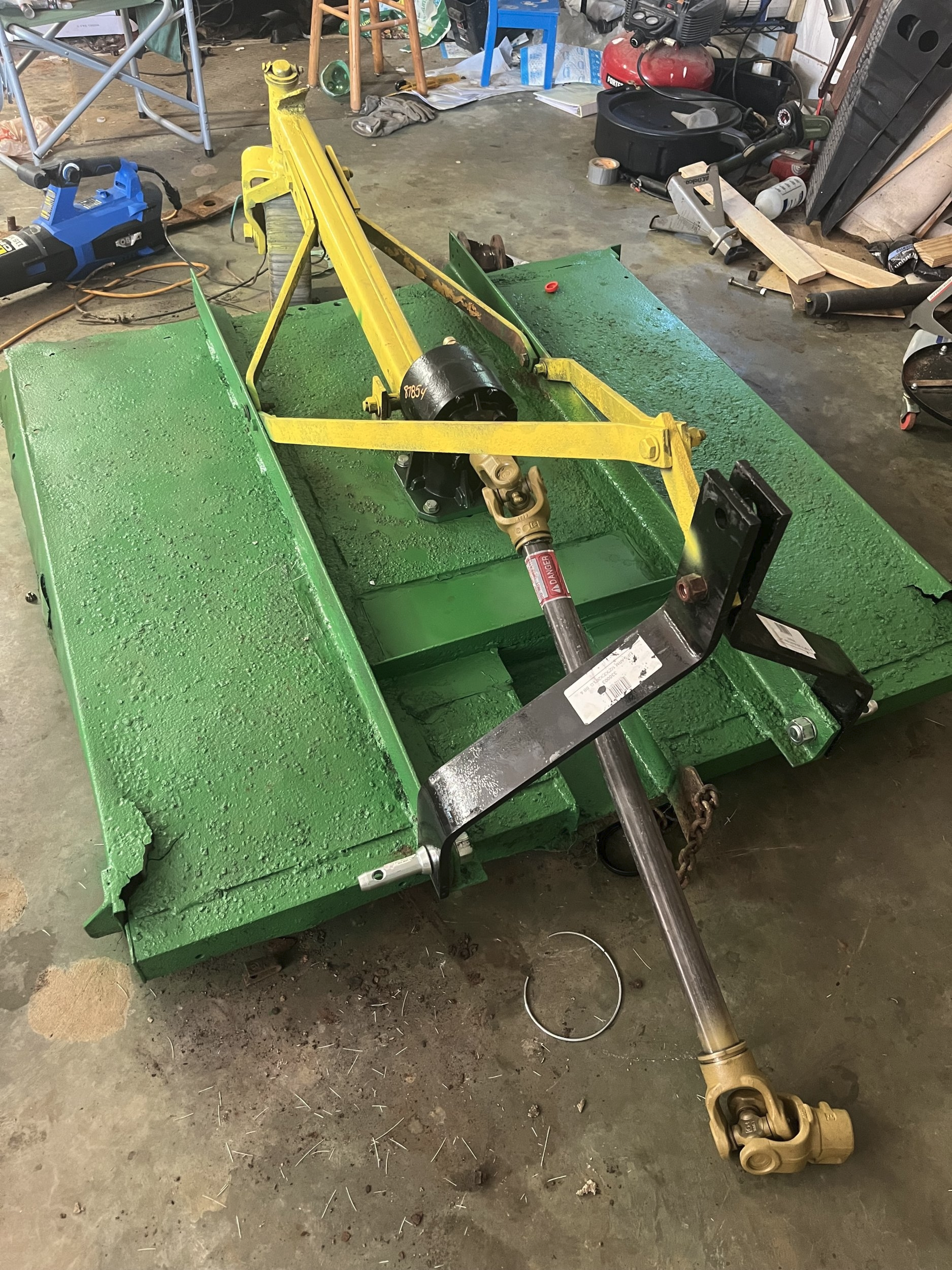

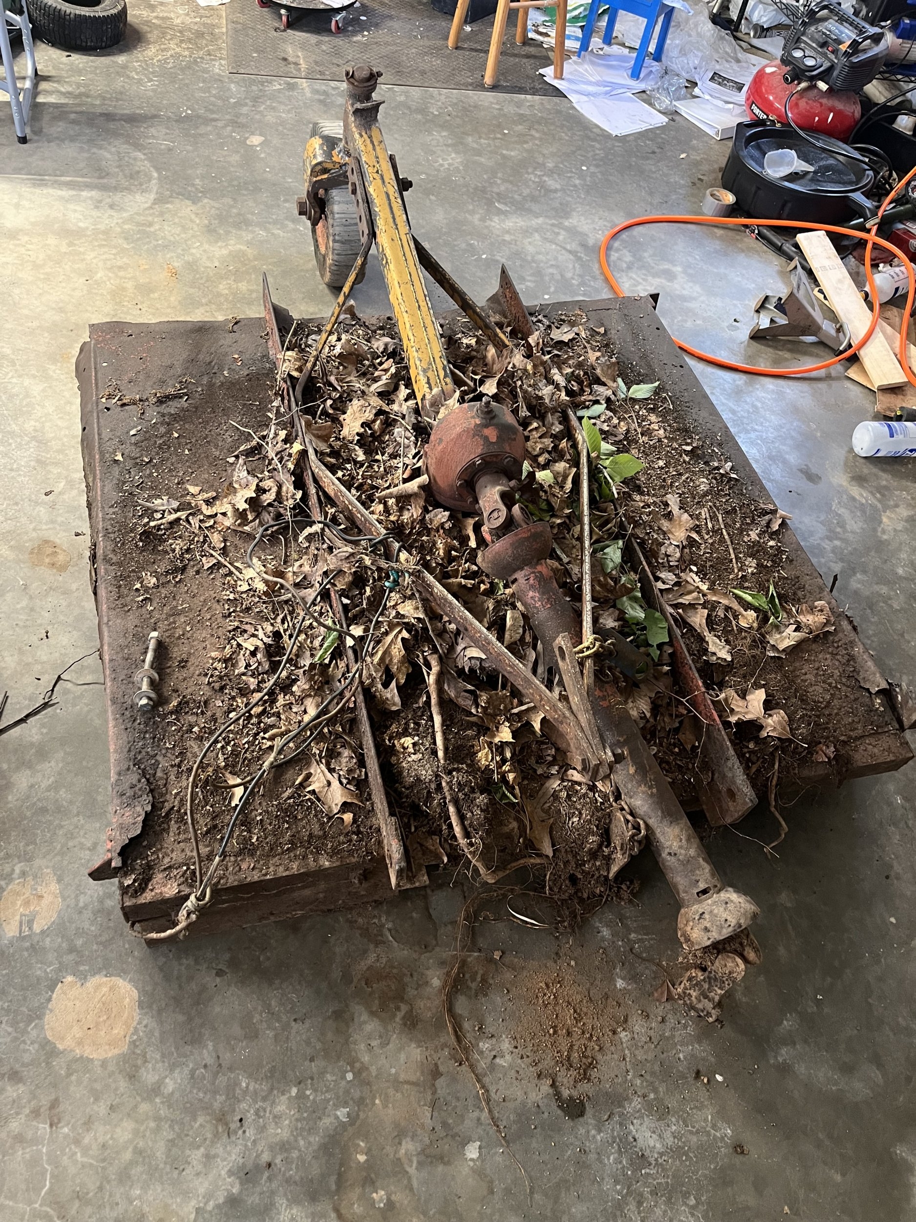

Neighbor had an old Long Manufacturing rotary cutter half buried in the woods behind his house.
I pulled it out and brought it in the shop. New gearbox and PTO shaft, sharpened the blades, and a coat of paint. About $300 in parts and here’s the end result. Before and after:

Not sure how you posted the finished pic.
Nice clean-up and repairing.
I pulled it out and brought it in the shop. New gearbox and PTO shaft, sharpened the blades, and a coat of paint. About $300 in parts and here’s the end result. Before and after: View attachment 875528
Nice cleanup job!
If you want another project mower I have a candidate for you. Consider the barbed wire spooled up underneath a bonus. 😆

Are the front corners of the deck cracked? It would seem like something to weld up, and possibly reinforce, before painting.
