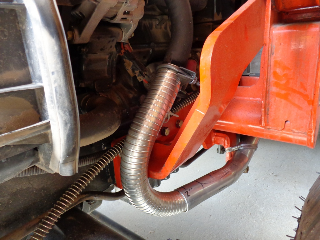

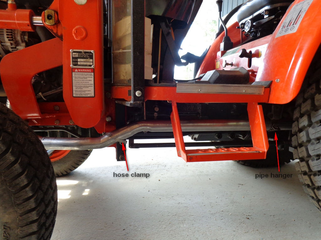

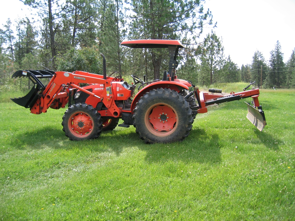

This is how I eliminated breathing exhaust and having it blow up dust in my face.
The piece of trim above the step I installed to keep the floor mat in place because I kept hooking it & pulling it up with my toe.

Nice idea. What kind of flex tubing is that? Where did you get it?

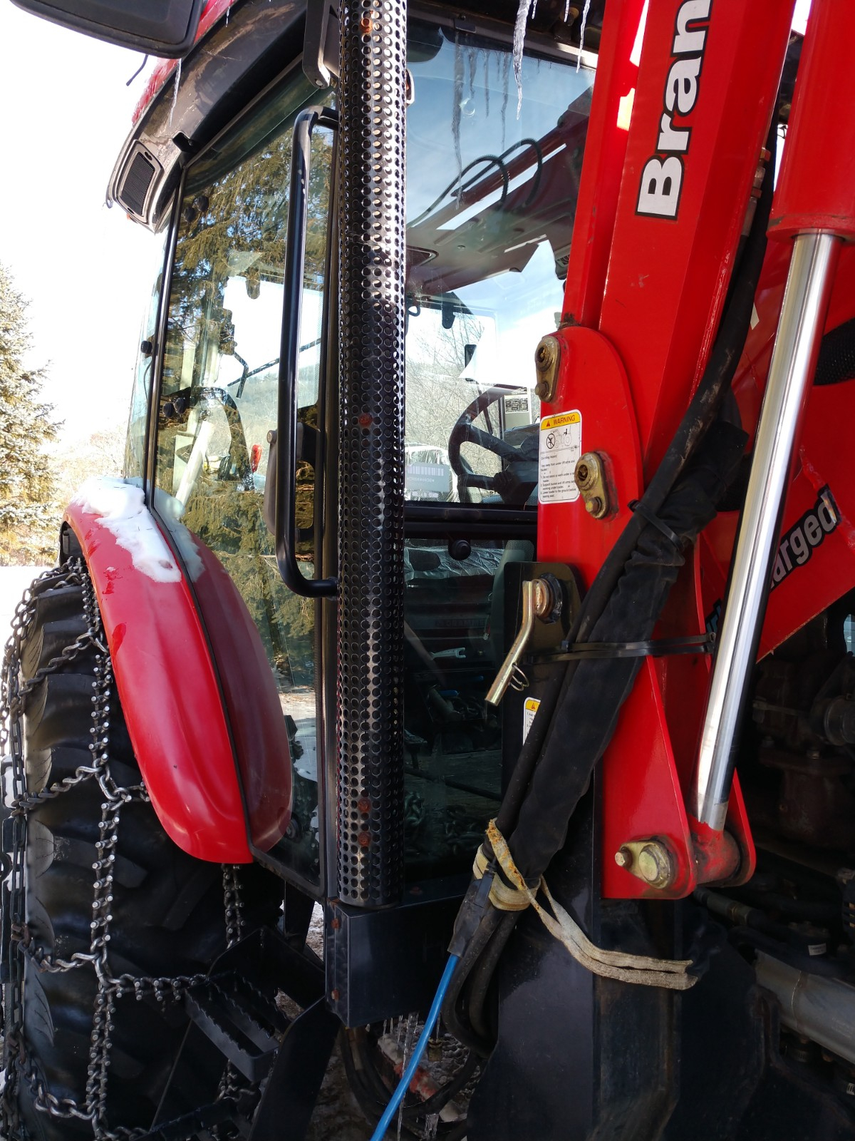

Strange - the exhaust on my M6040 is vertical with the 90 degree tip pointing straight forward. I've never had problems with the exhaust. Maybe I'm just numb because I'm so old.
Mine is the same on my M9 cabin tractor but my M9 open station has the optional low dump exhaust which exits in front of the left hand side operators platform and neither one bothers me at all. I did completely remove the over the engine mount muffler on the cab tractor in lieu of a straight pipe (had to have the local exhaust shop bend me up some piping) which I welded together here at the farm.
With the turbo charger it's plenty quiet enough for me, besides I like the sound of a straight piped turbo charged diesel engine. Just loud enough not to offend anyone but not dead quiet either. A turbo charger is considered a muffling device anyway.
