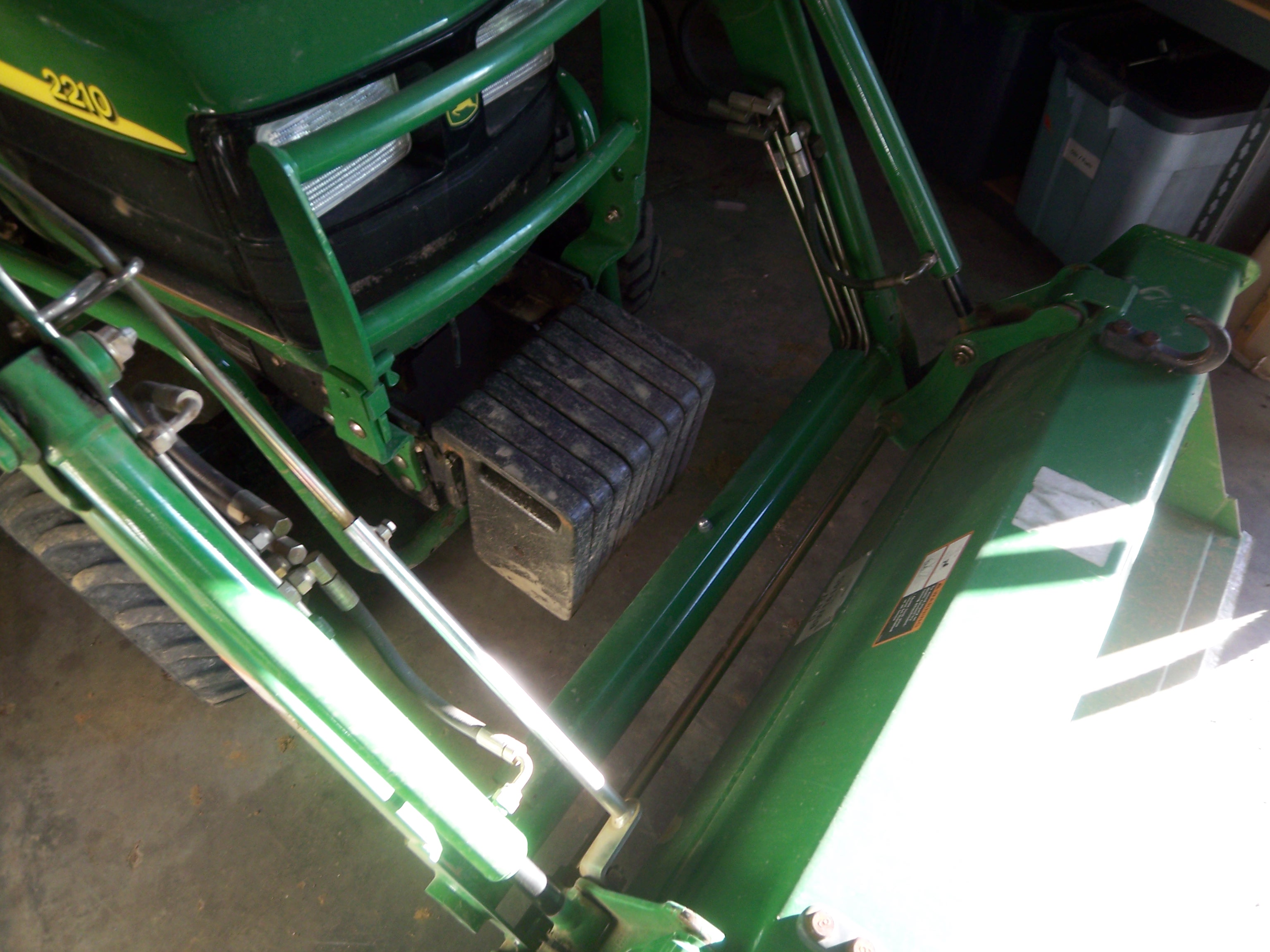

   / required ballast w/647 tiller #4
JG Joe,
Suitcase weights are one of the best improvements I've made to my 2210 period. I spend a lot of time with the loader off and front weights almost become a necessity for me. Regardless, they dramatically improve handling with the loader on too. They give the front tires a lot more purchase when doing heavy work and really help with the steering too. I used to lose traction, now there are times I run out of power first. It's almost a poor mans version of a bigger tractor.
FYI, I've actually got "Ariens" brand weights from my local JD dealer. The 2210 fits eight of them nicely @ 35lbs each and they don't interfere with anything.
JC Joe
