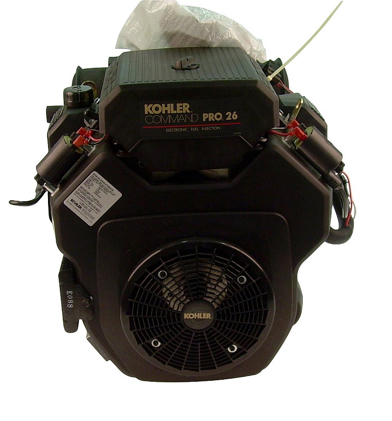

Here's a really good engine that be really cool to Repower a PT-425 with.
26 Horse Power and FUEL INJECTED!!!! :D (I'm a sucker for Fuel Injected Gasoline engines)
/ repower #47
We've talked about that one before. Configured properly, it should be a drop in replacement for the Kohler 25s in the older PT-425s. The main problem is the price. IIRC, it is significantly more expensive than the 25 horse model.
