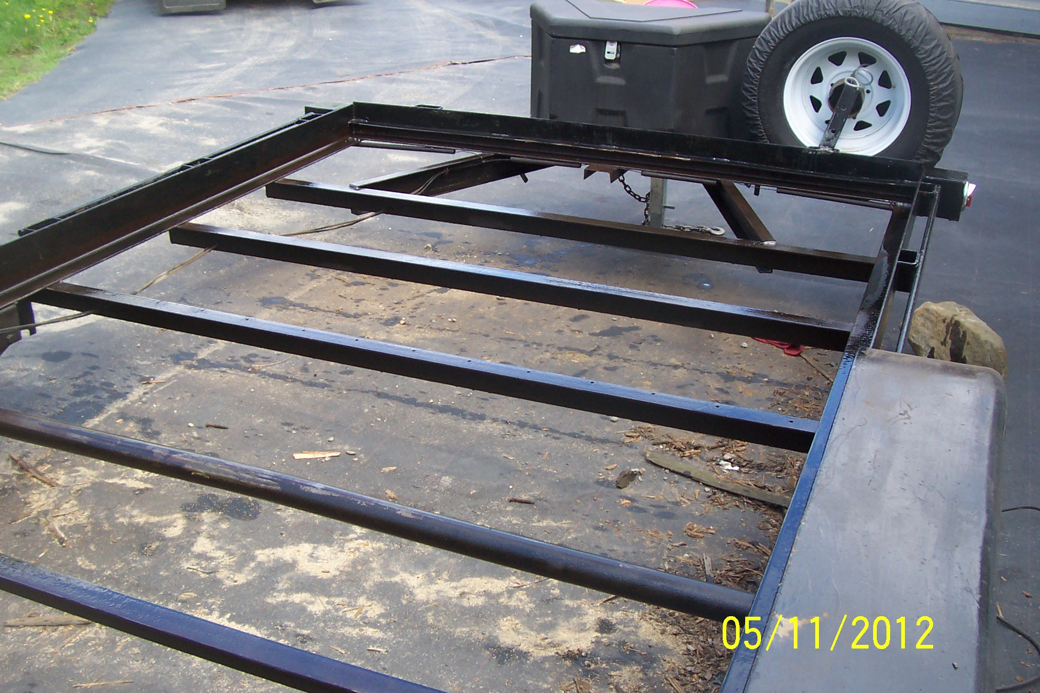

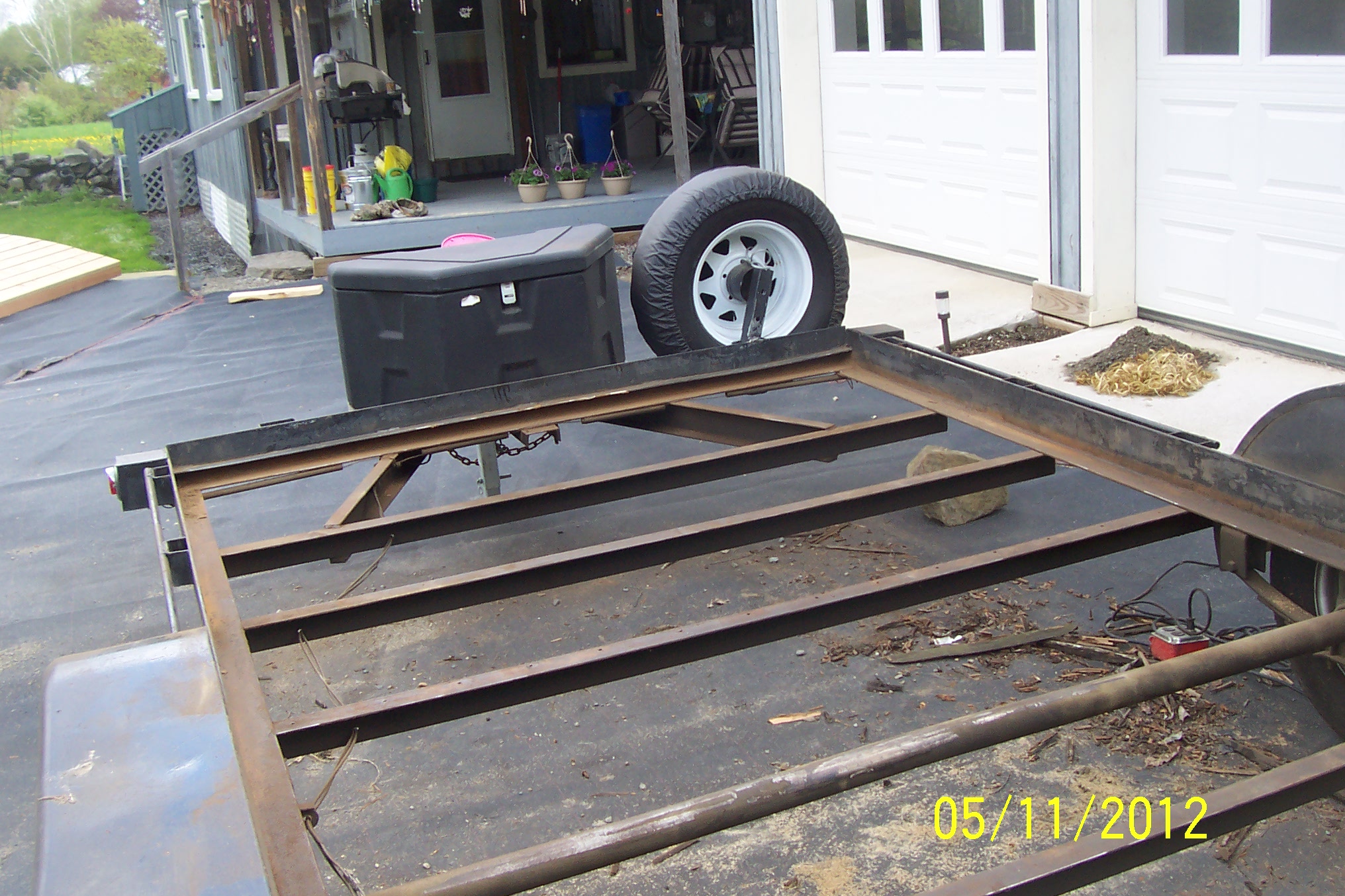

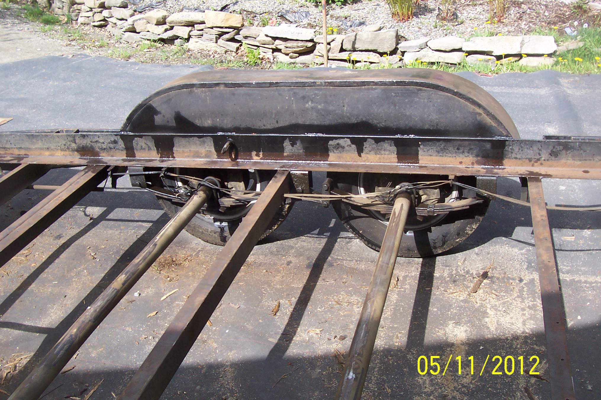

HI GUYS ,FINALLY HAD TIME TO GET BACK ON :ashamed:
first pics trailer stripped

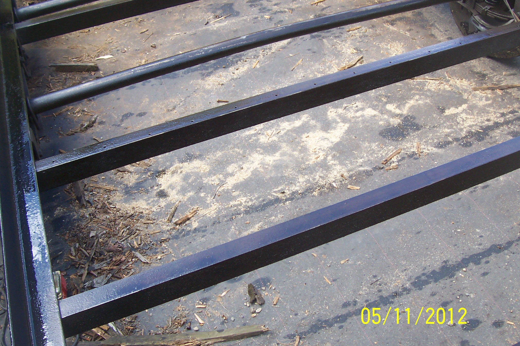

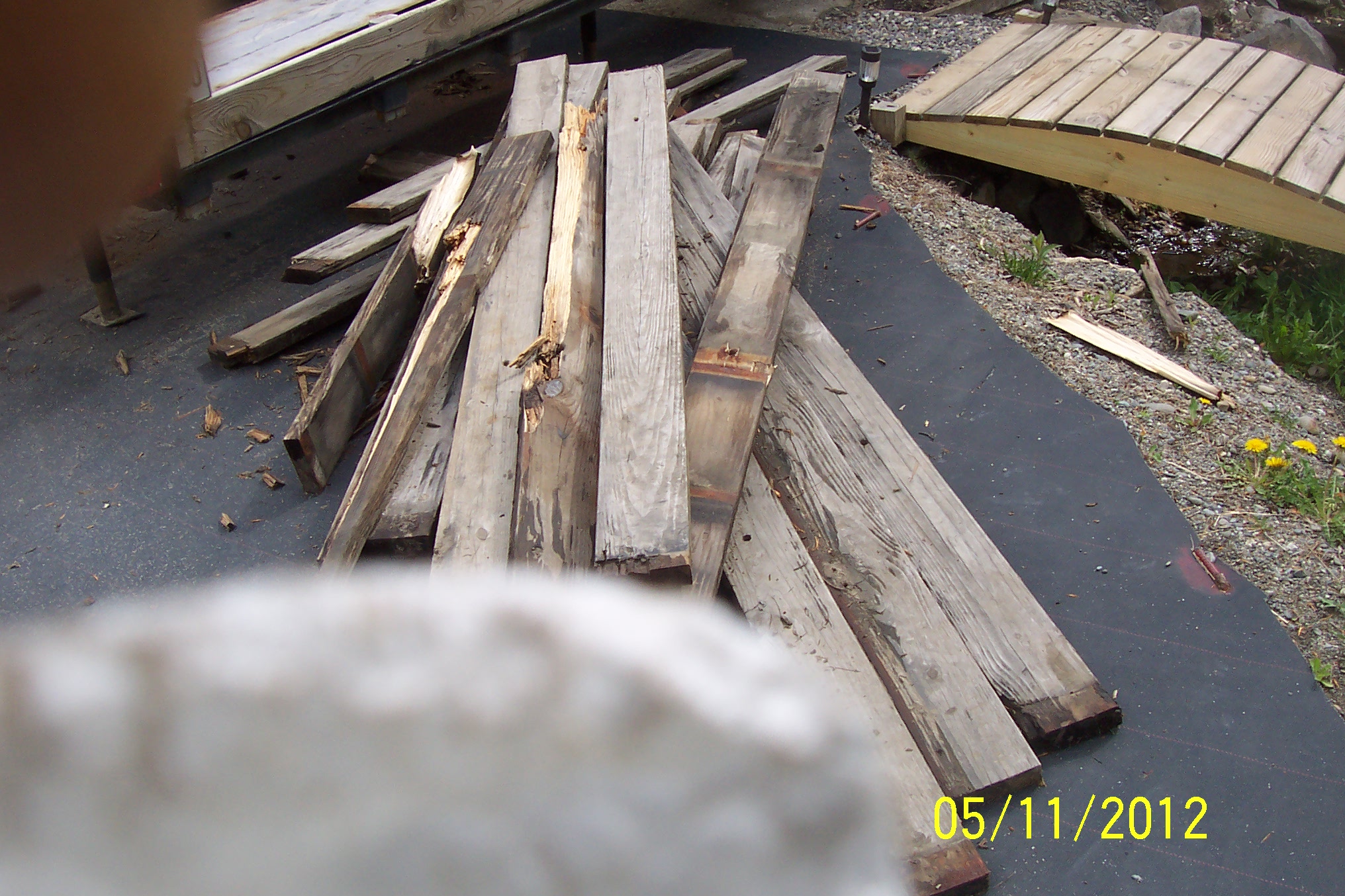

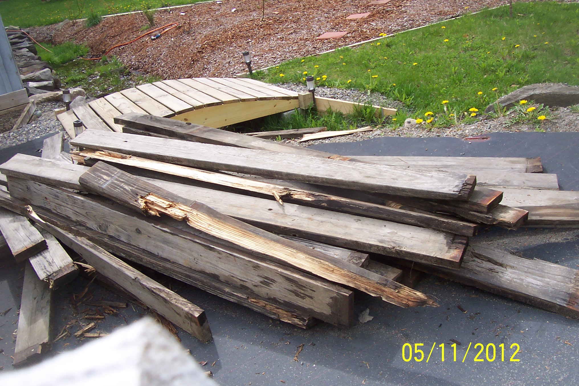

Heres a couple of whats left of the 7 year old wood.Ihad put linseed on it every year too:confused:

after applying liquod gold:)Did you notice how nice the frame looked ,ive done it several times in recent years.Undercoated first couple,but it would peel off.This works well

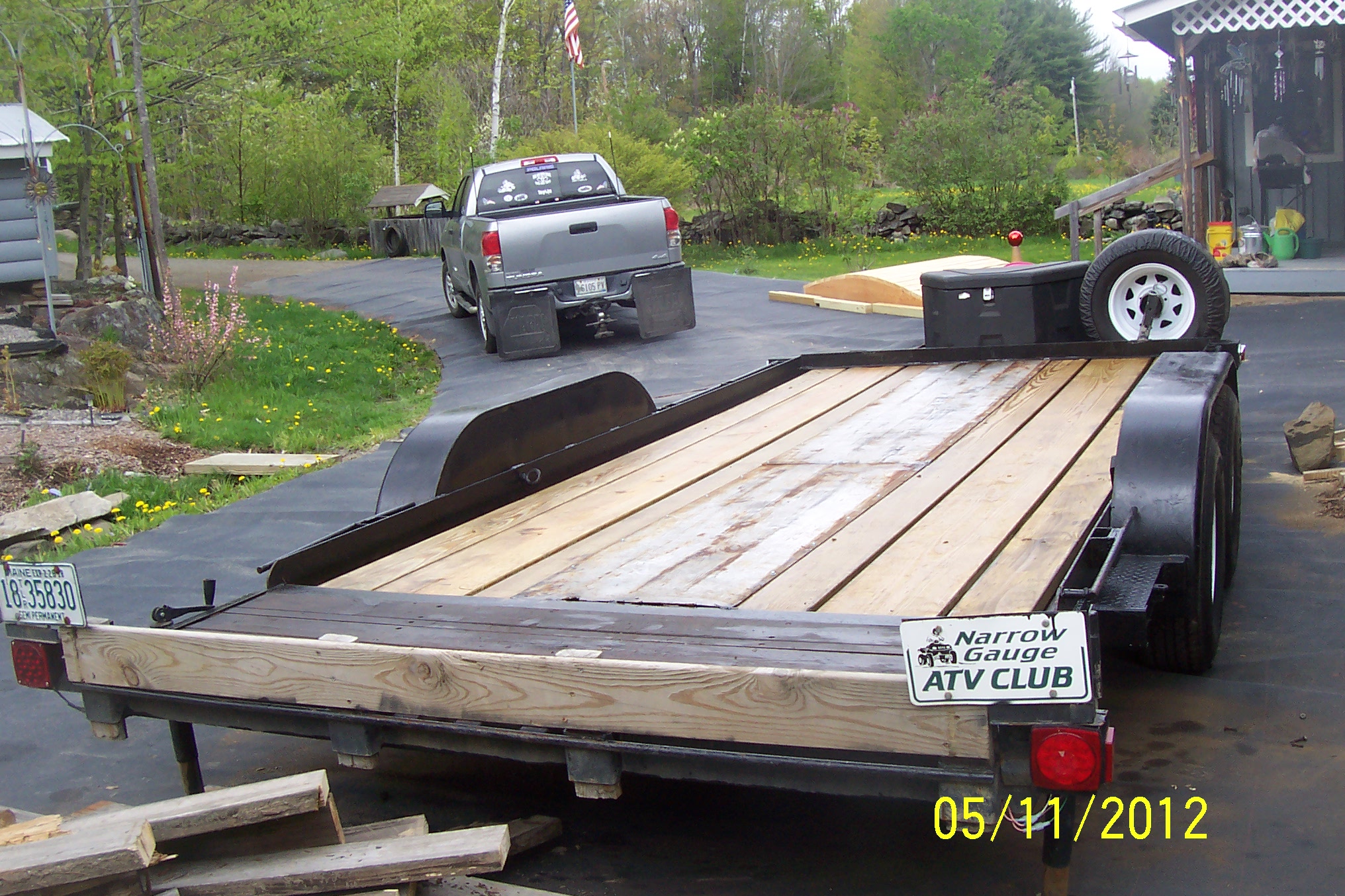

#49

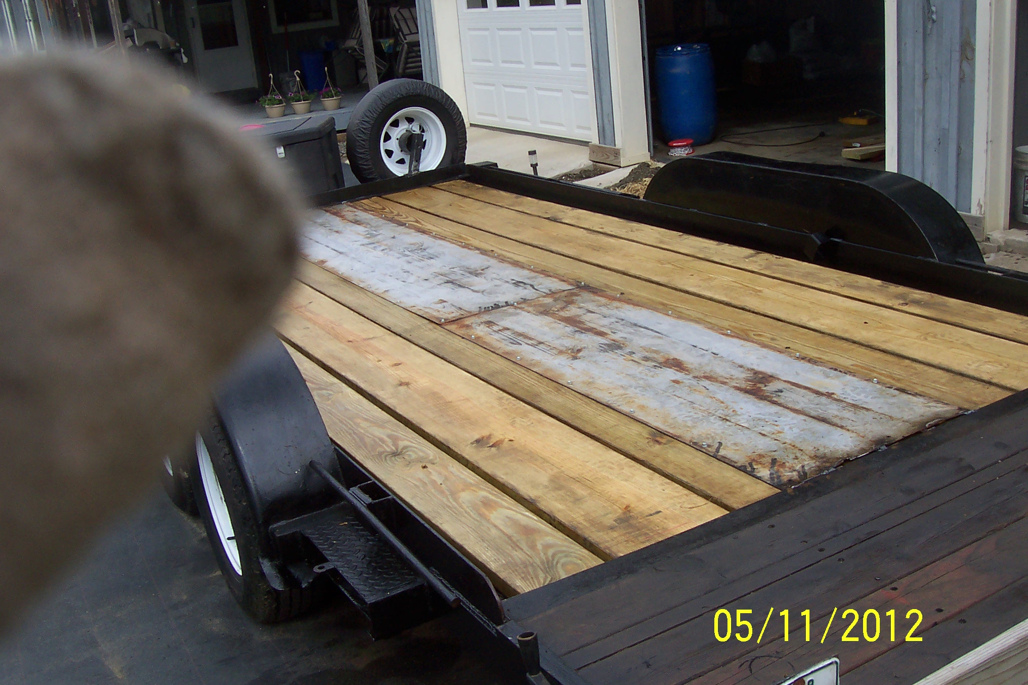

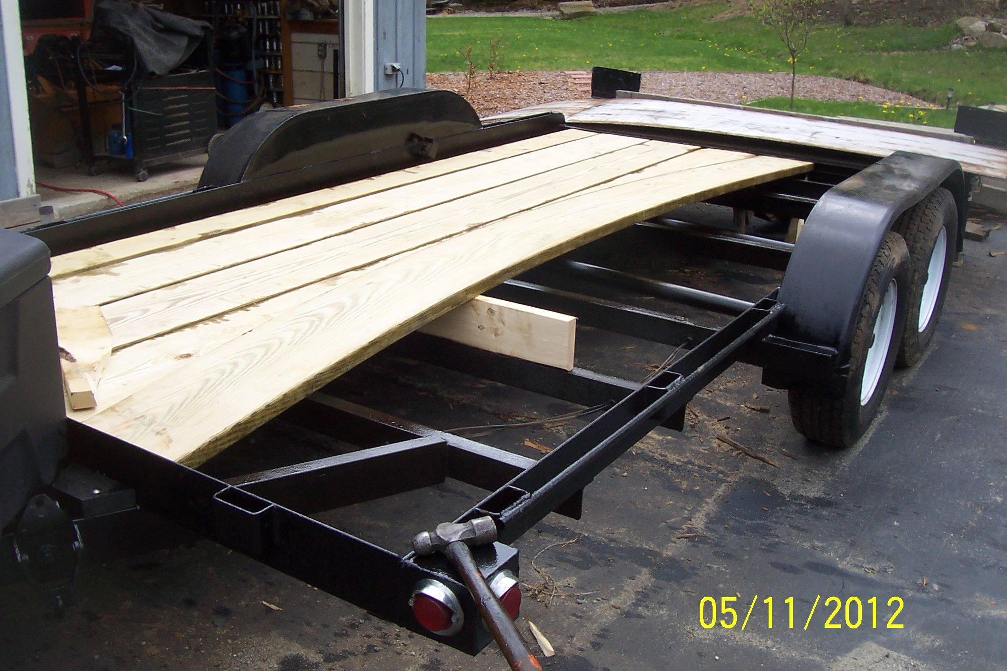

I decided to leave the side frame exposed and start the planking at edge of it.This allows me to keep it protected ,without a plank on top of it.If your sideframe rots out,your done for.note i applyed my treatment to sides ,ends and bottoms of planks
/ replanking my trailer question
#50

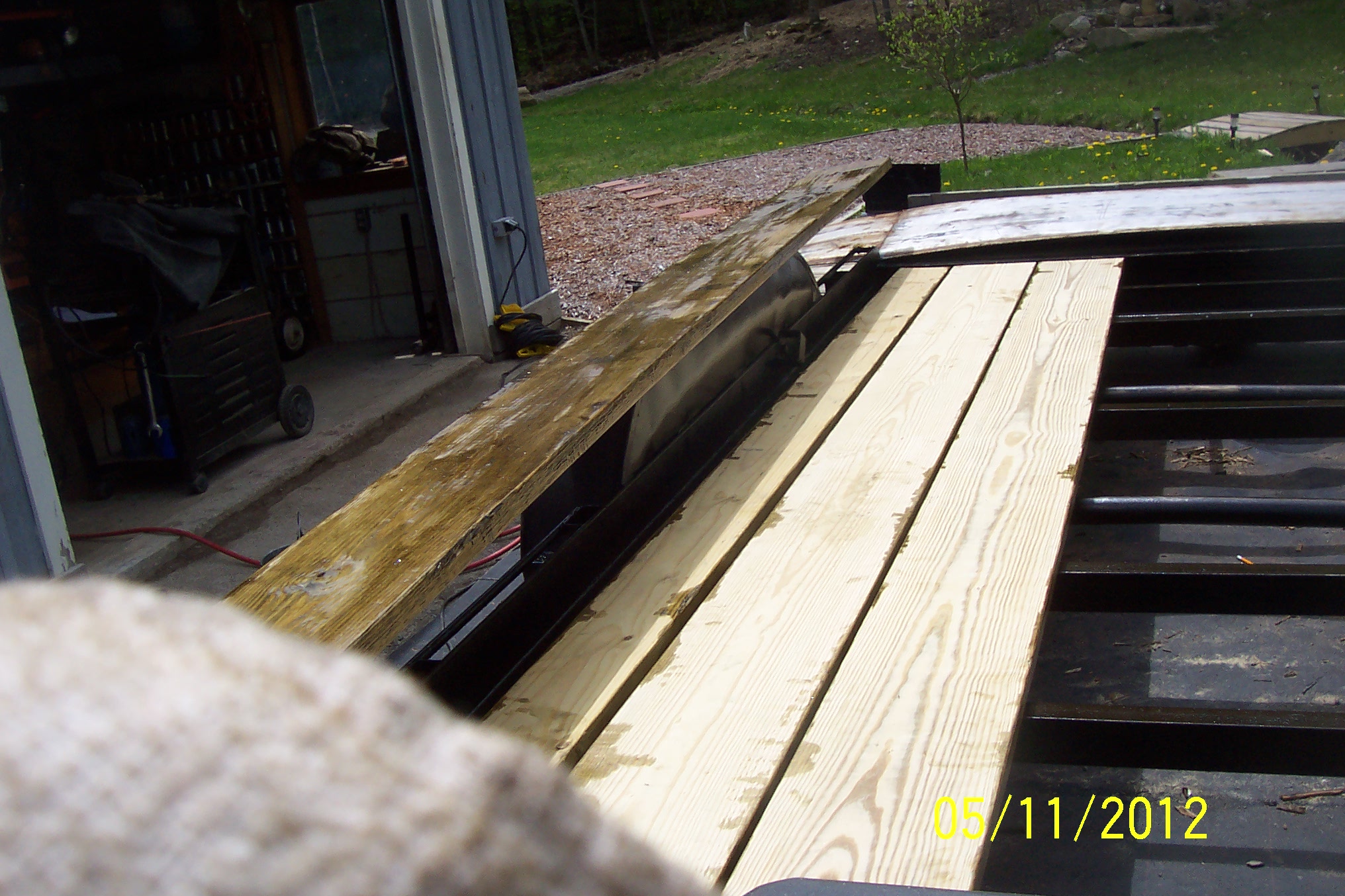

i spaced them about an inch apart.Thanks to my friends here on TBN,i learned how to install them
#51
applyed it to the top,and wiped the excess.

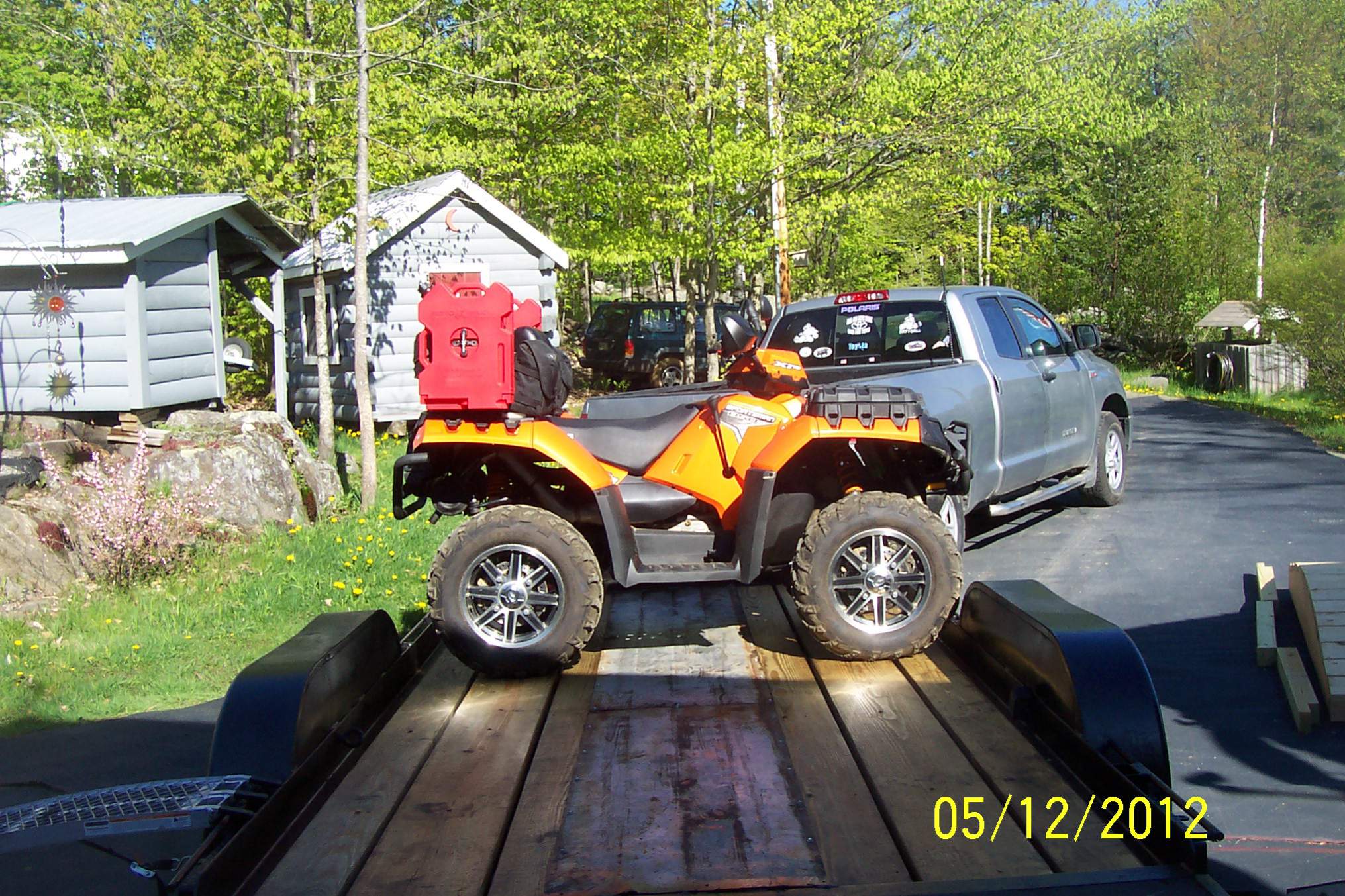

One more,can you guess what the metal on top is for?

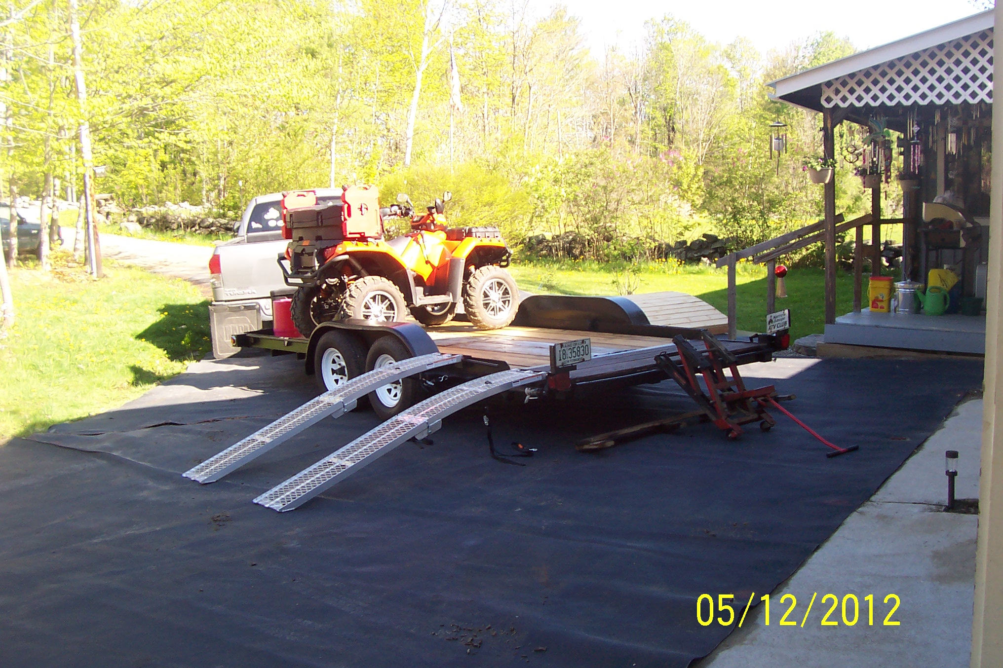

It is for my rolling atv jack,works good

Looks great. Glad the board trick and knocking it out with a sledge worked for you. Its a time saver.
Chris

Looks great, I like the way you load ATVS. Ever been stoped, for red lamps, on front corner of trailer? Or backwards tool box ?:laughing::laughing:
