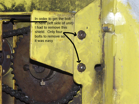

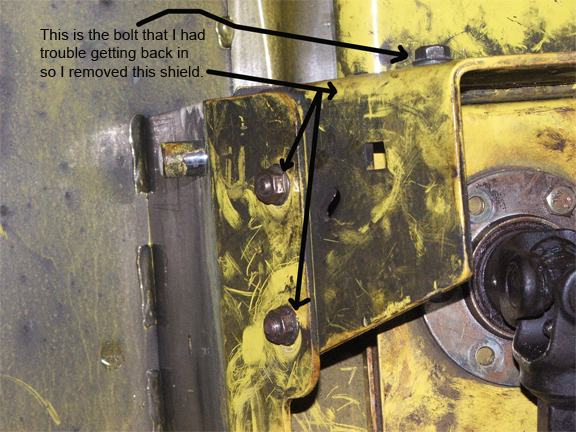

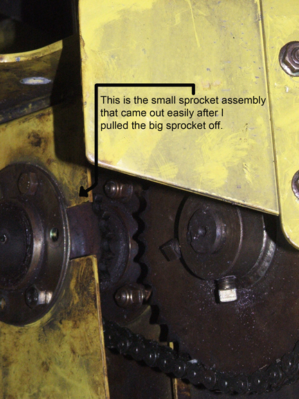

Got the new chain on. Had to remove the big sprocket and then the small sprocket housing came right out. It all went back together without a hitch. Ran it tonight for about 2 hours and it works fine. Thanks again for all the comments.

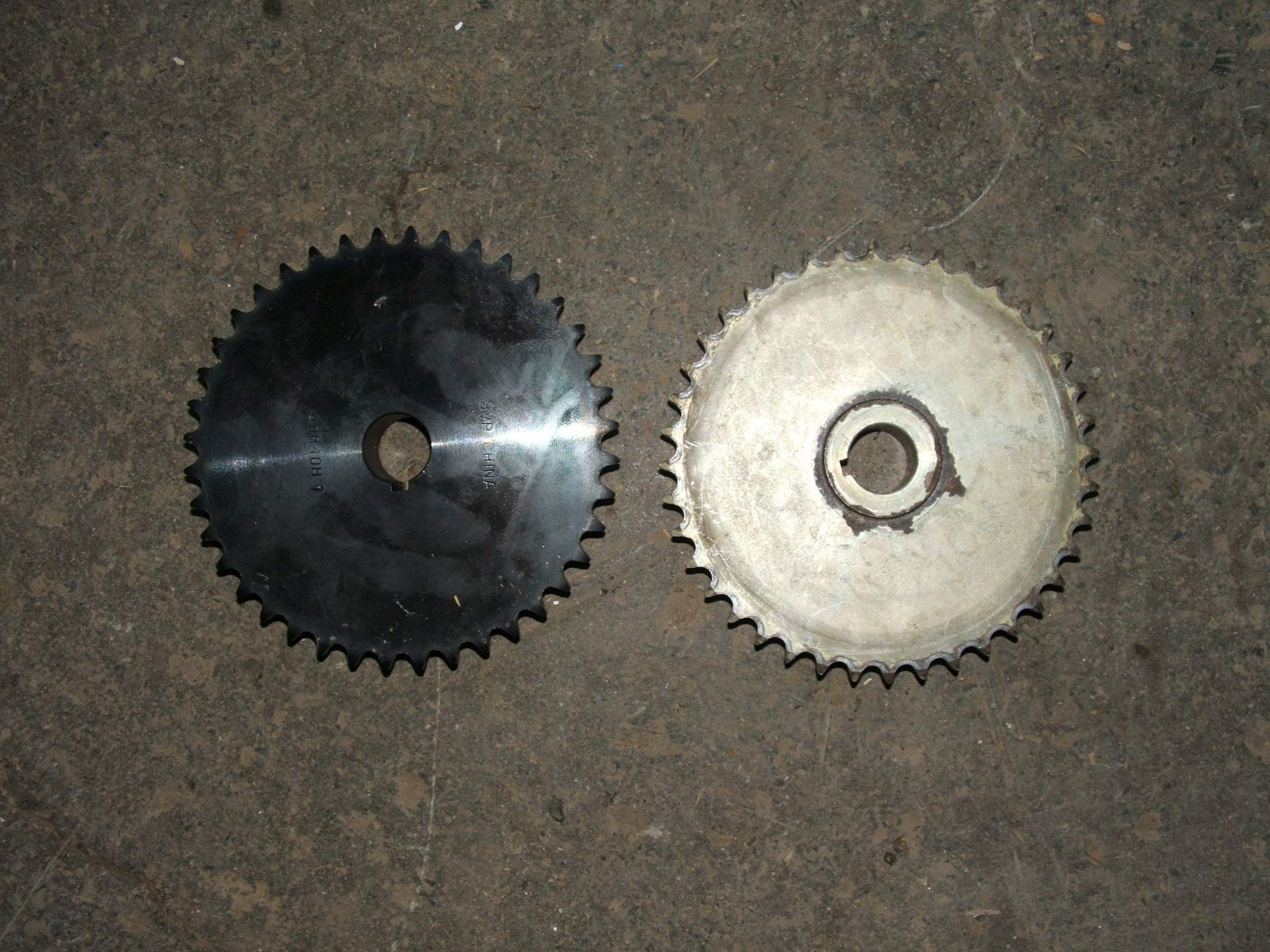

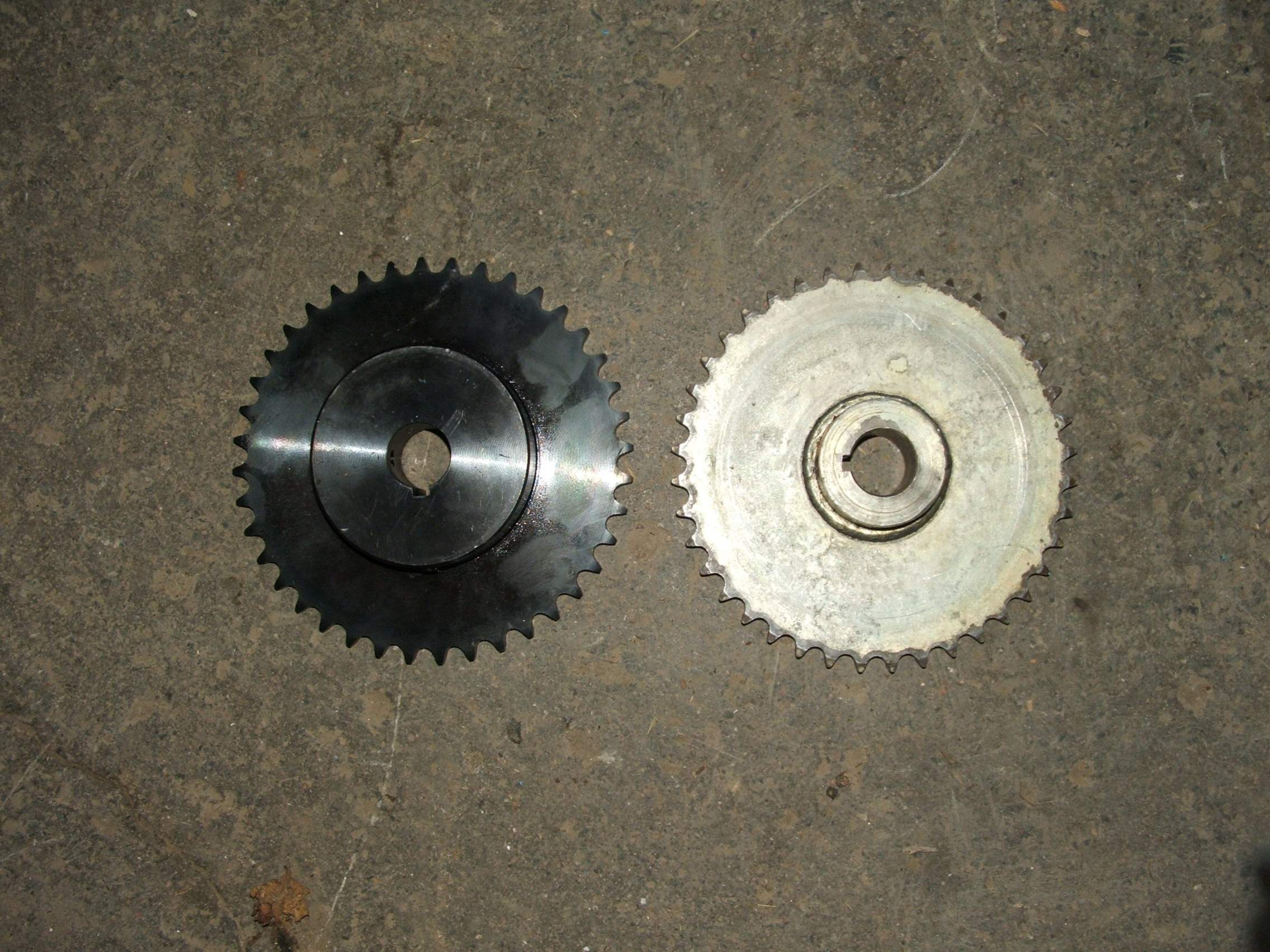

Ok, so here is a follow up on the large sprocket I brought to my dealer. Sorry I'm a little late, but you know how it is before Christmas. Just a quick recap, The large 40t sprocket on my 47'' blower was wobbling side to side, possibly cause by a bend in the sprocket and also as mention by Turbo36 the inside bore of the sprocket seem to be a little large for the shaft. All this made it hard to adjust the chain causing it to be very noisy. Took it to my dealer hopefully for a replacement on the warranty even though the warranty is issue. Well apparently the sprocket was not bend enough to justify a replacement and the inside bore of the new sprocket they had was the same as mine. I decided that the sprocket had to be change but JD was asking $126.00:confused2: So I went at a bearing dealer and bought a sprocket for $38.00. This sprocket is machine in one piece instead of the original 2 piece sold by JD. It is nice and strait and further more, the bore is the perfect size for the shaft. There is absolutely no more loose on the shaft.:thumbsup: Made sure that both sprocket were well aligned and tight everything in place. Also took the time to replace the chain. Now it is much easier to adjust the chain. Still have some loose on the chain being cause by the small sprocket shaft that is also a little crooked. (Don't know who makes these parts for JD, but not impress at all.):mad: All in all, I have eliminated 75% of the slack and noise of the chain by doing this fix and would recommend it without any hesitation.:thumbsup: Here's a few picture of the old and new sprocket. The new one is black and you can see there is no welding on it.
