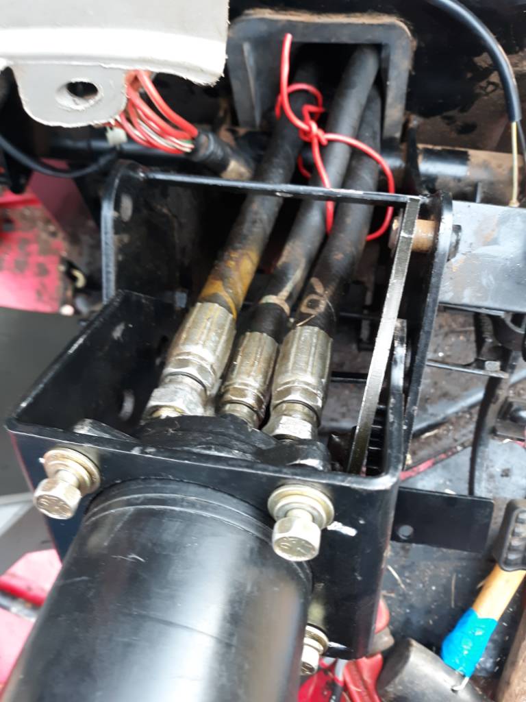

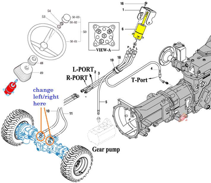

Let me see if I'm understanding. You're saying that you traced the left/right steering hoses down to the front axle and it appears that the hoses at the HSU are the opposite way? Did you mark the hoses/connections prior to removing from old HSU? If so and you connected L-L ; R-R; T-T (return line) & P-P (pressure) you should be good to go. If your OEM unit was a "-01" and the new unit "-02", the bottom of the new one may have a slightly different hose arrangement (left/right etc.). I never saw my OEM as it changed out by the dealer.

Pic shows PSU and hose fittingsView attachment 591047
Is that the new HSU mounted? From what I can see, it looks like it's connected right. If after you get it all put back together, started and you turn the steering wheel left and it turns right, do this (see diagram) swap the connections left to right on the steering cylinder! It's lot easer than tracking down m-f & f-m adapters or tearing your dash etc. all apart again (until you have to repair/replace HSU again)

Okay. The two hoses run down right center then longer one crosses over to left side. Don't think shorter one reach there. Could run it down left center but that may be more trouble than changing at PSU base
   / Replacing Power Steering Unit on 5010 / 2555
I marked hoses but was somewhat relying on memory. When I had trouble getting last hose to fit up I convinced myself I had it wrong. Think long- think wrong. So I traced out hoses and messed up. Drove tractor. Not fun to steer. Only need to swap top right and bottom left looking from top. Middle one is hardest. Can't do it last so I'm glad it's good

The reason it looks right is because I pulled top right hose out from left side and back in on right side of bundle
