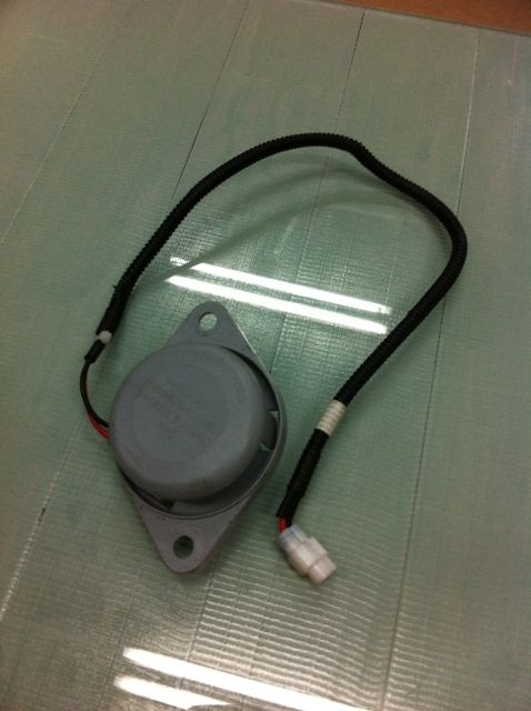

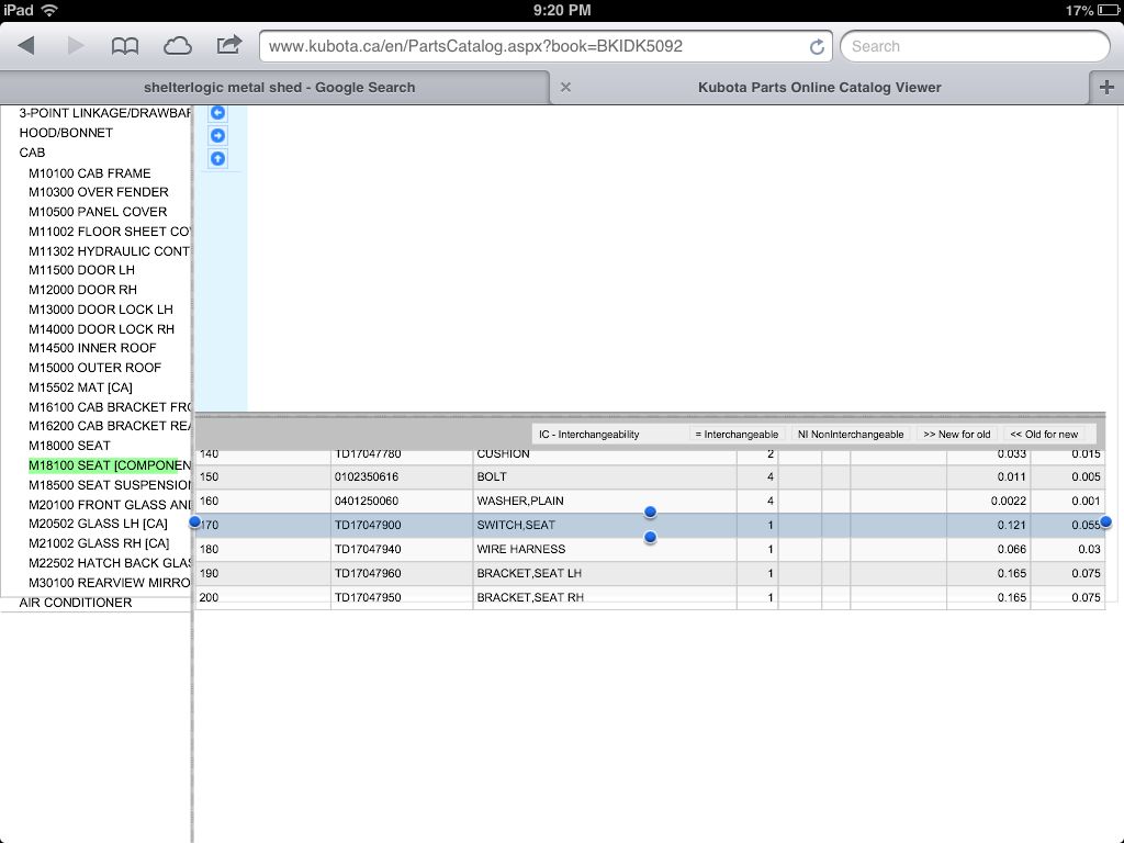

Would this be the switch your referring too?
I had no trouble removing it from my 5740. When I did the air ride seat conversion I removed both switches and the then new original 5740 seat ended up in an old Zetor tractor. The Zetor didnt need the switches so i plucked them out. I can't remember how I removed it but it was uneventful.

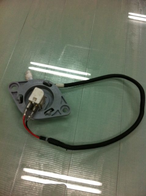

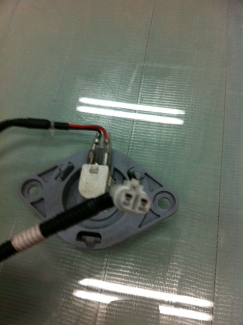

I just had a quick look and the only switch I see is in the photo :confused3:
That does look like the switch. I'm going to take that part number you have highlighted and see if I can find it in Messicks
That is the right switch! I wasn't looking in the right place. I was looking at the 'seat' and not at the 'seat components'.

Thanks for the info. Do you still have the switch? Would you be willing to sell it (cheap)?
   / replacing Kubota L5740 seat safety switch #7
I'll still need to figure out how to get those 6 screws out of the bottom of the seat.
Yup. I still got the switch. I had just snapped those photos for you when I saw your post. Check with your dealer first. Might be cheaper to buy fom the dealer than ship from Newfoundland, Canada. I took those two switches off in no time. I may have removed the seat bottom. Just can't remember now. It's been two years since I installed the air ride seat.

Messicks has that switch for $67.70 and I'm sure there would be some shipping.

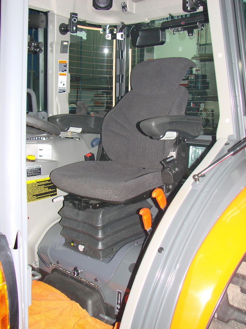

That's a nice looking seat you have there.
Wish I had a cab, especially after spending about 16 hours in 95* sunshine the past 2 days.
