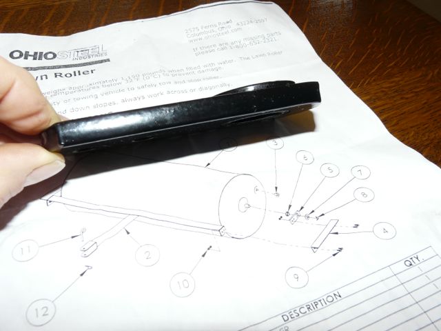

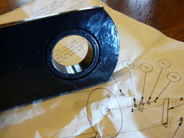

I bought an Ohio Steel Roller and on part # 5, I want to replace the pressed bushing with a bearing. Can it be done. How?
Note (#6 on the diagram is pressed into #5)

Google 'flanged bearing' Flanged Bearings (2-choices) - VEX Robotics
you can also use 1" Four Bolt Flange Bearing
These are just sites that I found with pics. Without knowing what size axle, bore, how much the roller weighs, etc it is difficult to recommend something. You could also replace that black bracket with something machined to fit a true bearing better.

Sure, you just need to press the bushing out and find what you want to go in. If you have something like american bearing close by, they should be able to fix you up.

Excellent question, and I don't know the answer. The weight with water on the 60"X24" roller is 1150 lbs. and my road and track going up and down would be a 1.5 miles. To me it seemed that since metal will be rubbing on metal it would wear out quickly especially if I spend a day rolling down hog damage. I guess I should try the bushing first and see if there is any noticeable wear after a day. The way the description of the roller was written I thought it came with bearings, roller bearings. I know now the definition of a bearing also covers a stationary bushing. Live and learn...
I could have a problem also installing the "roller" bearing because the shaft extends out the side only 1".

Your bushings will last forever if you keep them lubricated. If you aren't worried about high speed and maximum efficiency, the large surface area of bushings make them a better choice.

IT is most likely a self-lubricating oilite bushing anyway. So no maintenance should be required. If you try spraying oil and stuff on it yourself, all you will probabally do is create a mess that dirt and other debris will stick to and wear things out faster.

A self lubricating bushing. Wow, I have never heard of them but I googled and there they are. The bushing that is pressed into the steal is painted steal so I don't think it is self lubricating I also thing they would advertise that it is.
This ares is very very sandy (think beach) that an added oil lubricator may make the sand stick to the bushing area, (?) and the edge of the steel bar is not wide enough for the installation. I guess I would have the same sand problem with a greased roller bearing also.

This application requires a bearing that will take a substantial radial load (for it's size). For this purpose a ball bearing would not be my first choice. They are really meant for large thrust loads and smaller radial loads. In this case, I think a bushing is a much better solution for cost, low maintenance and durability.
/ Replacing bushing with bearing #20
Not much to add. I agree with leaving it as is. Dont spray it with wd 40. light oil every now and then wont hurt it(in my opinion) I would wipe both out side edges free of dust and caked on residue.Then just a few drops of light oil on each side.
