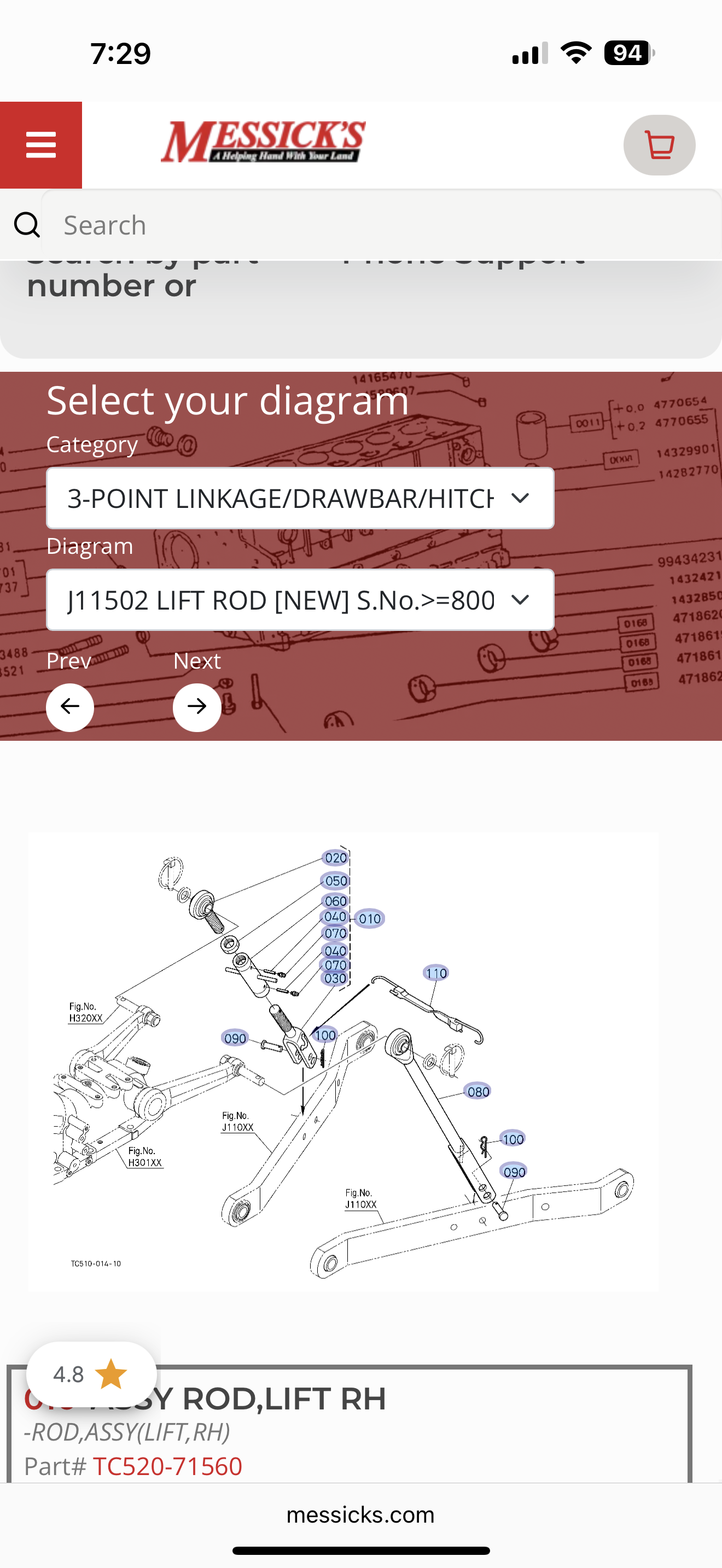

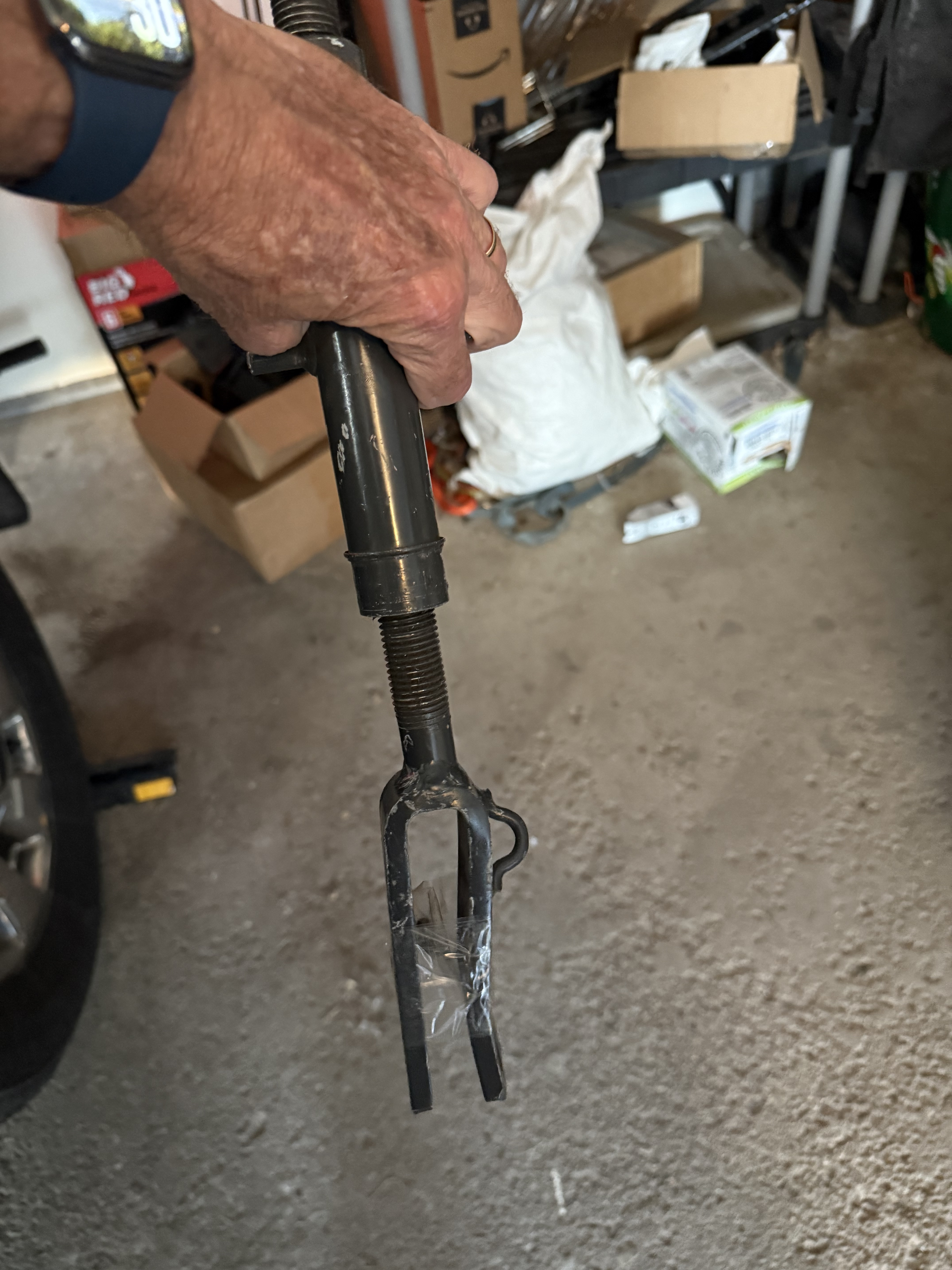

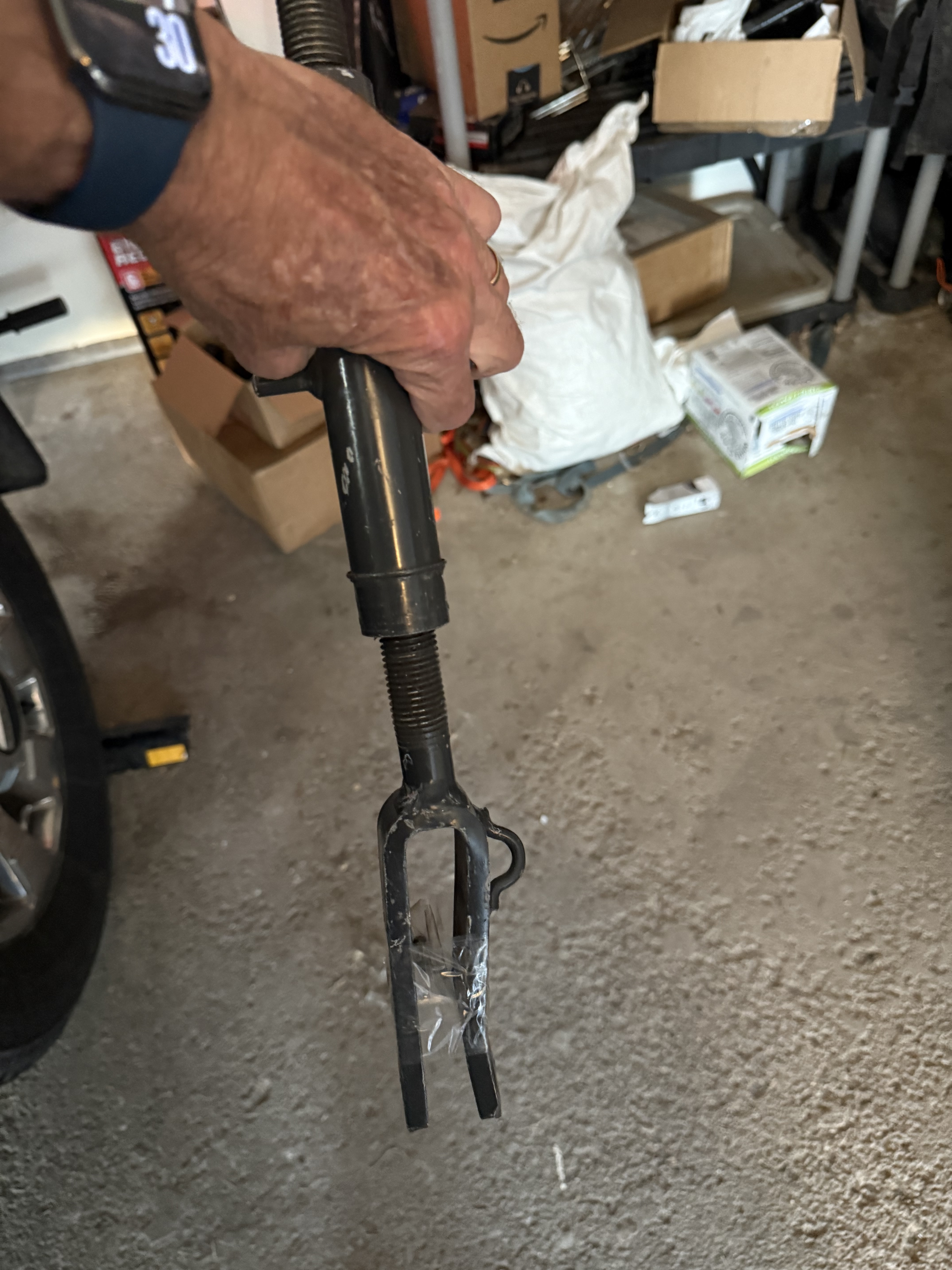

Has anyone replaced the bottom part of the adjustable lift rod on an L3800 3?point? I bent the lower portion that screws in for adjustment. Messicks sells this part. I bought it. It looks from the parts diagramed this lower portion is pinned in. I need to remove the old bent lower portion. Anyone done this?
Thanks

Images of bent lift rod and parts diagram from Messick’s related to question above.

Yea, so the threads of your lift arm are bad... Look on the diagram from Messick, #70 I think is a screw, then you need to punch out #40, spring pin (or rolled pin).
