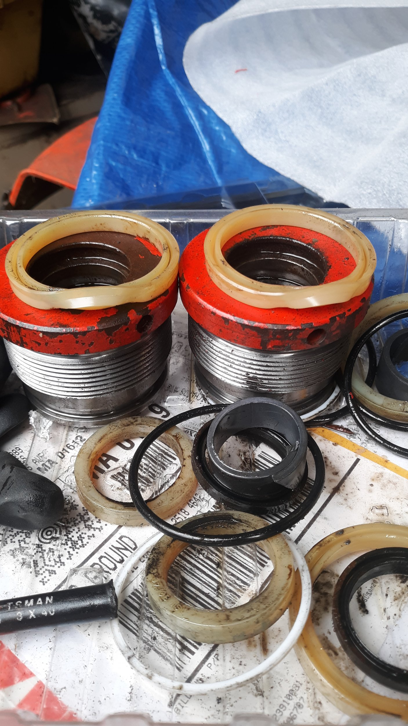

Update, The piston cylinder end caps do have some rub wear from the bent piston rods. I know that I could clean them up and they will seal fine but decided since everything moving inside is going to be new that I will replace the caps for another $121.00 for the pair if the place honors their prices. Total parts comes out to $657.79 + shipping if the advertised online prices are correct. If not, then the price is more like $764.02 + shipping to rebuild both cylinders. Either way that price is cheaper than the cost of one new cylinder at $846.02 + shipping. that price is not much more than to pay a company to rebuilt one cylinder. Time to be a little bit more careful. It was simple to take them apart right on the tractor. I disconnected the rod pin and blocked up the pistons. Using a spanner wrench the end caps loosened right up. The two outer tubes show no internal damage and a straight edge on the outside shows no bending of them. Now to order my parts in the morning.
/ Replacement tilt cylinders for a KL6010 loader.
Michigan Iron & Equipment got my order for all my parts to repair my cylinders. All the parts are in stock at the warehouse. I'm having them drop shipped directly from Kioti in N.C. to me to cut down on downtime. My parts should ship out today and arrive on Friday. Looking forward to warmer weather now that Spring has arrived.
Parts arrived at 2pm yesterday and my tractor was back together by 4pm. The bucket curl works so much faster now than ever before. Two of the seals were flipped over. I'm thinking that this has been this way since new. Total cost was a bit more than expected. The cost was $959.02 to rebuilt both of them.
