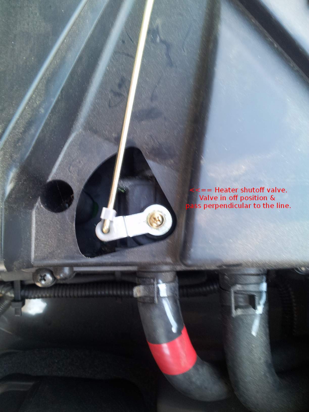

I got the cab heat working just before the next big snowstorm. The problem was not an air bubble or the thermostat, it was a bent cable. Lucky before I touch the thermostat I timed how long it took for the engine to reach operating temperature in the morning. With outside temperature 18 degree the engine reach operating temperature in less then 5 minute so I decide the thermostat was fine, good choice. It took me about 30 minute to pop the top of the cab, not too bad for the first time. After looking over the heater setup I noticed the shutoff valve for the heater in the off position even through the heat control dial was turn all the way to high heat. After look over the heater control linkage I found the bent cable at the cab heat control dial.

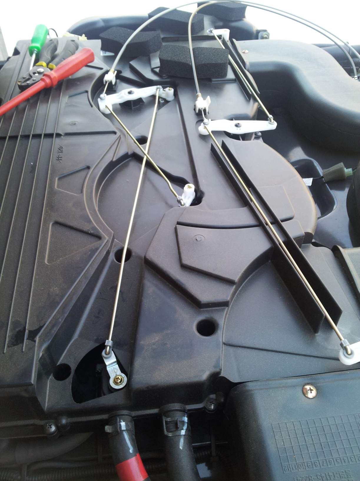

It appears the reason the cable bent is if the heat is turned all the way to cold it caused the heater shutoff valve lever pass the shutoff position or pass perpendicular to the hose. When the dial is turned to cold the cable is pulled, so when the dial is turned to heat the cable is pushed. When heater shutoff valve lever pass perpendicular it takes more force on cable and heater levers to move the shutoff valve back to the on or heat position. Over time this weaken the cable at the dial end until it finally bent. I came to this theory after straightening the cable and operating the heat/cold dial back and forth between cold and heat. If the heater shutoff valve lever got push passed perpendicular when turned to cold when I attempted to turn the dial to heat the cable bent. I ended up adjusting the cable a little and adding a stop at the heater shutoff valve to prevent it from going pass perpendicular. This appear to resolve the issue.

In my hurry to close the cab before dark I forgot to get a picture of the stop. I had do the work outside due to the height need to open the cab top. As far as the cable length I don't know. If the cable was stiffer at the dial end I don't think pushing passed perpendicular on the valve would be an issue. If the issue occurred again I would remove the cable and solder or braze an inch or so of the cable to stiffen it up. I would use a vise-grip as an heat-sink just before the cable housing to prevent it from melting.
