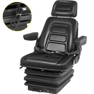

Guys, I’ve searched but not pulling anything up.
I’m trying to find a quality replacement seat for a Grand L 3130. Can any one recommend a quality seat?

OEM Kubota seats are stupid expensive.. and not worth the price.
I had to replace the seat on my Open Station M9. Bought a cordura covered Talon seat with adjustable lumbar and armrests from Rural King and then ordered a new low mount suspension from K&M (they also sell seats including Grammar). Seats are all made to ISO specs today so the mounts on any seat will align with the holes in any seat base. 100% bolt up and that will include a self contained air ride seat base if you want to go that route. The air ride seat bases (with self contained 12 volt compressor start at about 1000 bucks. I went with adjustable spring suspension, much cheaper.
I have the full Grammar air ride swivel seat base and Grammar cordura seat with armrests and lumbar plus the swivel base in my cab Kubota, came with it new.
For me, Rural King has the best price on Talon Seats and K&M has the best price on seat bases.
I dislike the vinyl covered seats Kubota comes with. Vinyl seats = a sweaty butt on a hot day. I don't do sweaty butt well.

Lets see, I paid 150 for the Talon from Rural King (delivered) and 125 from K&M for the spring suspension, delivered. If I was ever to replace the Grammar in the cab tractor, it would be with a Talon. Personally, I find the Talon to be much more comfortable than the Grammar. Like I said, they are all built to ISO specs (mounting arrangement) today so they all interchange.

Interestingly, the seat depicted on the Grammer supplier site isn't the seat I have in my M9 Cab. Mine has a built in adjustable headrest and there is no cutout in the front either. Maybe they changed the design.
