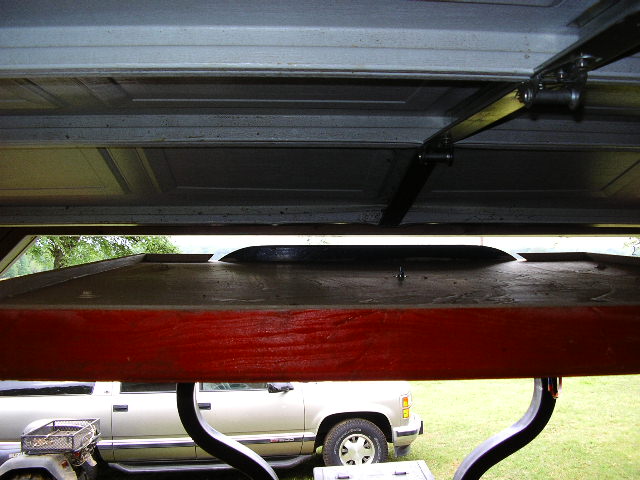

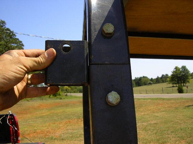

OK if you just want to shorten the standard rops, that's what I did. I cut 2" off the top piece, and redrilled the top hold. I have 1/2" clearance between the header and rops. Slightly hard to rebolt, just needed a clamp to pull it in about 1/4" and it ain't comming off again. I got pics at the office.
Rob
   / replacement rops for jd2305 #14
Pic of my handy work....So sue me!! :D
But it fits! Actually with the turfs, it was lower and fit. The R1's added some height.

   / replacement rops for jd2305 #15
I suspect the mfg is concerned that if they sold folding rops, it would get left down, somebody killed and they would get sued. The argument would be that the mfg should have foreseen that the owner would have left it down and got killed. So the jury should decide whether to hold the mfg liable. Then the the plaintiff's lawyers just want to get the case in the hands of the jury and hope that the jury feels inclined to give some of the mfg's $ to the survivors out of sympathy.
The contrary argument is that the nonfolding rops won't fit a standard garage and therefore tinkering with the standard rops is foreseeable, too, for which the mfg is liable if the altered ROPS fails. But then the mfg would argue that they aren't responsible for any alteration.
But the guy who gets hurt---all he would have cared about is to have had a ROPS that would have kept him safe.

Ray, I had one of the Standard L tractors, the 4WD version of what Rob has.
Its ROPS was in 2 pieces, bolted together with sleeves inside. I took it apart
once and it was difficult for one person to lift up (hard!) in just the right
part of the center of the top of the hoop. I think a telescoping roll bar
would work, but it would be harder than a folding one to adjust. A least
it would not be left in the folded position!
Notice I did not say don't do it. I shortened up the ROPS on my Kioti and
I used sleeve plates inside the rectangular tubing to provide additional
strength at the welds. I can drive it into my workshop now, though I did
install an 8x8 sectional door. I never fold it, though I still have the joints.
