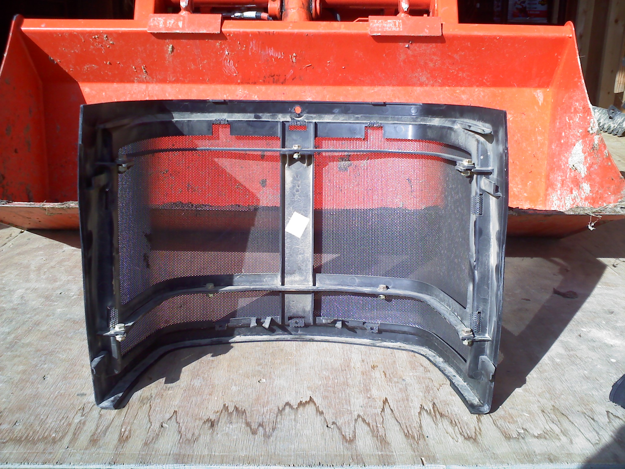

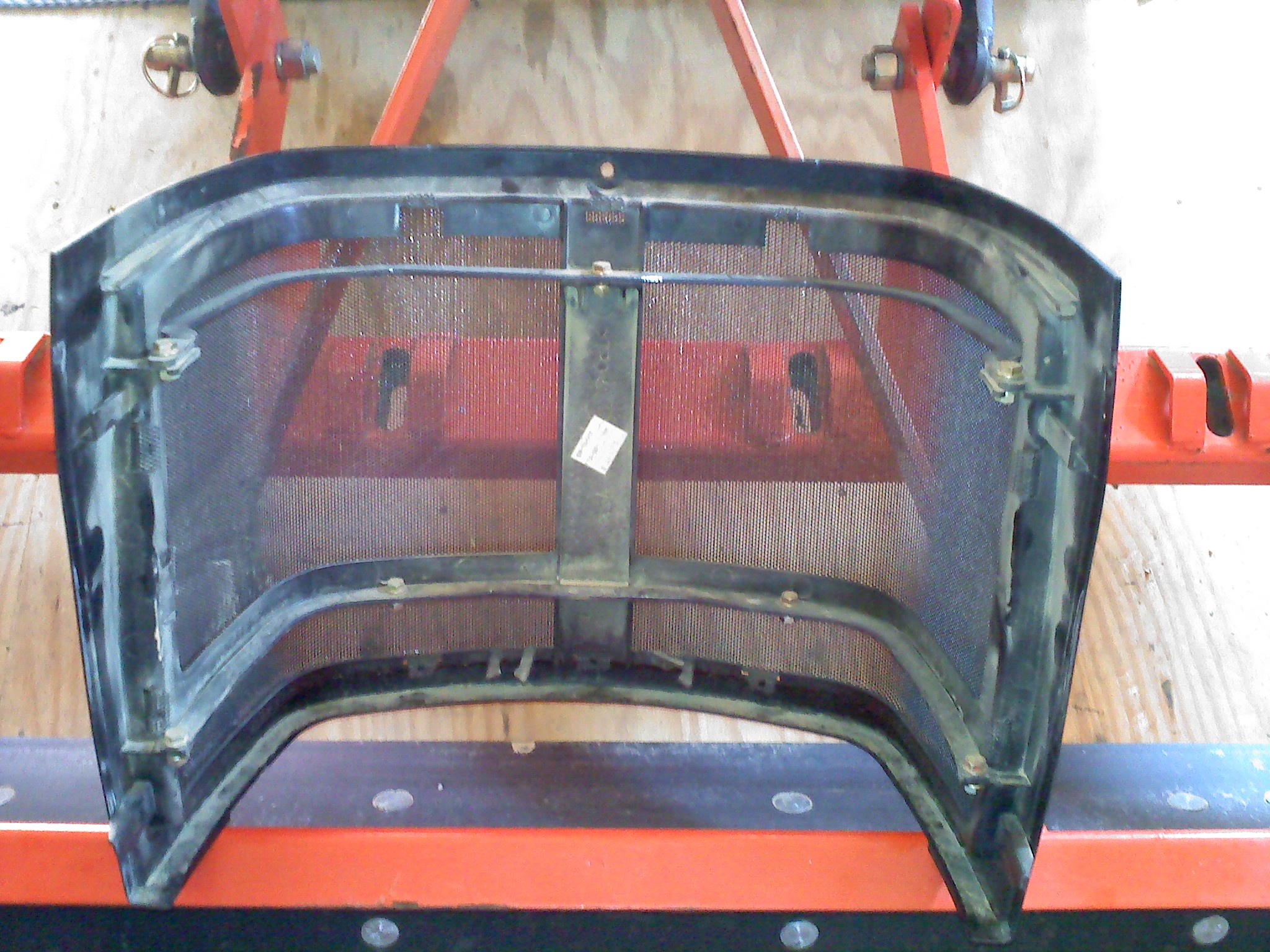

Dean - Now it makes sense on why my newer BX24 doesn't have the same problem as yours does. Looking at yours last weekend, I couldn't see what was different and didn't notice that I have supports to prevent the problem with it bowing out.
Tod,
Does yours have the supports? :confused: The parts manual for our tractor does not show them. I went to the BX2660 parts manual on Messick's website.

Dean - Attached are two different pictures of the inside of my cover that came standard with my late model BX24. You will see that I do have the two support brackets and this is why my cover fits perfectly. Hope this helps.

Thanks Tod!! I have them on order. Messicks will ship them when they get them!! I will probably run mine without the cover till then.

The cover was just the plastic piece. The parts manual shows the part I bought and the screen , which I transferred to the plastic frame. The parts manual does not show those supports. I don't think you can buy it as an assembly.
No biggie, I will have the supports in a couple of days and put them on!!!
Your picture shows exactly how it should be!
