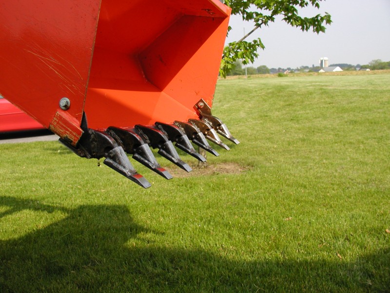

It would last a very long time if it weren't for snow removal. The dirt work didn't have much of an impact on it. A couple of winters of clearing snow from paved areas has caused a fair amount of wear on the bottom side of the leading edge. I have a habit of trying to get clean down to the blacktop and have often had the front wheels off the ground while scraping. It may only be another season away from having to flip it around or make another. I consider it a wear part to protect the factory cutting edge.
Back when we had a B7500 we had more dirt to dig, so I made a toothbar. It worked great for digging and the teeth were handy for keeping larger tree limbs and things from slipping off the bucket. For most things it got in the way. It was easy off and on so it worked OK.

Good idea making it reverse-able. Makes we wonder if the Pirhana could be made reverse-able. Probably would add to cost due to need to bolt on the end plates and make it less durable due to decreased cross section area.
