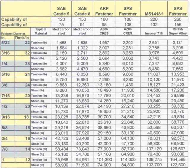

If I remember correctly grave 5 bolts have a higher shear strength that grade 8 but the tensile (stretch) strength of grade 5 is lower that grade 8. If this is true then grade 5 bolts would be a better choice for your hitch since this application induces higher shear forces.
Is my memory correct?
No, you remember incorrectly.
Shear is typically given as .6 tensile strength. Hence, the higher the tensile strength, the higher the shear strength.
Example chart provided below.
