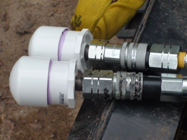

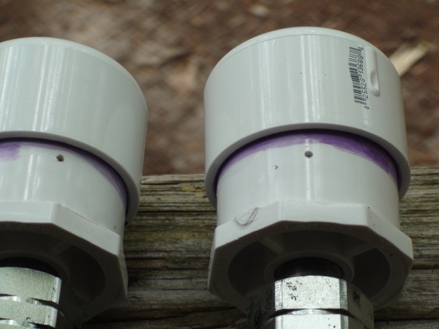

The issue on the implement side during storage is due to fluid pressure changes in the lines due to ambient air temperature changes or sunlight on the hydraulic lines. I made these with plumbing parts from a big box store and keep them on the implement(s) when not in use. They keep the connectors clean and the tiny hole drilled into the cap keeps the hydraulic pressure from building up. Before assembly, stuff the caps with a rag or paper towels to keep any hydraulic fluid from seeping out the weep hole.

This looks like you are detaching the lines and leaving the couplers in place and attached to each other. Am I seeing this correctly?
