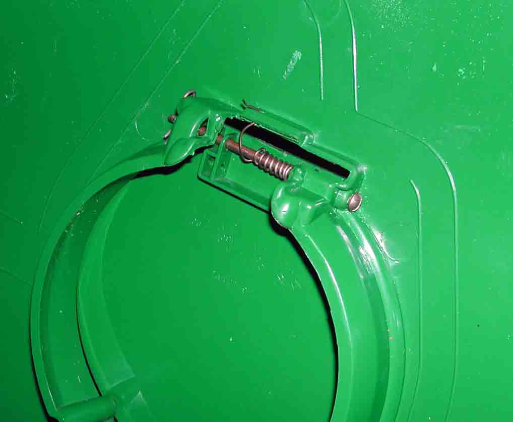

I still have the new parts from the last 4300, never installed. I gave up
on them and made my own hinge.

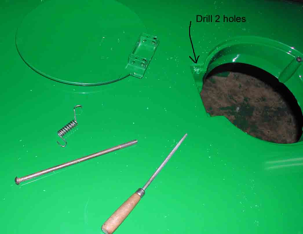

Instead, I got my own hinge shaft material (a long bolt), and customized
a spring from my hardware collection. The hood needs to be drilled first,
cuz it comes with no holes. A Dremel-type tool works best here. Next, I
dug up a small spring of the type pictured, and used a torch to heat the last
winding of one end. This allowed me to straighten it out to provide the
right configuration for the door. The small file in the photo is used to tune
the hole to just the right size. Works great.

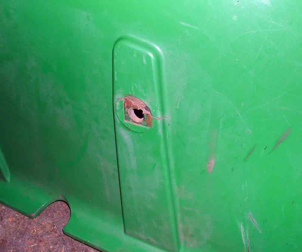

Some numbskull renter decided to chain the tractor to his trailer, running
the chains between the rear fender and the ROPS. These rear fenders are
pretty tough, but that was too much. The upper bolt and washer were pulled
right through, and another mounting point was damaged.
So I fabricated a giant fender washer, made from 2 layers of 1/8" steel plate,
bent to conform to the inner wall of the fender. I used some 1/4" steel bar
instead of the other washer. The fender is now more securely mounted than
when it was new.

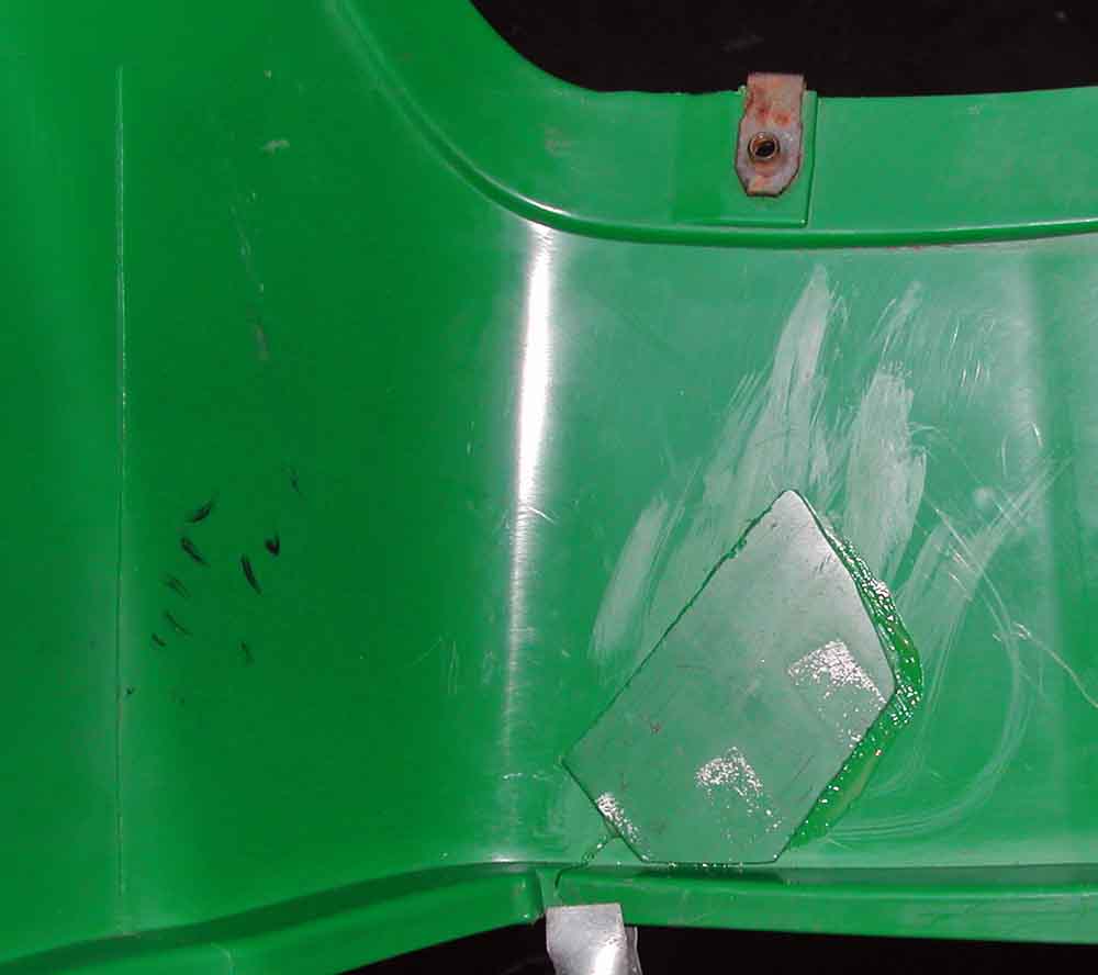

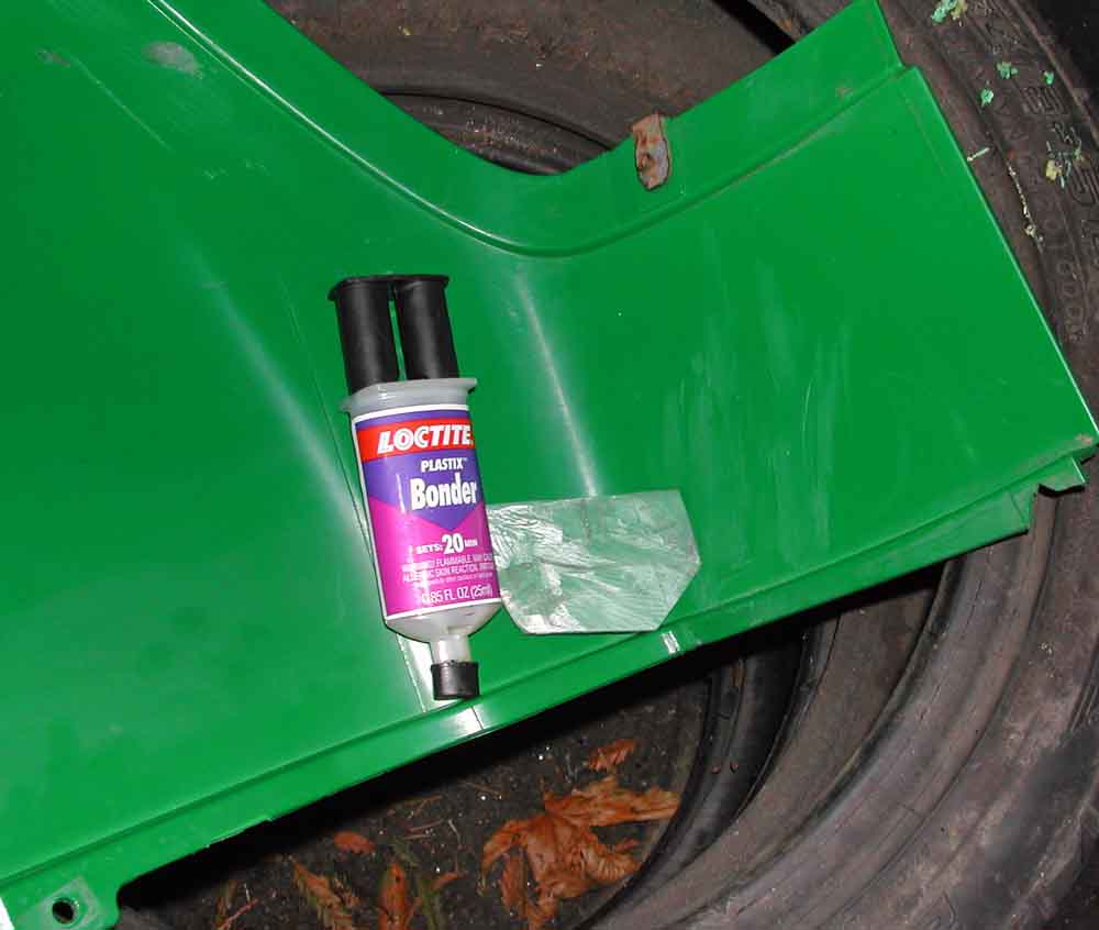

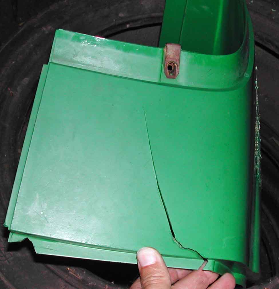

Last year, I experimented with glued repairs of the green resin body panels.
I used a 2-part adhesive intended for plastics. It worked pretty well. I
backed up the broken piece with a chunk of plastic cut out of a scrap
JD panel.
This resin may fade with age, and get somewhat brittle, but it IS glueable.
Polyethylene plastics, as used on ATVs, are not repairable this way.
I decided to repair and reuse one of the 2 cowl panels, since they cost over
$100 new. Fixing the broken off mounting tab required cutting/bending some
galvanized sheet metal. That repair is invisible with the hood closed.

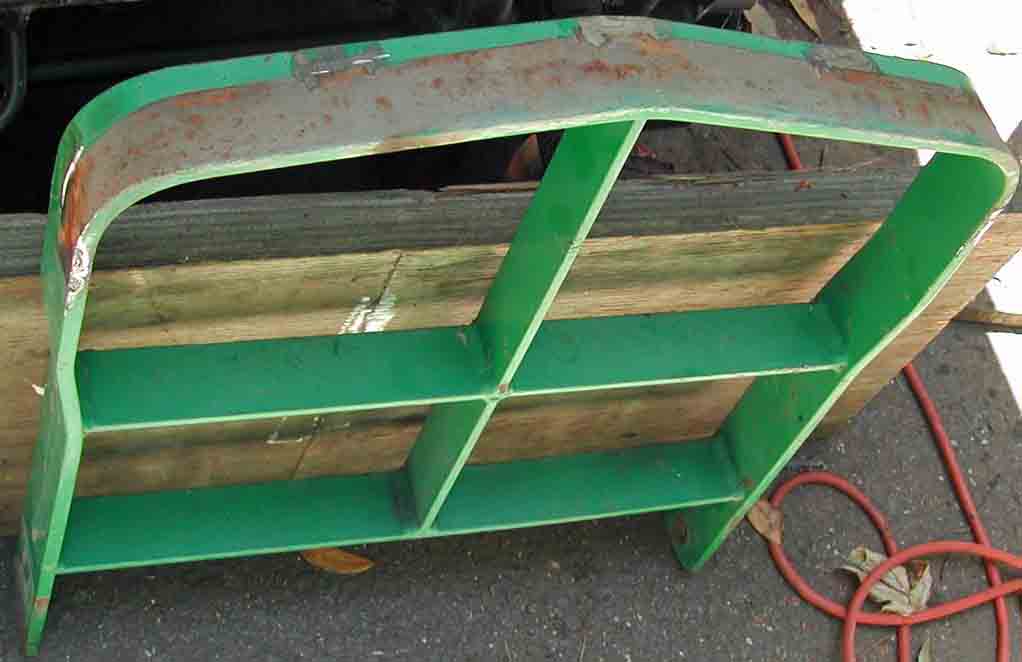

I like the bigger grille guard that came welded to the hood armor, so
I cut the welds and removed it.
Touched up and installed, it looks nice in front of my all-new grille
and headlights.
