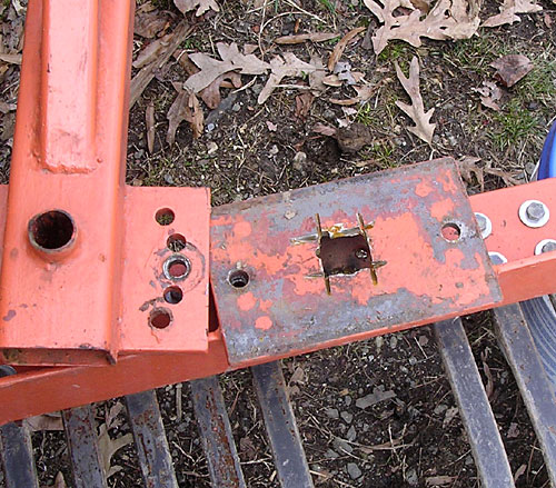

While ago i built a landscaping rake using trailer spindle for the pivot. pretty soon the spindle snapped and i used it for a while just bolted together. Now i finally got the time to fix it. i was able to remove the broken spindle and the plan is to use just 1 inch bolt as pivot. Should i use grade 5 or grade 8 bolt? As of now, I am thinking 5 is enough and better - the green bolt from TSC.
Opinions?
I am not starting any grade 5 vs grade 8 flamewar, please:)

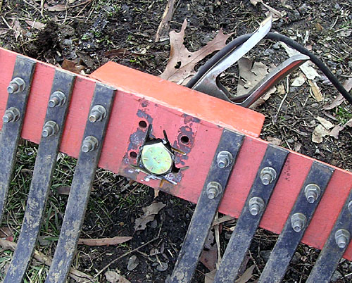

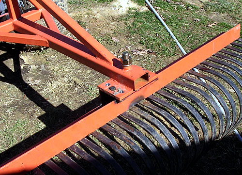

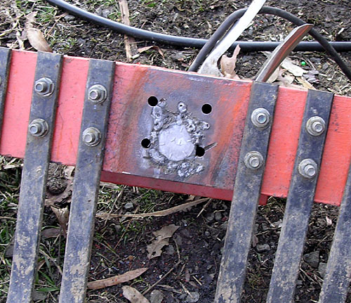

Well, I got it fixed. Ain't really pretty, but it works and holds the load.
I had to cut out the old spindle with grinder, thats why the hole is square. I added and tackled one more nut in the middle of the bolt to have something to weld the top plate to.

Looks great ... but I think it is time to invest in an oxy/acetylene torch! How much do you figure it cost you to make it in the first place? Would you do it again?
   / repairing landscape rake #8
Beauty is not so necessary as function. If it does the job it is a job well done!!:confused: :D
Mike
#9
Tough question. I had some steel laying around from my trailer and tire carrier, the whole 3pt arm was made from it. I had to buy the angle iron for the rake and the tines of course.
Yes, I would do it again - but not with the trailer spindle:). I think i still put it together for less than half of what TSC sells rakes for.
