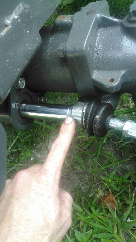

Has anyone done this repair? My steering ram is getting quite loose and want to know how hard it is to do.

I'm about to tear mine apart to fix it so I'll let you know shortly..
   / Repairing GC Series Power Steering Ram Brackets #3
No but I know there was a recall done on mine as it was installed incorrectly at the factory.
   / Repairing GC Series Power Steering Ram Brackets #5
Take it apart where the cylinder meets the tie rod. Should be some notches on the cylinder to counter hold with an open end wrench. This will keep you from having to reset your toe in.

   / Repairing GC Series Power Steering Ram Brackets #8
