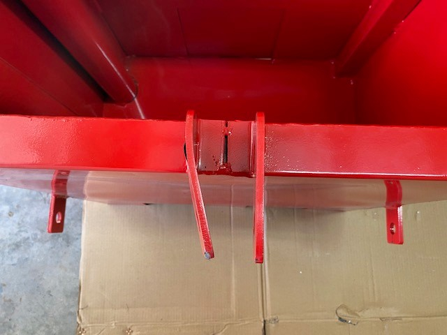

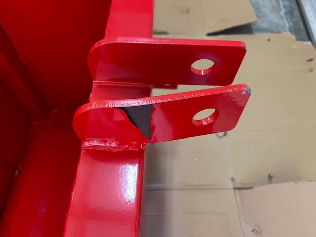

All,
I'm looking for some suggestions on how to fix a bent upper link pin mount on a new ballast box that was damage during delivery. I did contact the company and I'm waiting for a reply. In the meantime I'm wondering if there's a somewhat easy way to straighten this out?
Our local farm supply wanted a ridiculous amount for a ballast box so I went the mail order route hoping for the best. Nothing is simple it seems :)
Thanks,
Lou

Good heavy pair of vise grips?
Looks like the pin will almost still fit.
You're right, things just can't be simple anymore.
   / Repairing bent link pin mount on EBESTTECH Ballast Box #3
A large Crescent wrench with the jaws closed enough to just barely slide over the bent metal vertically. Then just apply leverage force to the side to straighten.
Easy-peasy
   / Repairing bent link pin mount on EBESTTECH Ballast Box #4
Big wrench (crescent) and a pipe over it for leverage... OR long bar with hole in the end and use a bolt to grasp the bent tab....
Thanks for the replies. I'll try the cresent wrench or breaker bar technique
   / Repairing bent link pin mount on EBESTTECH Ballast Box #7
Good heavy duty hammer would probably work
