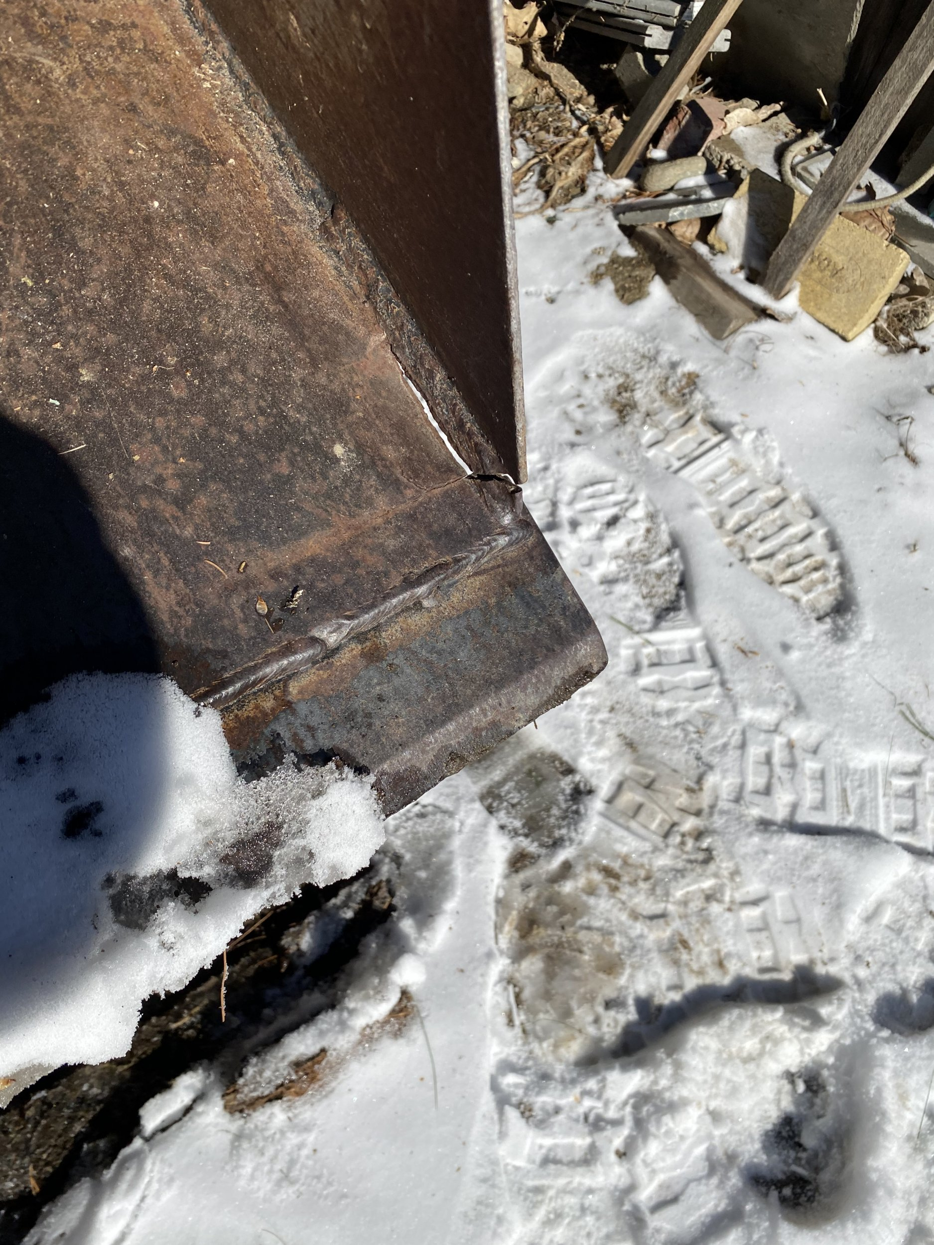

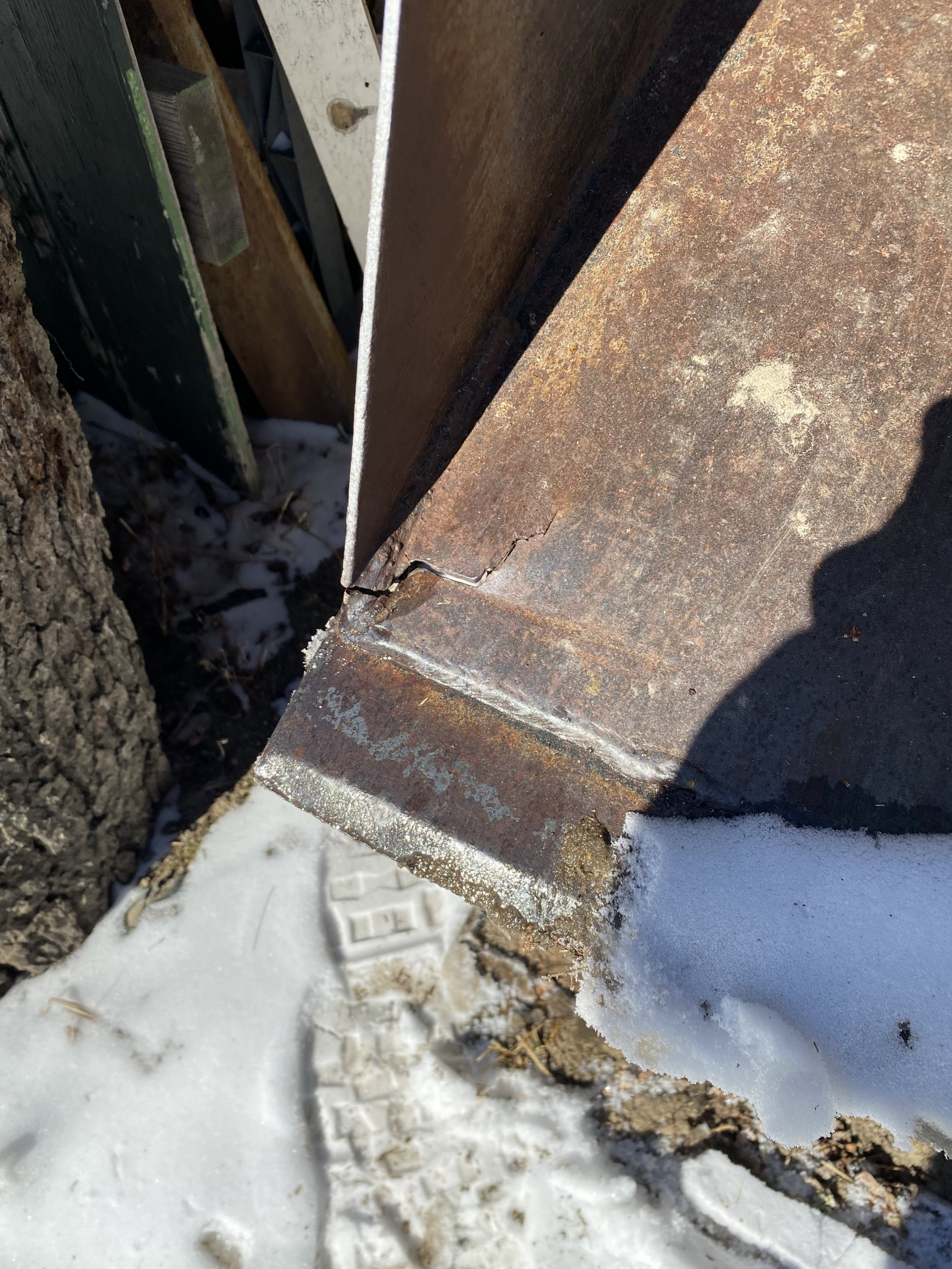

Anyone had to repair their light materials bucket. I know it will involve welding but wondering best way to reinforce the area.

Mine is still practically new, but we make these kinds of repairs on wheel loader buckets all the time.
A basic patch on the outside and a fillet weld on the inside should do I'd think.

How many hours of abuse did it take to get that way, I only say abuse, as most of us push our machines beyond the stated limits. Just curious so I know about when mine is going to fail.
I agree, patch and fillet weld. At least you caught it before you had to bend it back into shape first.

Abusing that one since 2003. Thanks for the advice.

I would be inclined to do as the others suggested above, and in addition patch the side as well as the underside to strengthen the corner weld. Whatever you did/do is applying more force than the lip edge can handle. You might consider a flat bar of high strength steel welded on just behind the existing edge, or cut out the existing edge and top in a high strength edge that is wider, and reinforce the existing vertical edge.
You could also out YouTube where the are a number of lip repairs to buckets for ideas.

As you seem to be an expert, for those of use with bent buckets, any recommendations on what material to use to replace the skin with something a little stronger and more durable? I have a running battle with the floor of my 4N1 bucket, which is always bending. More wear bars of? New skin made of? New cutting edges made of? I have no problems welding things together. I am just at a bit of a loss on what would be a reasonable path forward.
