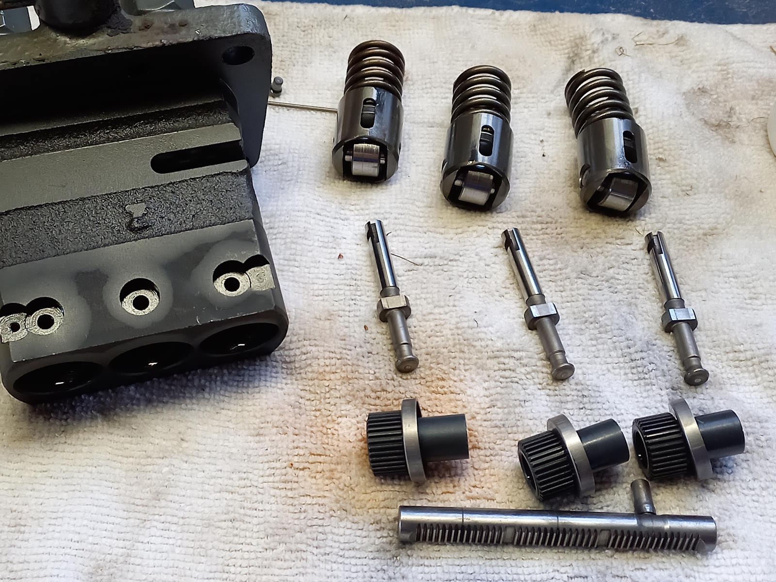

My tractor has 771 Hours on it. Bought new in 2006. I suddenly started losing power especially when I started flail mowing. It would run fine for about 5 - 10 minutes and then start running rough at revs but OK at idle. It would progressively get worse. It starts OK but a bit rich. I have removed and checked the lift pump diaphragm and it is OK.
Naturally I suspected the pump gears then but tried injector cleaner first but no good.

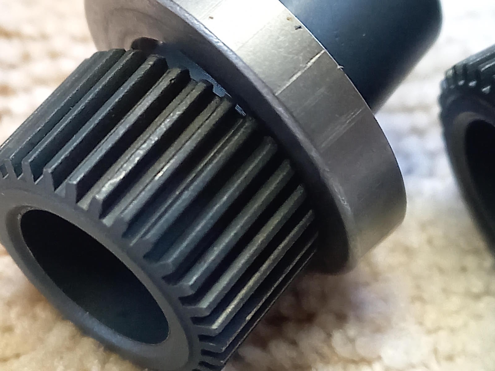

So, I have removed the pump thinking that at those hours maybe the rack gears had lost a tooth or two.
I have it dismantled and can find no fault with the gears, in fact, I can't even see any sign of wear anywhere on the gears or rack. I used magnifying glasses.
Being a 2006 model is it possible I may have a later gear set or have I just been lucky they haven't stripped yet?

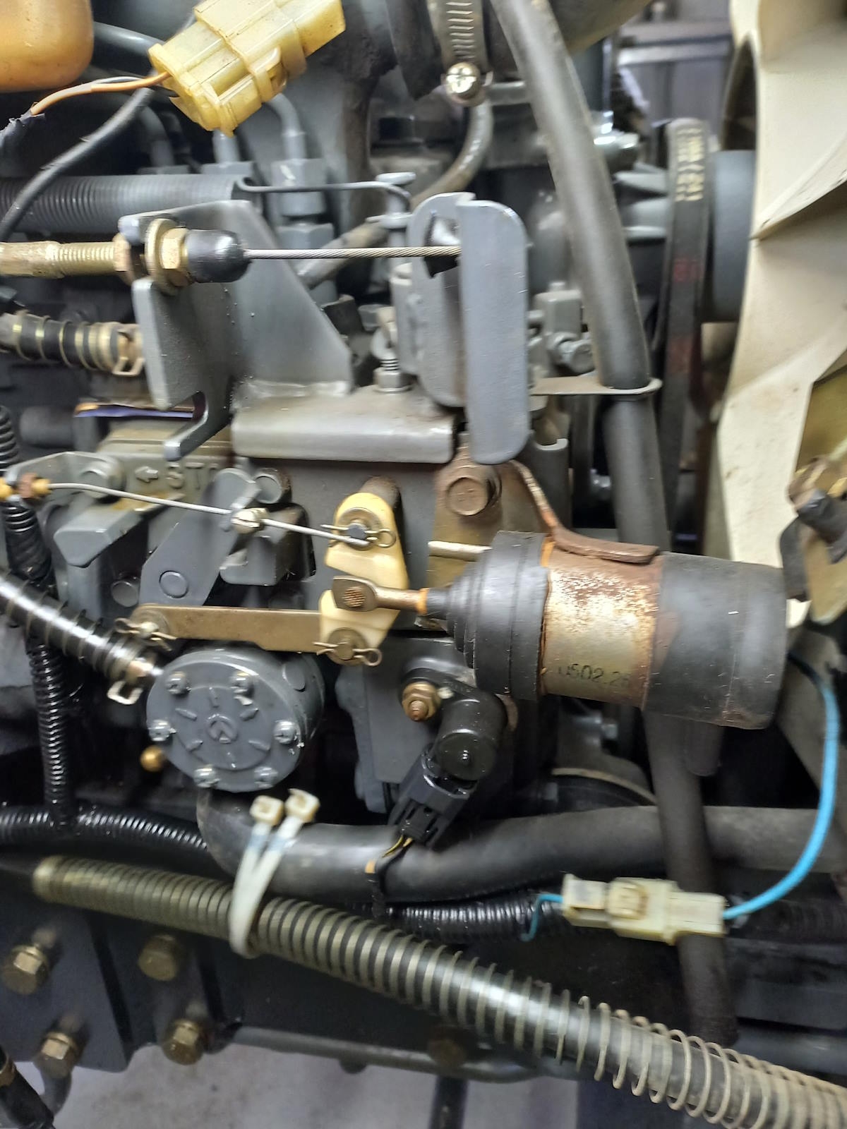

Here are some pics. The pump number is shown and some pics of the teeth etc. I have included a pic showing the stop solenoid.
Is there a way to look up the pump number to verify a changeover date for the gears?

If you have a 2006 model with the internal stop solenoid and original IP gears they are certainly the old version. Even though yours have not failed (yet), I would replace them while you have the IP off the tractor. Your symptoms sound more like a plugged fuel filter or fuel tank outlet (where the hose attaches). Verify that you have good fuel flow from the tank by just gravity by detaching the hose. Replace the fuel filter if there is ant doubt. Check also the loft pump by operating it manually and verifying good output, probably pump several cups of diesel to be sure. Lift pumps check valves can fail even if the diaphragm is OK. You will probably need an intake manifold gasket for reassembly.

Alien: I just saw your last photo. You have the older, external version of the stop solenoid that was not known for breaking control sleeve gears in the IP. Your stop solenoid energizes to stop the engine and that motion is benign compared to the new style where a spring-loaded plunger can whack the rack with considerable velocity. Disregard my comment on replacing your gears.
Good luck with your intake manifold gasket mine came off in pieces.
Still, I think your symptoms indicate a fuel delivery problem.

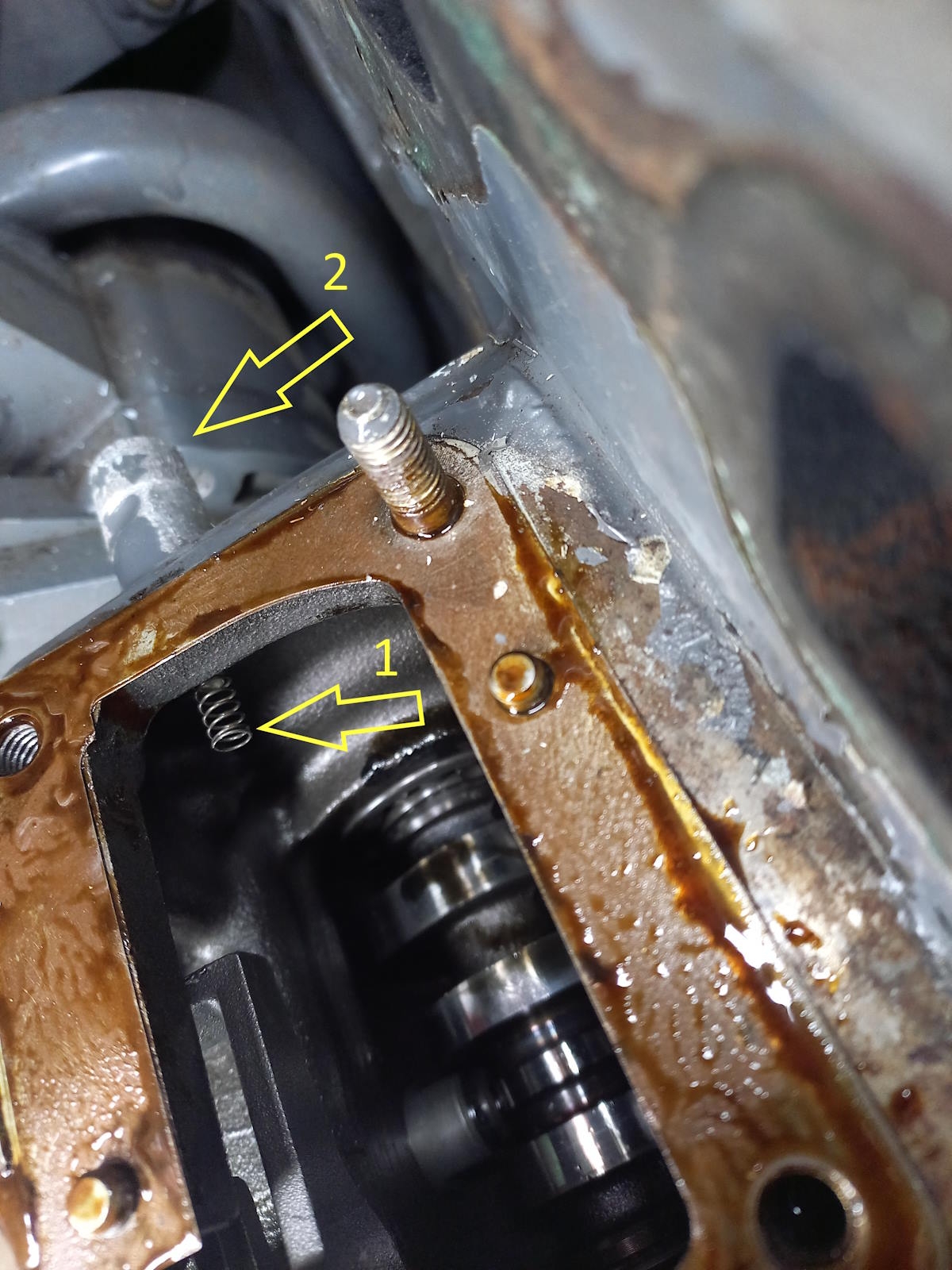

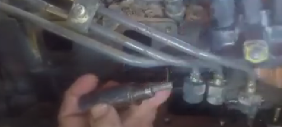

Thanks richeyvs. Yes I could not fault the 'gear' teeth at all. No sign of wear whatsoever. I guess that way I am lucky as I checked with a local dealer and he said they had never stocked parts and likely not available in Australia. They would have to be ordered so I have reassembled the pump but have another problem.
There is a spring (1) that sits on the end of the rack as in Photo (1) I figured it should have a sleeve or something where it contacts the rack end but I didn't notice it till I started to refit the pump. I have fished around with a magnet but can't find any other part. On the later pumps there is a removable cover and a spring loaded plunger as in the second picture. The cover on mine (2) doesn't screw out, it appears to be pressed in although I can turn it.
My question is, should there be a sleeve on that spring?
After your last post, it seems that I have been worried about those gears unnessesarily for the last few years. LOL
