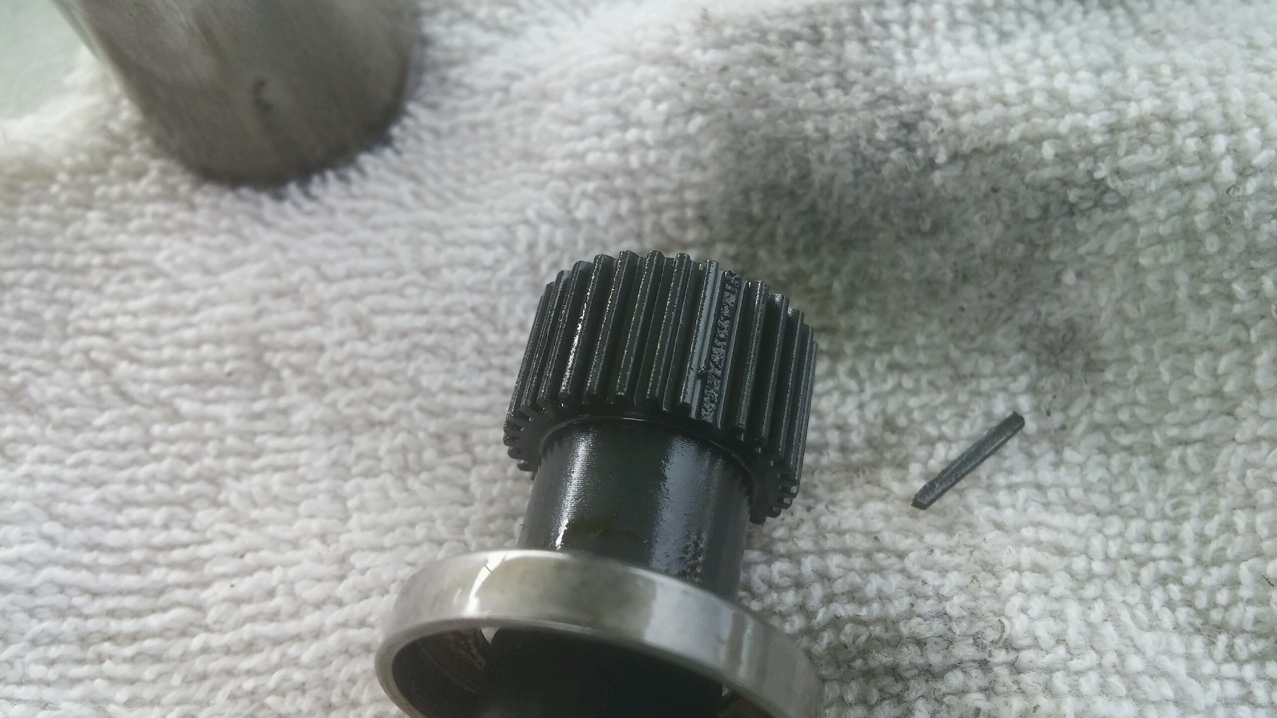

Thanks for all the great information. I just did this repair on my CT230 and followed the instructions from 2881neches. The area I did differently was that I never completely removed the control rack. I always left at least on control sleeve engaged with the rack so that I didn't loose the orientation. One gear tooth was broken but it was right at the end of travel and the control sleeve worked fine without it. The entire job took me about 4 hours. Total cost $0.00. 0805161047.jpg

It sounds like your IP rack is jammed forward at a high power position, typically caused by a broken gear tooth.
If you are interested, it is easy to check for a jammed IP rack by removing the oil fill plate and checking for smooth rack movement (with the key on or the stop solenoid removed). The rack is spring loaded to the forward position and it has a pin that rests on the governor arm. The stop solenoid is supposed to push the rack full aft when you turn the key off. Forward is max fuel and aft is min fuel.
The IP does not need to be re-calibrated after replacing one or more of the gears providing all other parts go back in their original locations. Just replacing one or all gears should cost much less than $600-700 unless that includes much labor to R&R the IP. If you go to the linked table in my original post you will find parts sources as well as many owners who fixed their IP DIY.
