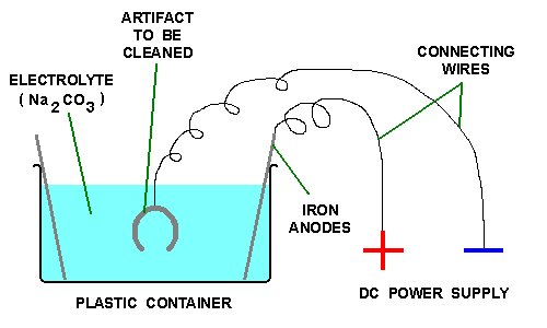

There is another way to remove rust from your exhaust manifold without sending it out to be sandblasted and you can do it a home fairly easy. The diagram is pretty straight forward. Use a clean piece of steel for the positive plate, Your manifold for the negative and a "trickle" charger for the power source. The liquid is a 10% solution of washing soda (sodium carbonate, soda ash) and it is available at many grocery stores in the laundry detergent aisle.
forgot to mention this process will take about 48 hours but is entirely hands off. After cleaning then a coat of barbacue paint or other high temp. paint of your favorite color.
