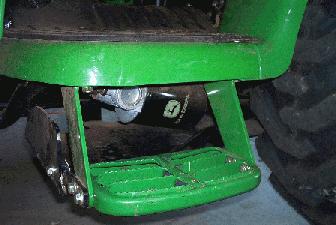

Has anyone purchased the "Rental Upgrade" accessory kit available for their 4000 JD CUT? I found it while browsing for a backup light for my 4600 and saw that this kit provided armor and electronics covers designed to protect the tractor from rental damage.
I was curious if anyone had purchased it and if this was Deere's answer to better armor protection for the CUT units.

You are on the right track!
remnant is a poster that did this and posted Info and Pics Some of the stuff that comes in the kit is probably not gonna get used (C range lockout...) It seems like a good way to go, though. I know I need to get one, too.

Mike -
I'm thinking that this should fit the 4600 also, right? If so, I will probably get the kit this spring since I'll be doing alot more work in the field with rock, etc.

I am pretty sure that you would need the LVB25105 Rental upgrade kit. I looked it up on JDParts. Of course, your parts guy can make sure that's right
Oops! I thought I'd get the price:
Part Details
Part Number: LVB25105
Part Price: No Price Available
On Hand: 0 Check Other Stores
Description: KIT, RENTAL UPGRADE HARDWARE (Part is Obsolete)
I can't find a 4610 version. A good parts guy can tell you if one exists. A good tech should know if a 4610 version will fit. There is a good chance the skid plates will fit, or be easily adapted....

I ordered this on my 4210, I had seen 3 different units in
dealers with their belly's torn out, wiring, or hydraulics.
Minimum bill was $300 and went up from there.
This should be standard equipment.
I didn't have them install the backup alarm or the high gear
lockout.
I also ordered the armor kit for my loader cylinders, lines
and hood.

Extra Armor is what they call the parts for the top (the shiny green side) Rental Upgrade covers the bottem (the dirty black side)
I had no problem finding the discontinued 4600 part number, but can't seem to find a current part. I don't know, but I bet dealers can locate obselete parts. That might be the best bet....

Just found the 2003 brochure.
Xtra Armor Protection Package
Designed for heavy-duty loader usage, the Xtra Armor package guards the hood, lights, grille, hydraulic couplers and cylinders.
Components can be purchased separately or as a group:
Hood & Grille Guard
Heavy Duty Loader Bucket
Replaceable Loader Bucket Cutting Edge
Hydraulic Coupler Protective Plates
Cylinder Protective Plates
Kevlar Hose Covers
Steel Guards for Warning Lights
The same page lists the Rental Package as including a Back-up Alarm and a C-range Lockout, but no armor.

Thanks folks - I'm going to stop over at my dealer on Saturday to check this out with them (besides for taking advantage of the free seat offer). I'd like to get the loader and underside armor - there is just too much stuff hanging down there that could get damaged too easily.

I checked with my dealer today (while I was taking advantage of the coupon to get the chair).
Other than the normal kit listing on the sales side, there was no listing that they could look up for the armor kit. Should they be looking for these parts (from the previous message)?
-Hood & Grille Guard
-Heavy Duty Loader Bucket
-Replaceable Loader Bucket Cutting Edge
-Hydraulic Coupler Protective Plates
-Cylinder Protective Plates
-Kevlar Hose Covers
-Steel Guards for Warning Lights
They are willing to order them separately or in the rental kit if they must. I already have the HD bucket with the replacable cutting edge and hood/grill guard so I think it's just the protective plates and covers that I need. Is there a listing of what is in the Rental Kit anywhere (the couldn't find it when they looked).
