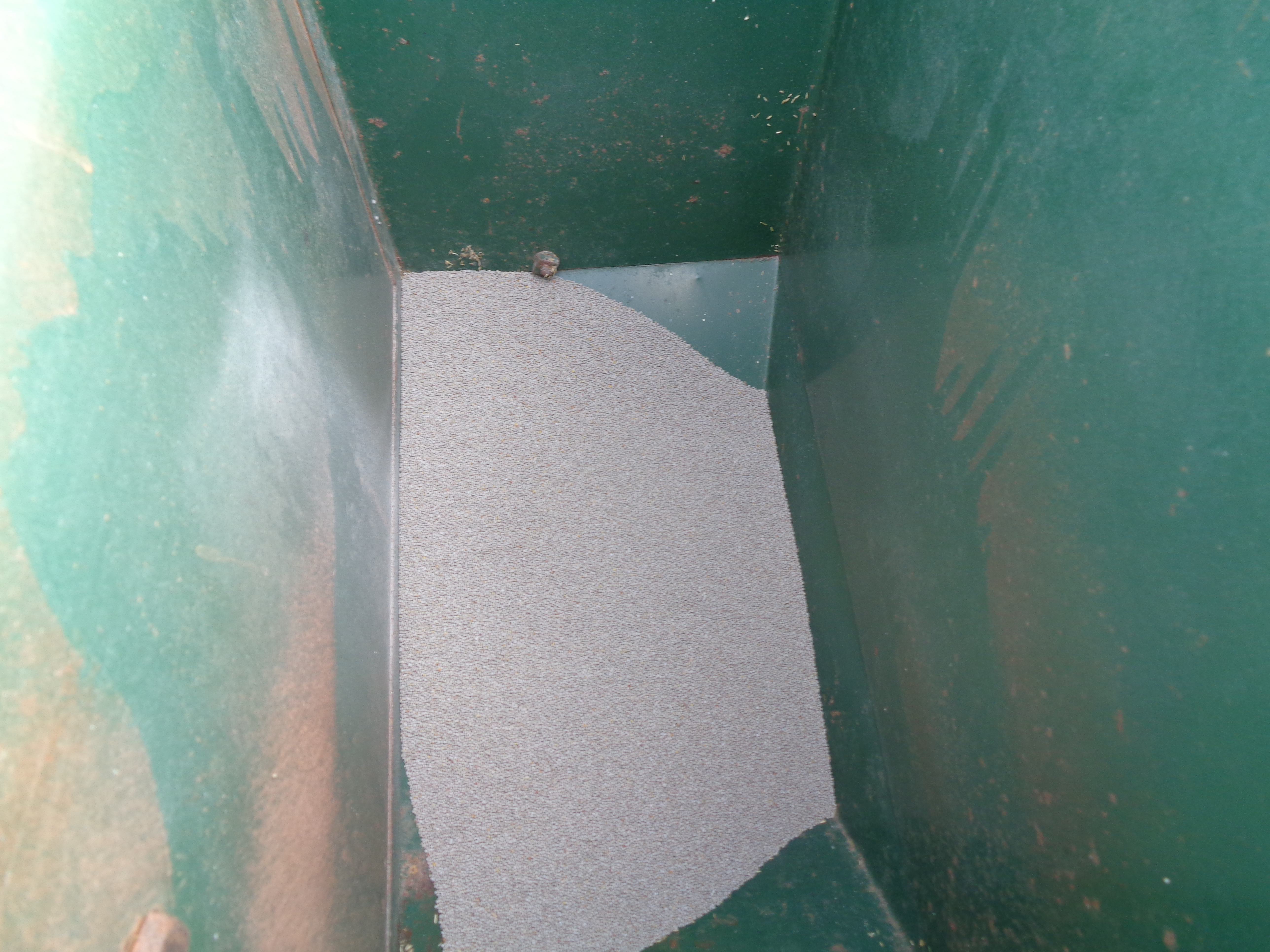

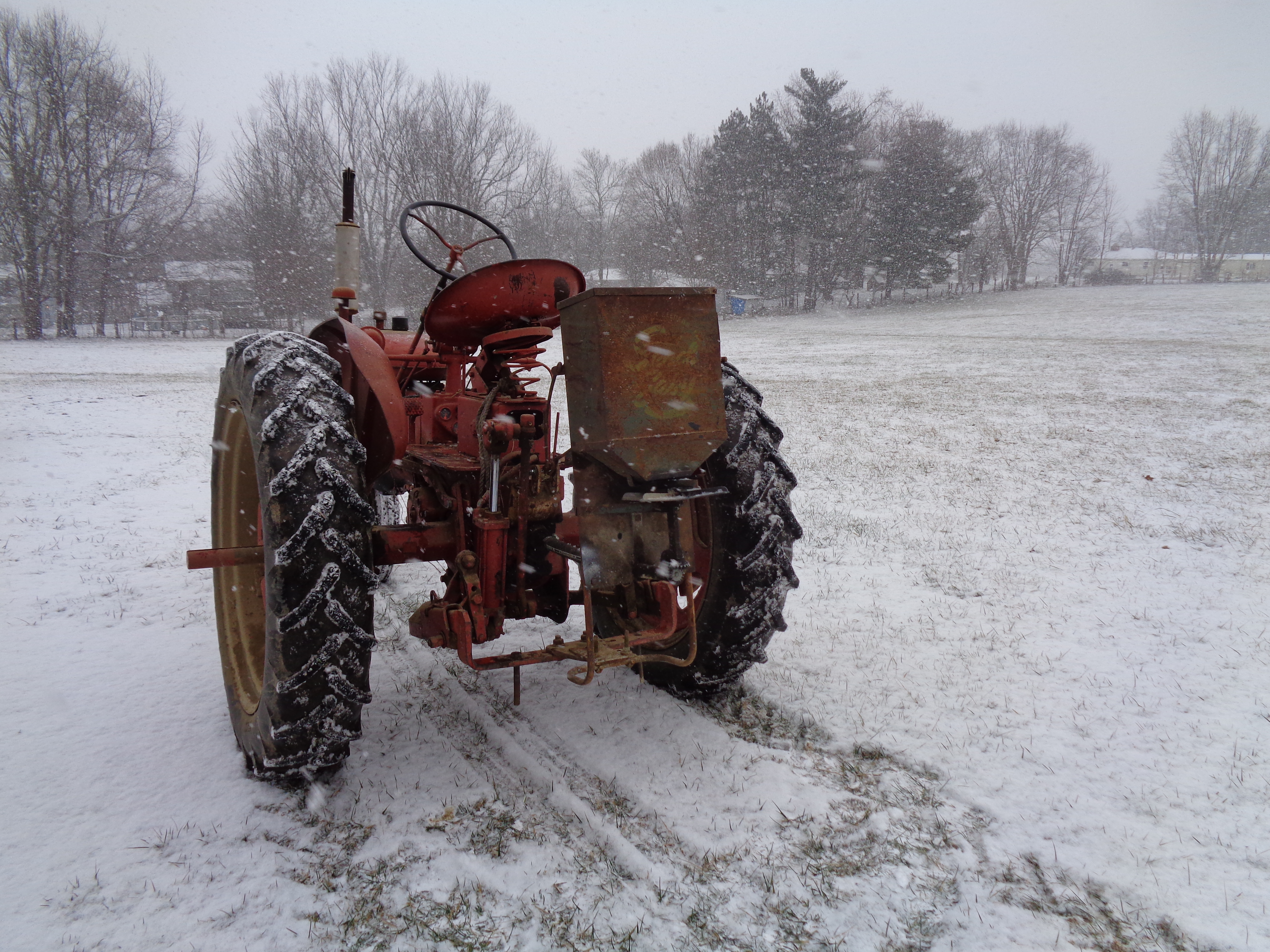

Got the frost seeding done today, even with the approx. 1" of "partly cloudy". Not complaining, it ought to help take that seed home.
This is the recommended amount (4.5lb.), for my 4.5 acre hay field. I closed the metering slide on the seeder just a tad more than the seeding chart on the side said to set it. Purely luck of the draw, that I had it set to where I had to criss cross to use it up. That seed is as fine, or a smidge finer than Timothy seed.
Now we wait....
