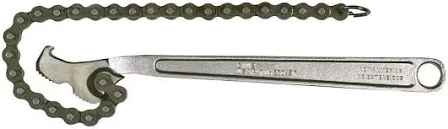

I like the idea of a semi precision fit pin (cut off drill bit) in hole of gland nut, and would be tempted to use a wrench like below with "jaw" teeth against the pin and try not to scar up gland nut as little as possible, besides it's about the only wrench I have that would possible work other than big pipe wrench.. And the floor jack handle makes really good cheater (4 foot long) ..... Might file "notch" a little deeper to get good bite on "pin".... Plus the wrench may have other uses around the property....
Bigger heavier duty version....
Tried it, but I only had a Vise-grip verion of that and could not get a good grip on it with a cheater bar.
So, pipe wrench it was.
