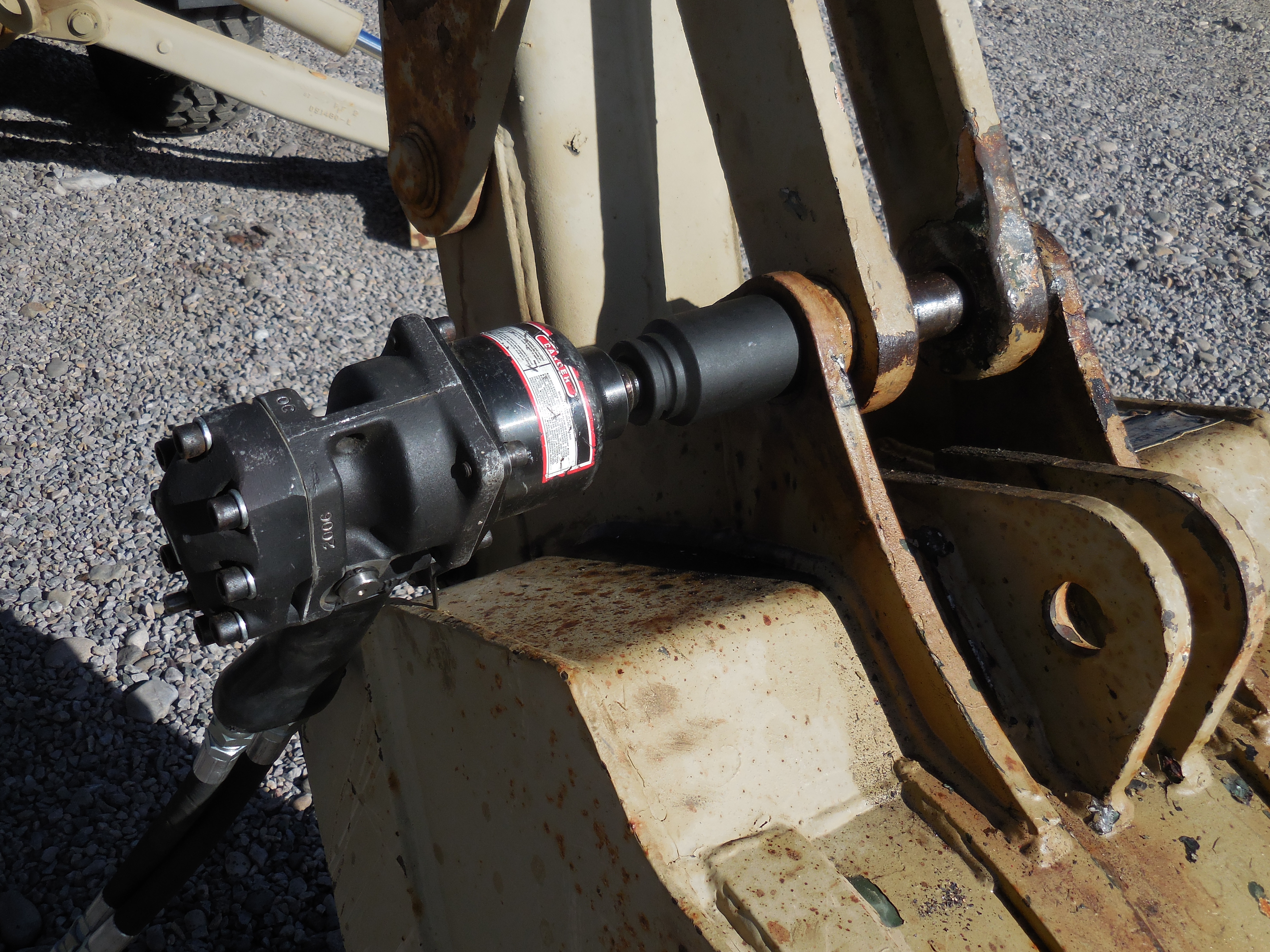

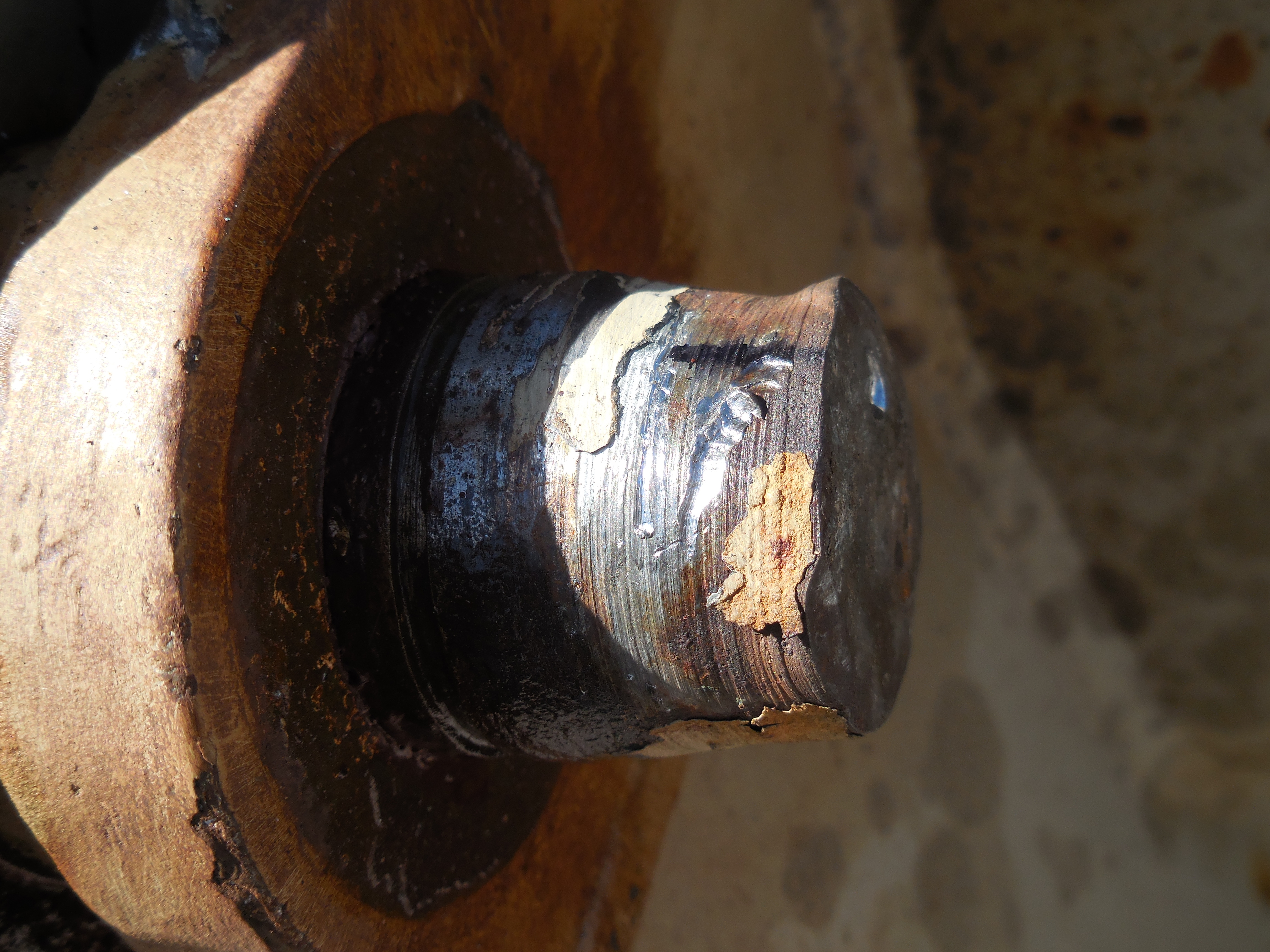

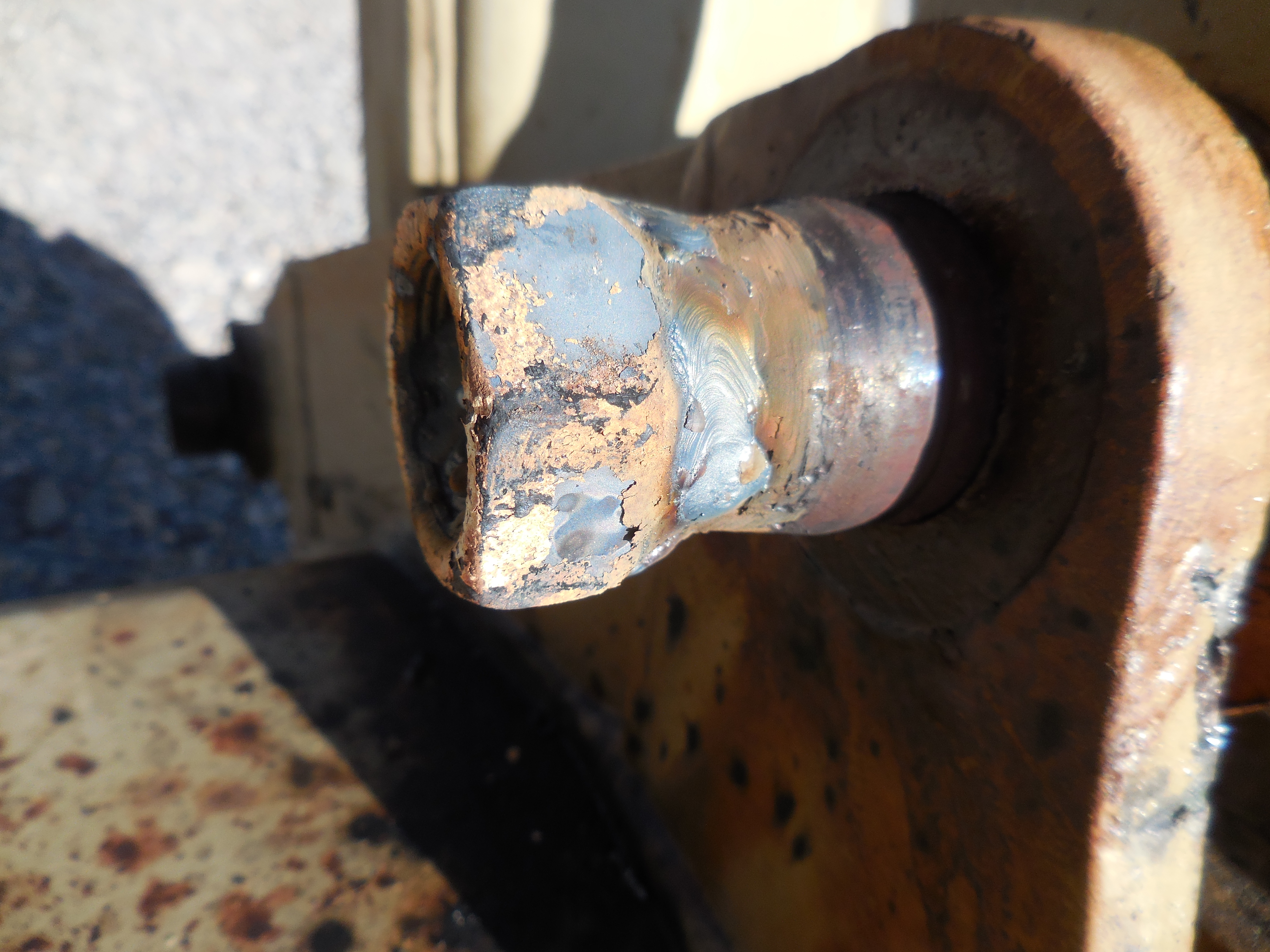

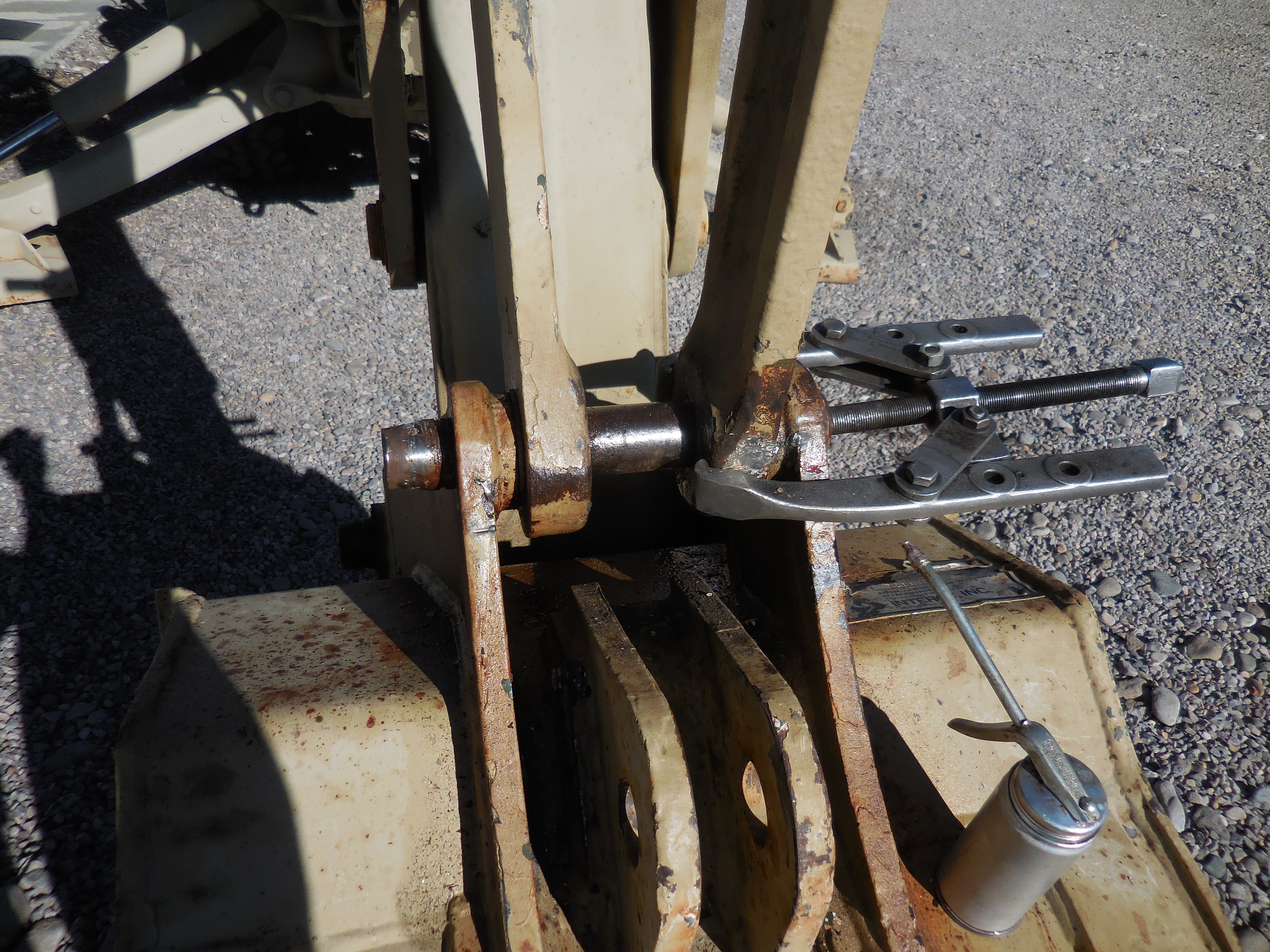

Some people are lucky and others have to do it the hard way. When I upgraded the M59 backhoe with custom quick attach to use the KX excavator attachments, I ended up with the hard way. Always lubricated every grease nipple on machine every 8 work hours with molly grease but the pin attaching the linkage to the bucket, see pic, was more or less "welded" together thanks to time and the pin is fixed in the bucket ear bosses so it won't rotate. Multiple heatings with acetylene torch and beating with 20 lb sledge hammer finally overcame years of corrosion. I was pretty close to cutting the ears off with plasma torch so I could get it to a hydraulic press when pin finally gave in.
Glad to see your pins were happy to depart their bores.
