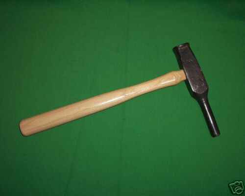

Doug,
This is what we use to drive drift pins, or bolts out of holes. They call it a B&O. One guy holds the B&O the other hits the end with a sledge hammer.
Ed

   / Removing large pins: Anyone use one of these???
#9
civesnedfield said:
Doug, This is what we use to drive drift pins, or bolts out of holes. They call it a B&O. One guy holds the B&O the other hits the end with a sledge hammer.
Ed
A very interesting tool Ed. I'd never seen one before in all my construction days. On the other hand, what does one do when there is no "other guy" around (preferably 6", 240) to do the hitting or holding??? :confused:
Dougster
   / Removing large pins: Anyone use one of these??? #10
Dougster
That's when you invite a friend over for a beer.:D After he has had a sip ask him to hold the B&O, make sure you tell him that it will only take a minute and it usually doesn't hurt. :eek:
