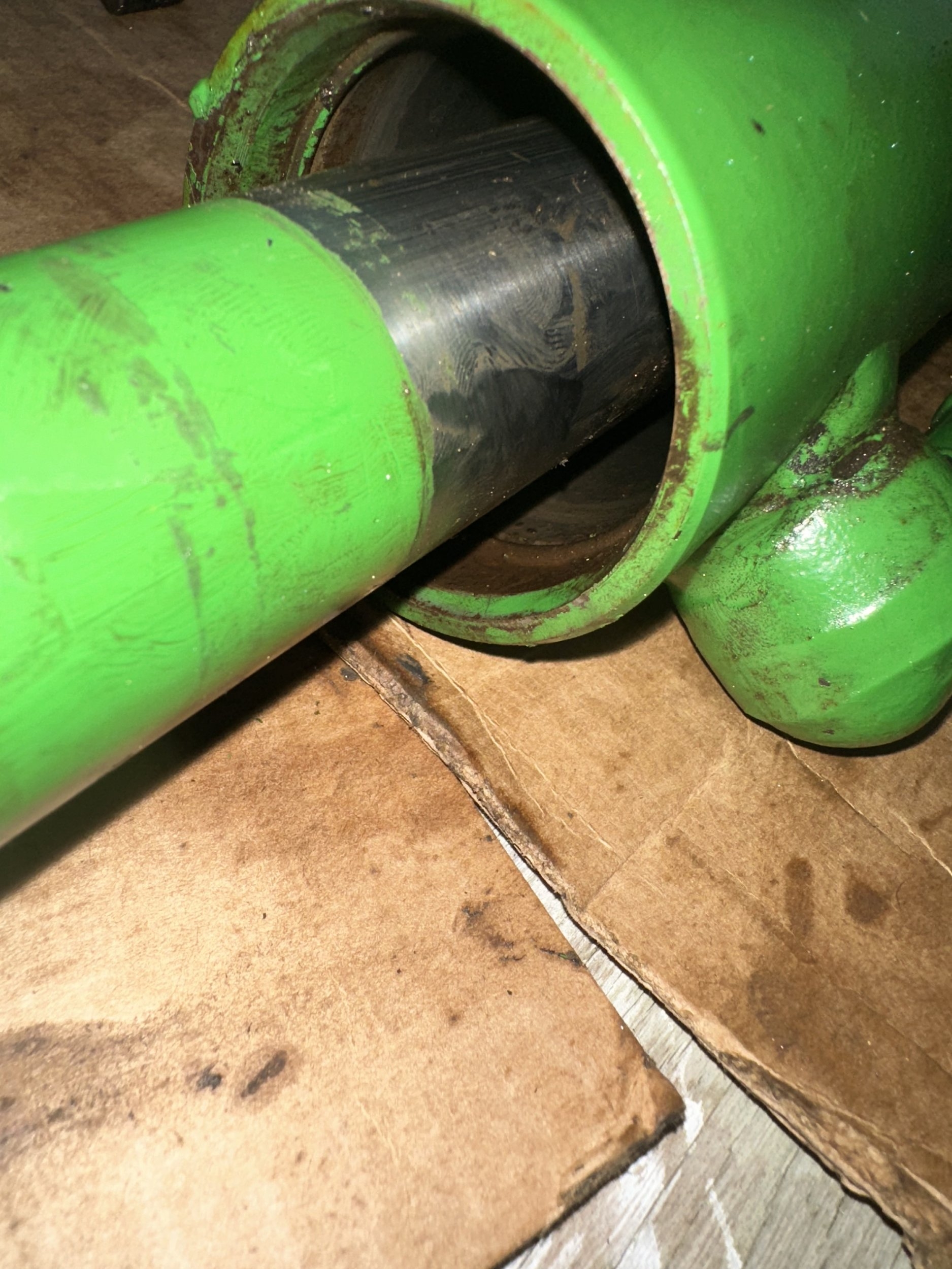

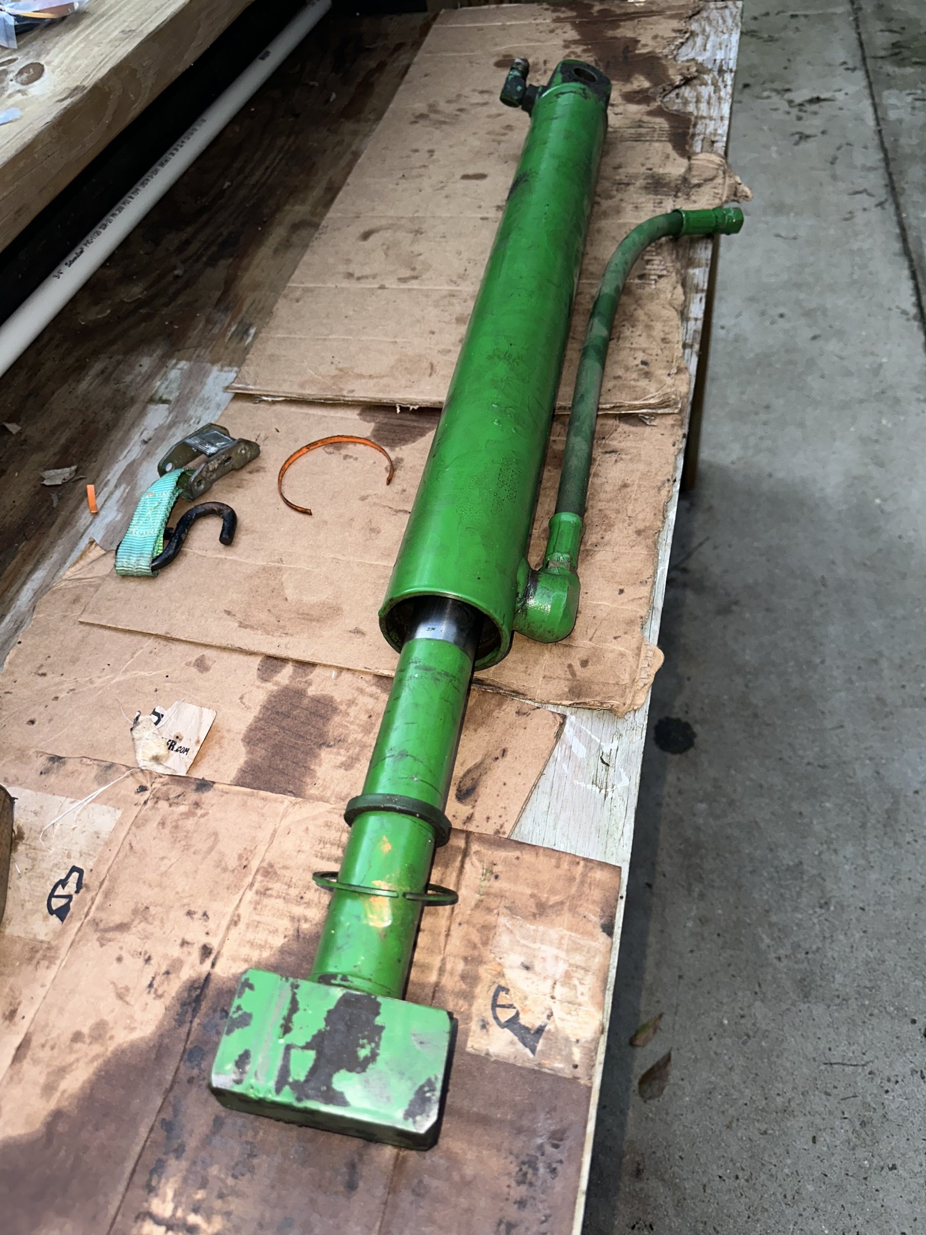

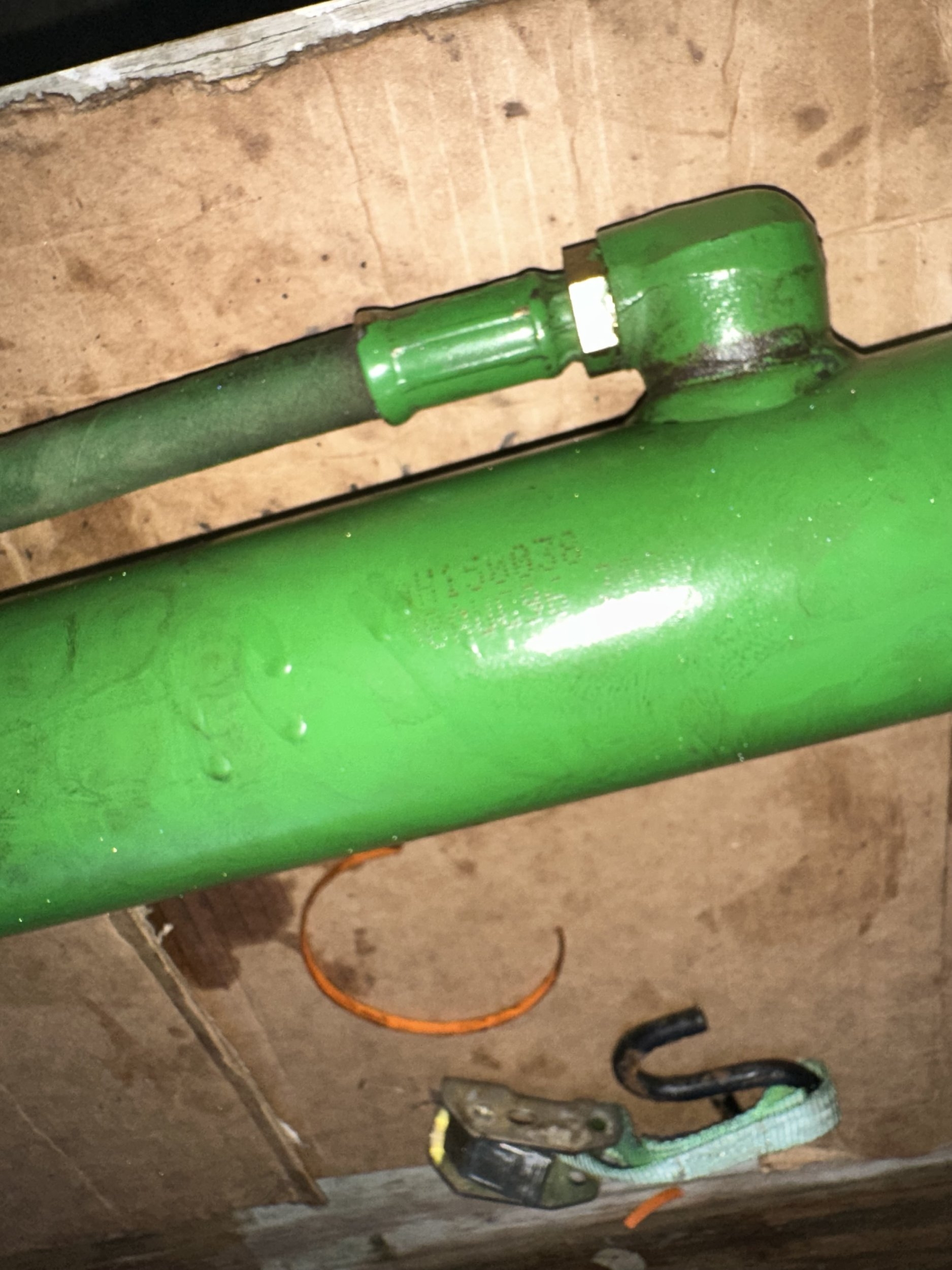

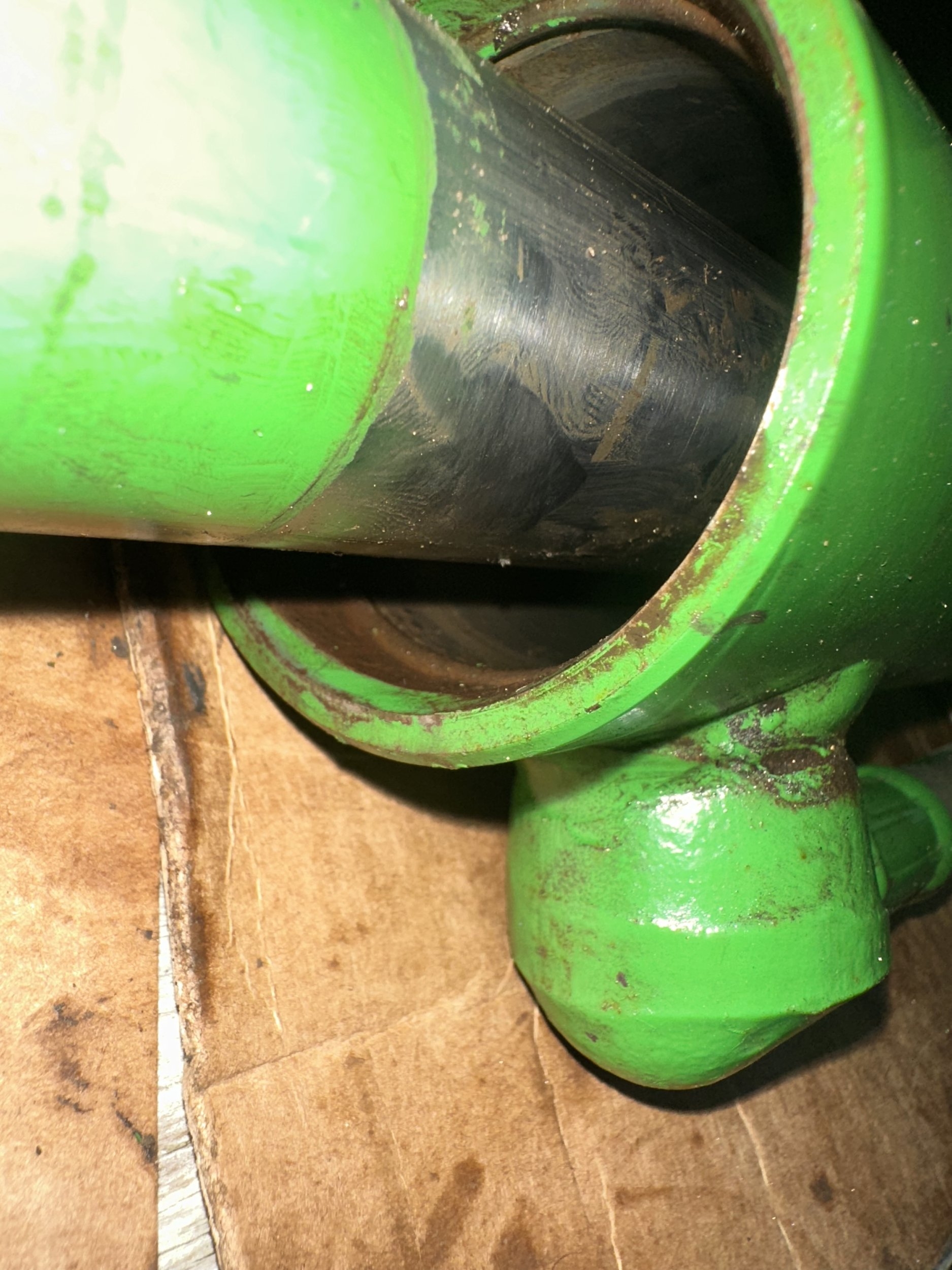

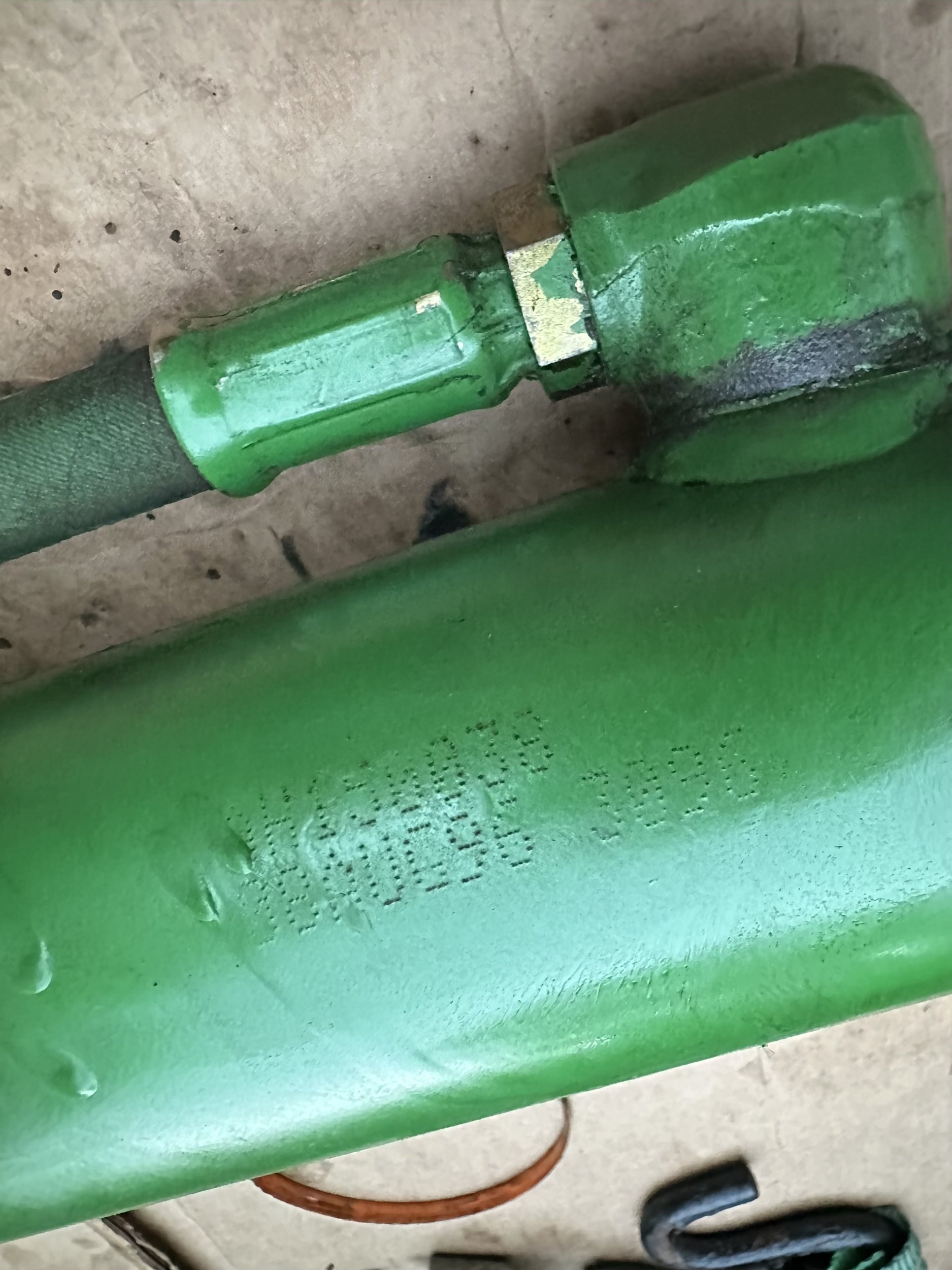

I have a 540 front loader on a John Deere 5500 that has a bad seal. I watched several videos on “YouTube University” and ordered a seal kit online based on my loader model number. The problem I’m running into is the cylinder does not have an indentation/groove for the orange plastic insert to go into. The cylinder has a raised ring on the inside where videos show it having a groove. Does anyone have any tips or do I have a peculiar model? I appreciate any help! The pictures should show the raised ring on the inside of the cylinder I have. I have tried just about everything to pull this thing apart, but it has to be something wrong with the ring/plastic insert.

Looks like a standard wire ring to me. I think you need to pick that out first before attempting to pull the rest out,
   / Removing hydraulic piston rod - John Deere 5500
Ok. I will try that in the morning. The ring didn’t really seem to move at all. I was a bit apprehensive to prod at it, or anything, since it was inside the cylinder. Thanks Harry.
   / Removing hydraulic piston rod - John Deere 5500 #4
They don't move easily. It may take some effort to get it loose and get an end out of the groove, but it should come out. Before I put anything back in I polish the inside of the barrel around the groove with a die grinder and one of these.
