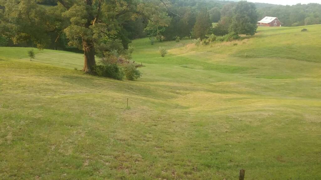

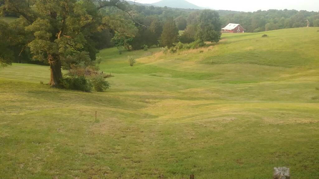

My extra land I bought last Fall has ditches, only they are really sinkholes leading to a deep spring which runs into a creek.
I was afraid of flipping my tractor so the largest one I use for tree stumps. The smaller VW beetle size ones my neighbor and I filled, he used his bobcat, me the JD loader. Rocks, dirt, then good topsoil, seeded. We've had really hard rains, so far so good. In pictures you can see lighter green new grass and stump pile. 20180609_193652.jpeg20180609_193723.jpeg
