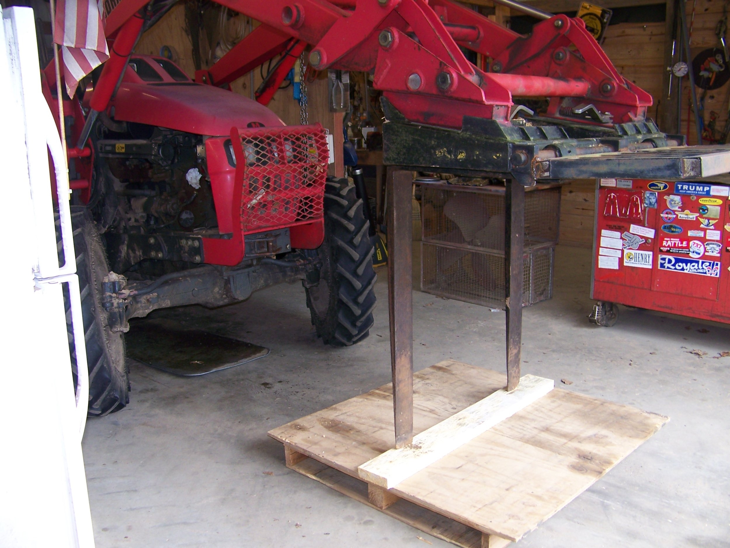

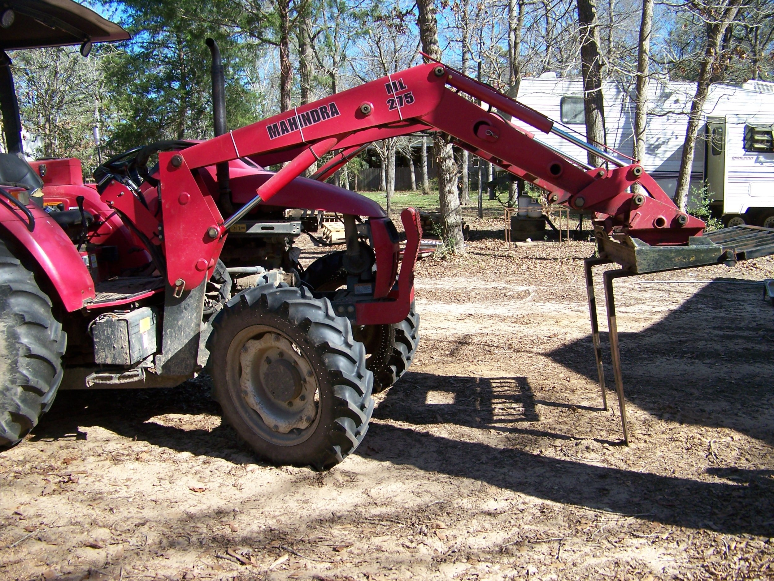

Put your forks on the loader and jam the forks straight down into the ground to have more access. I have done this also with a wooden fork pallet with a 2x6 added on the pallets center and just put the forks down, kinda overcentered into the 2x6 for changing the water pump and hoses.
I leave the hydraulic cylinder tube attached to the tractor and just remove the rod and ram with all seals.
Loosen the gland nut, pull the pin on the rod, let the cylinder hang straight down and pull the rod out.
