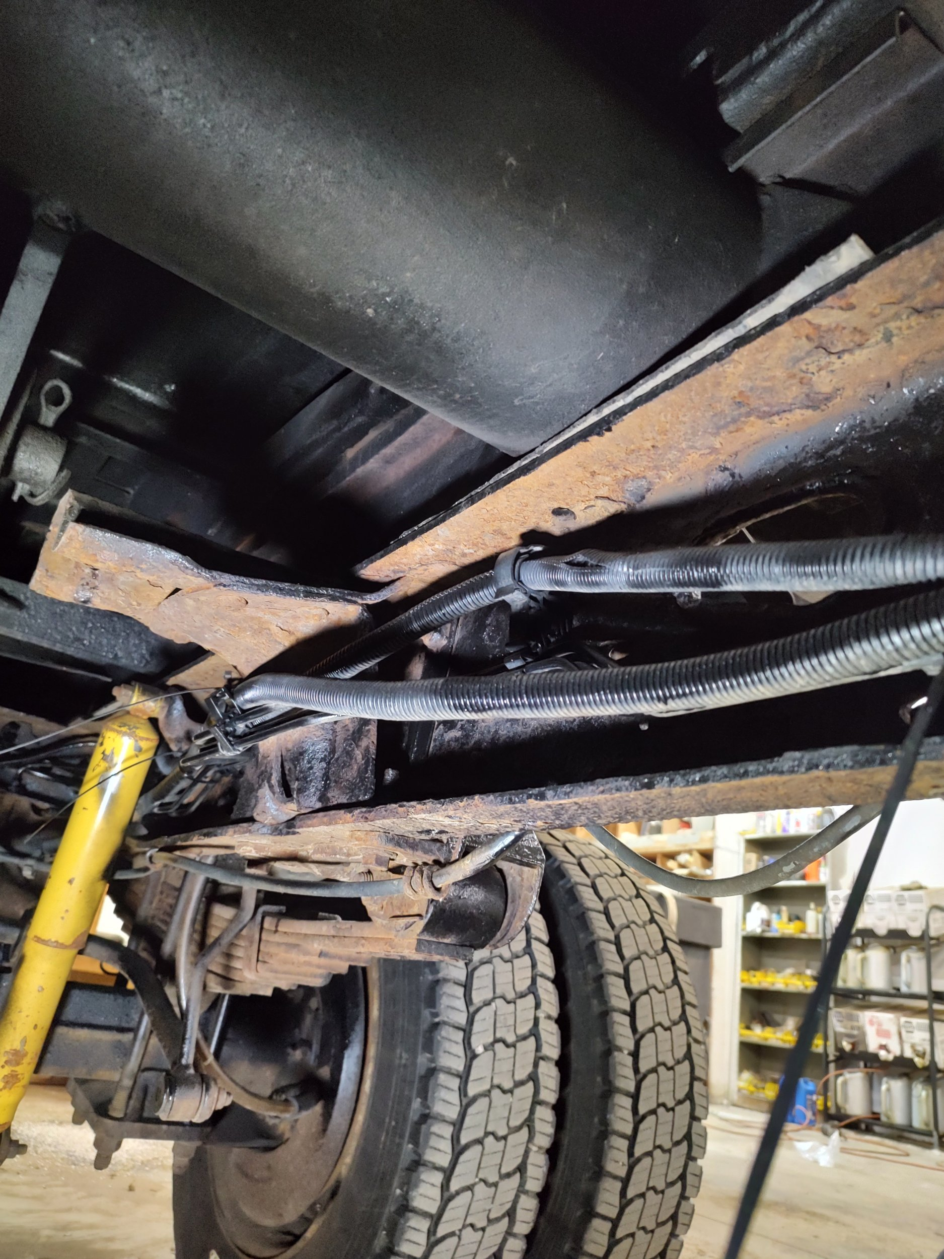

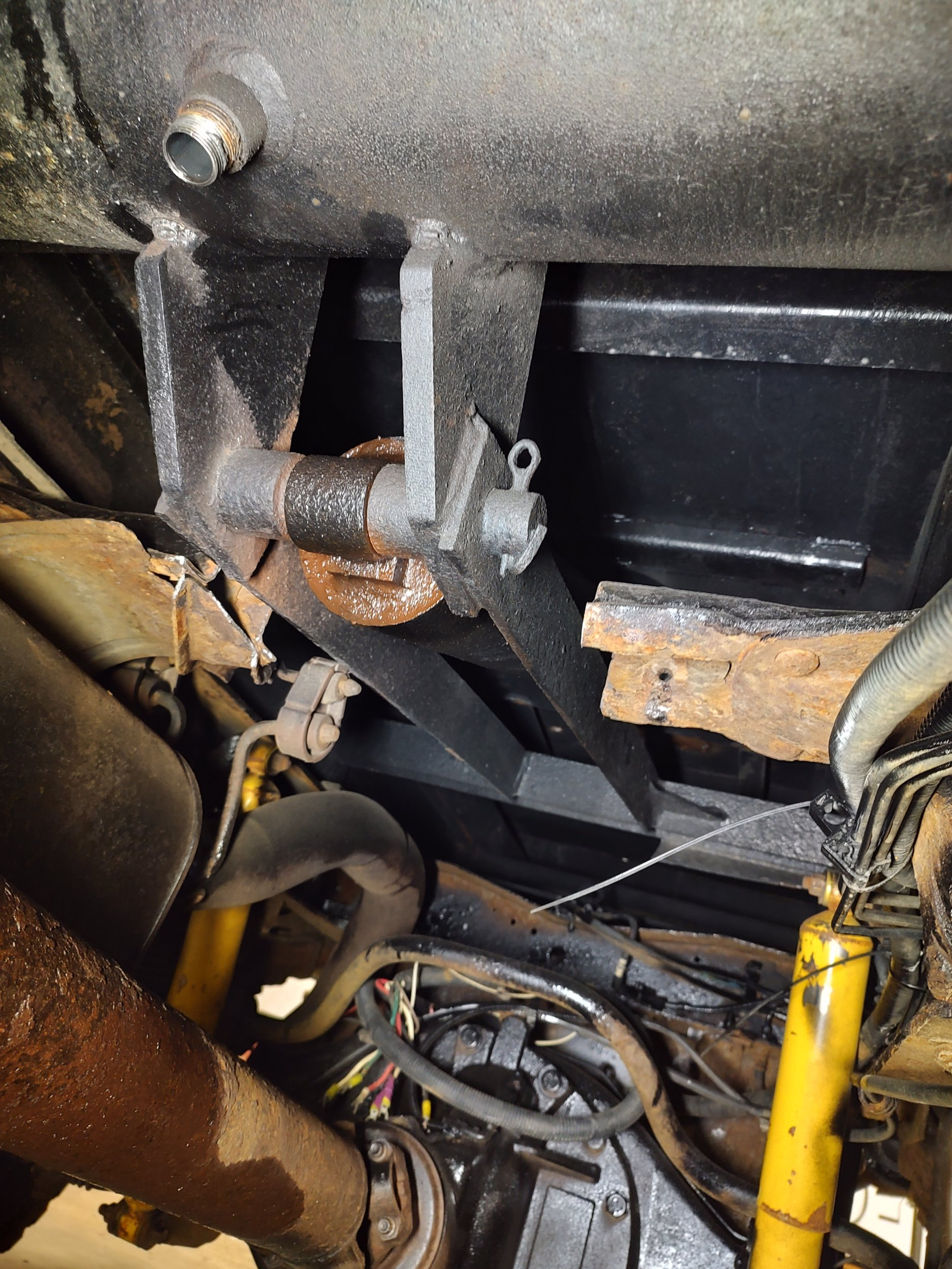

Anyway....I digressed. Rather than let me install the bed....de decided he wanted the glory of doing it himself. And in doing so....he cut out the cross member that ties the frame rails together right at the front spring perches.
This kinda irritated me that he wanted to take over the project.....but now it's at a point I don't want to touch the truck for safety/liability reasons.
See, I'm a contractor. And buddy's partner that I don't like makes that known every chance he gets. And if something happens I don't want it coming back on me for working on this truck since I'm the contracted "professional".
My gut tells me to just walk away from this project....but I thought about a waiver. Have them sign a waiver releasing me of any liability regarding this truck/frame/cross member. Because I don't know just how structurally important it is. Probably something I would do if it was a beater wood hauling truck or something.

It's a good idea to document that you felt there was a safety concern and that you notified the "jerk" of it. Much safer than just walking away and him saying you were the one that cut off the cross member.

The springs are mounted beside the frame rails. So the crossmember is there to stop the frame rails from twisting inwards. At the trailer company i worked 15 years ago, i was the first engineer that ever worked there, and they started by trial and error. A trailer with air suspension came in, of which the spring hand just ripped a bite out of the frame rail so the axle was flopping around. We gusseted and crossmembered it properly, then it was good to go.
Where did this installment happen ? Were you working in their shop, or in yours ? So were they hiring you as a self employed help, or as contractor ?

It sounds like you covered your tail the best that you can. Here, commercial vehicles are subject to roadside stops and what you describe would cause the trooper to pull it out of service immediately, costing them towing fees and lost revenue.
I could be wrong, but it seems like most dump bodies I see are set up on some type of subframe running the length of the dump. This raises it up to accomodate the piston, and distributes the weight rather than having it all on the pivot on the frame.
