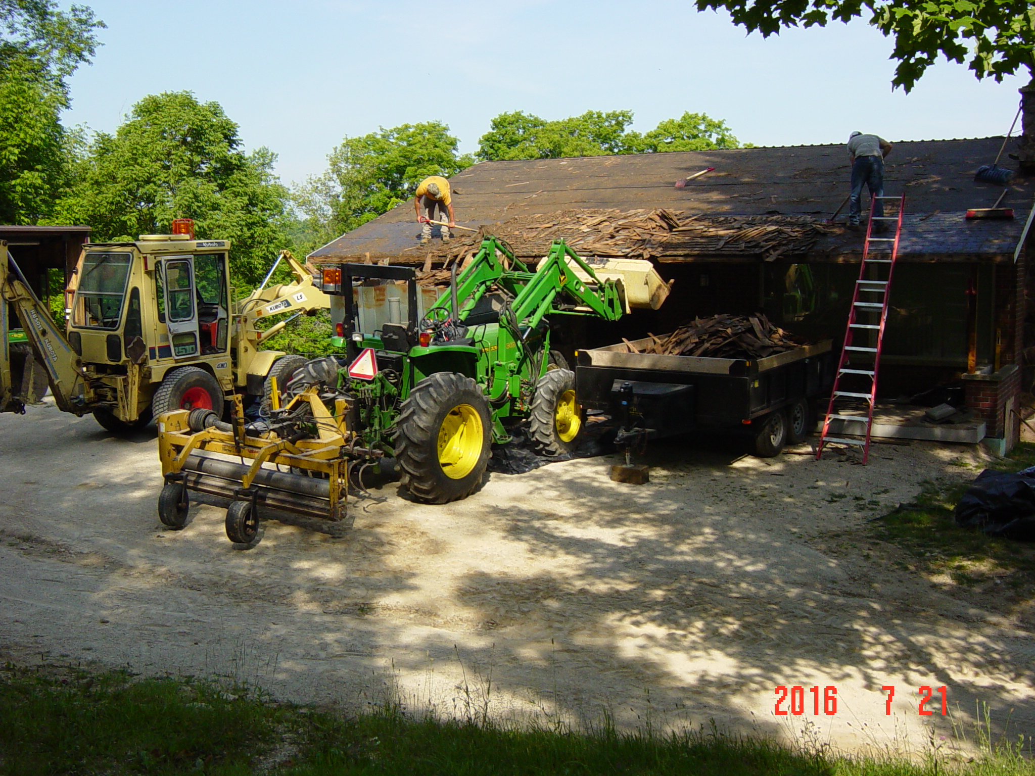

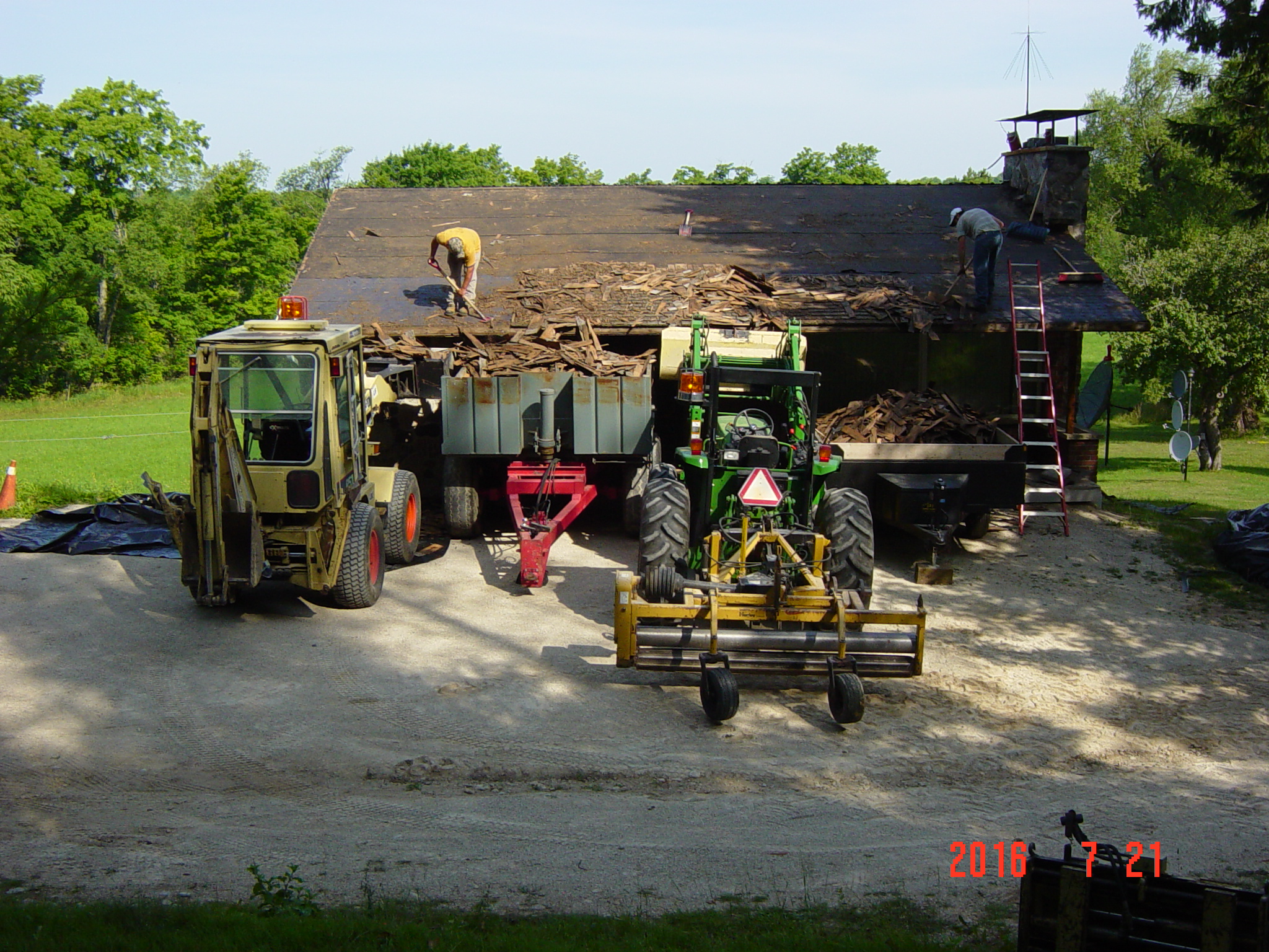

Well, it's done and mostly over with. I think, the only reason they speak of hundred year old ceder shingles, is because nobody is stupid enough to take them off. I paid, and yet helped out. Hottest days of the year.
   / Removing a Cedar Shingle Roof #18
It's a lot of work but I think I see the problem, the best roofer around these parts, would have had 8 or 10 young Mexicans on that roof. :)
#19
Actually, the one young kid who did most of the work was from South America. He acknowledged the heat but never once complained or shirked his responsibilities.
It made me once again think how hard some people work in terrible conditions, how others have it easy by comparison and then those that just let others support them entirely.
